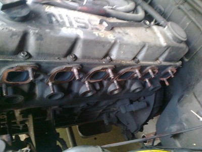

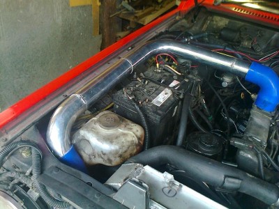

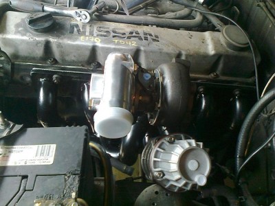

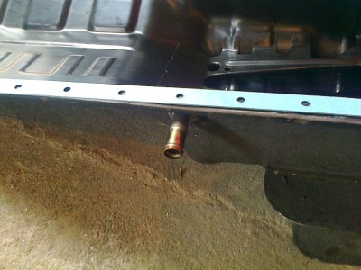

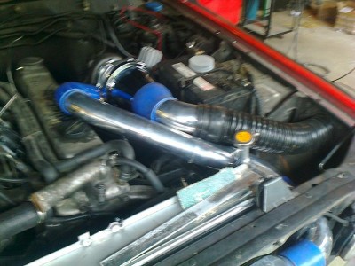

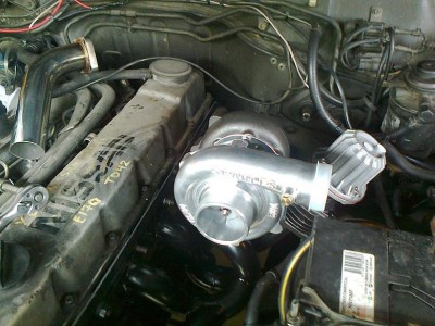

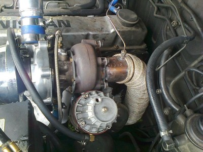

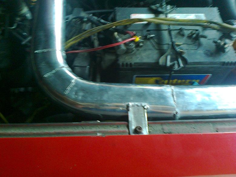

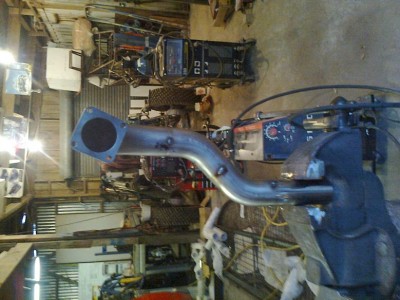

    over xmas got to work on offroader scarles TD42 turbo kit that will be for sale later on this year

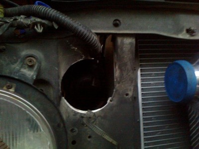

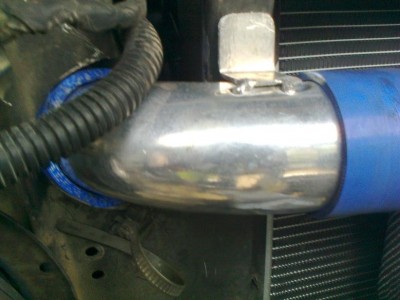

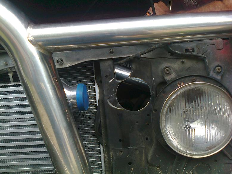

    there will be 3 kits 1 front mount I/C 2 top mount water to air I/C 3 poor mans cross over pipe all kits can be internal or external wastegate will come with a 2 inch down pipe that will bolt to fatory exaust and a 3 inch down pipe that will go just past the gear box all kits should fit with not much mods will also have an exchange sump survice 4 the oil return.forgot to tell you that will have to cut the grill and move front mount I/C if you are still running A/C will come with fittings to do this

    no borkein studs theres a trick to this done 4 now with no bokein studs

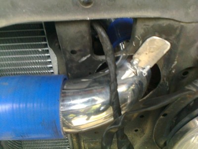

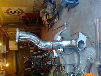

    3 inch down pipe
    3 inch down pipe
    oil return
    oil return

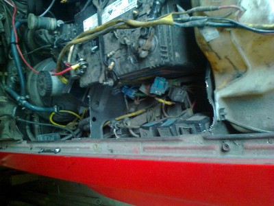

    have to cut down relay box for pipe work

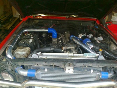

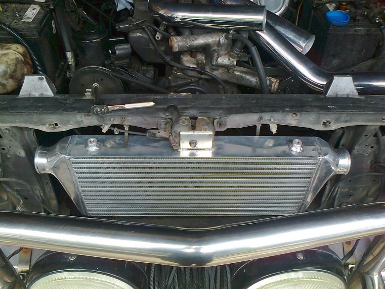

    scarles intercooler 550x230x65

    wastegate scremer
    wastegate scremer
