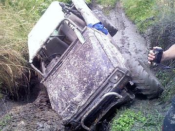

So on the weekend we took it into the bush at Woodhill to see what it could do. Was certainly much more capable than my hilux was, but I think there is definitly room for improvement. It definitly needs to be lifted a bit, as you can see in the pics, it liked to bottom out on even medium sized ruts.
What would be the best way to go about lifting it? Reset leaves? Sorry, am new to all this!
Cheers to Warren from 4wdbits who helped me get the right stuff to do all the recovery work (straps, hooks etc) and the GC who pulled me out of the really boggy shit seen below. I would have been able to get thru I'm sure but would have been a huge PITA! I am having heaps of fun learning all the little tricks etc that people use to get out of the shit!
Anywho, heres some pictures cos everyone likes pictures.
Re: Project Scumbag : Daihatsu Rugger
Ashkan wrote: It definitly needs to be lifted a bit, as you can see in the pics, it liked to bottom out on even medium sized ruts.

Ahh I see. Thanks for that mate I really appreciate it. I have had 33's on it and they made the truck gutless as hell. So I guess the best thing to do is stay out of the deep ruts?

yep and if you can figure out how to do that let the rest of us know how :roll:
I found with my rugger that due to the narrow wheel base it could do well by griping on the inside of the ruts, but to do that you need a tyre with an aggresive side grip like siverstones/simex.
try and drive with one wheel on the centre ridge.
I SOA (spring over axle) on mine. dont do it. makes it very high and tippy. it's like a 5 inch lift. and the springs still need resetting to give them some strength.
I have learnt alot since then so this is roughly what I would do If I was to do it again. have been playing extensivly with the leaves on my hilux and have realy got them working so feel I know what Im on about.
rugger transfer case hangs down a bit so a suspension lift is a good idea.
the leaves are flat weak and crap so I would look at geting a set in there with more arch. either aftermarket or yours resett. there 4 leaf try to go to 5 do get a bit more strength to resist flopping over. looking for a bout 2-3 inch lift.
your diffs are only about 7-71/2 inch so thats a clearance win provide you dont try and put to much power thru them. never broke a diff or cv with a slight turbo boost/pump upgrade. would do a diff shave to gain more clearance. not quite a job for a beginner tho.
I found on mine power wise in the knarly stuff if I could get it spinning in 2nd and rev's up she would claw its way quite well wheras in first she would run out of rev's quite quick. i was runing 31 swampers measure 32. by going to a measured 33 you wouldnt pull 2nd so easy which is a bit of a stretch any way but you would get more out of first with more usable power. if the 33 you tried was wide it would be heavy and suck power. my choice would be 35/11.5 silverstones measure a 33 on 7 inch rims. on 33 with diff shave you would have more diff clearance than most. guard trim if thats what it took to make them fit. do away with sway bars and fit good shocks. maybe a shackel lengthen if you want more height. helps with down travel. tho I would be trying to keep the truck as low as I can. guard triming is the way to get the bigger tyres on. pretty mild mods really but will make a huge difference. there a strong engine so a bit more boost for more power. diff shave would be awesome for your clearance but a bit costly when paying someone else.

Ok couple of correction points here. looking at pics reminds me that the front spring shackle is at the front of spring (correct ?) so dont lengthen it as it will reduce your approach angle.
also if this is your only vehicle daily driver then going to 33 tyre will cost power too much for that so staying smaller may be more important. in which case diff shave is the only way to get more diff clearance. how ever upping engine power will make it easier to fit the bigger tyre. remember what manufacturer states on side of tyre means nothing. measure them

Thanks for that Clive, very good read. Sorry should have been a bit less vague. This is not my daily, I have a work car which is awesome even though it is a boring pos. in saying that I do drive it when I want to feel a bit more masculin ( oxymoron in a daihstsu surely). I also use it to tow my race car once a month all over the north island.
The 33s I used were a 33 12.5 15 kumho something. They made the truck über sluggish even on the road.
I don't think I would get into diff shaving etc as I don't have the time.
