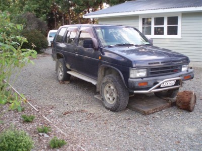

Just for the record, here she is on a wintery south coast trip, Before my dance with the bank and wire fence.......

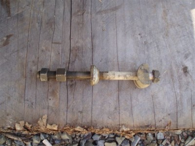

OK, so I’ve finally got around to doing the torsion bar adjustment a couple of weeks ago. Looks much better now. Was fairly straight forward and no real problems encountered.
Here is the procedure: (You can perform these steps to each side as you go or repeat once one side is completed)
1. Jack up the front to get both front wheels off the ground. This releases the tension on the torsion bars.
2. Give the threads on the torsion bar adjusters and the spline a squirt with CRC or WD40 just to free them up a bit.
3. Put a mark on the adjuster and torsion bar so you know what spline they were originally lined up to. I find giving it a scratch with something sharp and then putting a bit of white paint into the scratch works well.
Torsion marking
Torsion marking
4. Next undo the top nut completely off the thread. Then start unwinding the main nut, all the way off the thread. Pull out the adjuster thread/bolt.
Torsion adjuster bolt
5. Now you will need to remove the C-Clip, washer from the adjuster. If you don’t have some C-Clip spreaders I found a couple of decent sized screwdrivers did the job. One to hold the C-Clip from sliding around, and the other to gently tap the other side of the C-Clip so it pops off the adjuster.
6. Next you will need to give the adjuster a good tap so it slides off the torsion bar spline. You will find that the back of the adjuster has a grove in it which stops it from sliding back as the cross-member locates into this. So you will need to pull the torsion bar down a bit. My torsion bars were original so needed a bit more force to get the adjuster off. I found a smack with a good sized pin punch on the adjuster near the spline did the trick. The adjuster will slide right off and you can pull it right out of the cross-member.
7. Next give all the areas a good clean and grease. I put a thin smear of grease around the spline and seating point for the half moon washer.
8. Now slide the adjuster back onto the spline at 2 or 3 spline positions from where it originally was (note white mark positions). When you put the adjuster threaded rod back into position you just need to make sure you have enough thread showing at the top so you can get the nut back on. If your torsion bars are old and original you will find that they have stretched a fair bit / increased in elasticity. So from no tension to tensioned (at desired height) you may find that you have the adjust nearly the full length of the thread.
9. Put the C-Clip back into position.
10. Put the adjuster bolt back into position and start screwing the main nut back on. You will find this nut needs to be wound a fair way until there is some real tension.
Adjustment
Adjustment
11. Lower the front of the truck back down and measure from the top of each rim to bottom of the guard to get the heights equal on both sides. When adjusting each side, make sure you jack the front wheels off the ground.
12. Take the truck for a spin over some rough ground to settle the bars in and the measure and readjust if required.
After torsion adjustment
Happy trails....

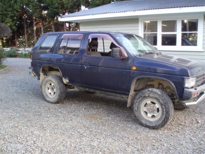

OK, the body lift is now pretty much done. Thanks to Simon and TAZ for your help. Still have the two rear bolts to sort out, bumpers to adjust, handbrake cable to adjust and drive shaft loop mounts to extend.
Actually doing the body lift was fairly easy. The hardest part was taking those side steps off and having to remove the seats and lift carpet to get to the bloody bolts.
Here are some pics:

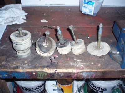

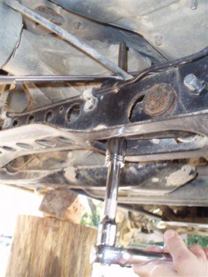

Before body lift
Before body lift

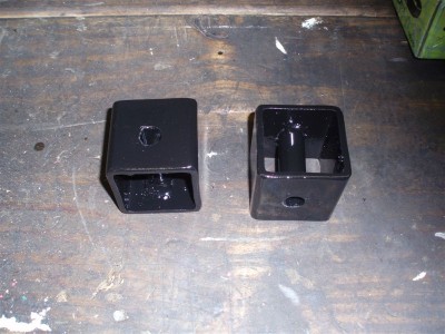

Lift blocks, thanks TAZ and Wellington Towbars
Existing body mounts removed from one side
Triming of the 4WD selector
Job done
Job done
So what did I do to get the job done.......
1) Remove botom section of radiator cowling. This will allow the radiator to move up with the body while the fan stays in the same position.
2) Remove driveshaft loop. This will stop you lifting because it is bolted to the body and loop runs through the center cross-member.
3) Remove front bumper, as the slots in the body where the bumber mounts pass through are not long enough and will stop you lifting the body.
4) Unbolt and remove all 5 mounts on one side.
5) Unbolt and remove the front and rear bolts on the other side.
6) Jack up 1st side and insert lift blocks and bolt loosely into place.
NOTE: 150mm bolt for rear is just enough.
7) Do the same for the other side. and tighten all round.
Once done....
Check the petrol filler pipe has shifted OK with the lift.
Extend/adjust the handbrake cable
You will need to cut and remount the bumpers if you want them to sit in their original positions.

by fullthrottle
Ok. Resolved the bolt issue. A 150mm M12 bolt in the rear will work, but only just.
I have also cranked down the torsion bars to about a 10-15mm gap from the bumpstop. Installed some new shocks all round with help from my main man at Wheel Crazy and she rides really sweet now.

Posted: Sat May 12, 2012 9:44 pm
by fullthrottle
OK, over the past couple of days I've stripped down the rims I've had for about 2 years, painted them up black. Adjusted the front bumper mounts, and today collected the new rubber.
Maxxis Bighorn MT762 32 x 11.5 x 15 for the best price I could find of $299 each.
Took her out for a spin today and holly cow, she is completely different. Rides nice and firm with the shocks, suspension and bigger rubber. Careful on the corners, she likes to try taking you for a spin.
Those 32's with a -12.5 offset rim are a perfect fit under the guards. Can't go any bigger with those rims without hacking the body up. Just have to remove the flaps and trim as they do nothing for the tyres now anyway.

fullthrottle wrote:So what did I do to get the job done.......
5) Loosen all the bolts on the other side so the body will pivot on them when the opposite side is raised.
Once done....
Trim the bottom rubber boot plate of the 4WD selector.
Add blocks to the driveshaft loop mounts and refit.
Made a small adjustment to #5 for you :wink:

fullthrottle wrote:OK, so I’ve finally got around to doing the torsion bar adjustment a couple of weeks ago. Looks much better now. Was fairly straight forward and no real problems encountered.
3. Put a mark on the adjuster and torsion bar so you know what spline they were originally lined up to. I find giving it a scratch with something sharp and then putting a bit of white paint into the scratch works well. ETC....
What I've found is it's easier to do it on the front of the bar....after you've backed the adjusters right off, undo the 3 bolts that hold it to the lower arm, and slide it back down the bar, turn it however many splines ya want, then bolt it back on.
Nice job though, she looks good.
