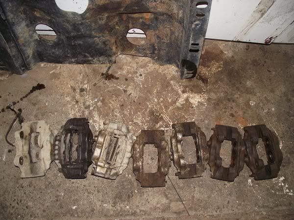

Im looking for some later model hilux surf calipers .
for a 95 KZN-130 surf with the thicker 25mm vented rotors.
normal surf uses a 22mm rotor.
anyone have any lying about the place that they want to sell???!
I just had an exorbident quote to have mine rebuilt and would prefer not to pull my hubs apart agian to fit smaller rotors and calipers .

I put a kit in mine a while ago ...was about $60 for kit to do 2..was an easy job

rebuilding them is easy , the issue is that 4 of the 8 cups were stuck solid and need to be replaced / re-sleeved .
$60 for 8 cup seals and 8 cup boots/ clips is a good price. where was that from?
Re: WTB: Hilux Surf Calipers.
yeah I've just been down the same road I couldnt make a good set out of all my bits so I brought a second hand set of callipers with near new pads and no seized pistons for 80 bucks :D

Was from BnT ..they are good people to deal with
