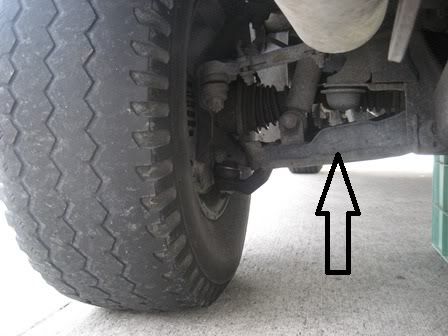

At factory height the bottom arms are roughly parallel to the ground ...if they arent chances are its already been tweeked.

Re: Adjustable panhard rod & torsion bars
[quote="tallsam66"]At factory height the bottom arms are roughly parallel to the ground ...if they arent chances are its already been tweeked.
"bottom arms"??? got a any pics what I'm looking for?
is this it?
yep thats it ...id say its been adjusted already.
