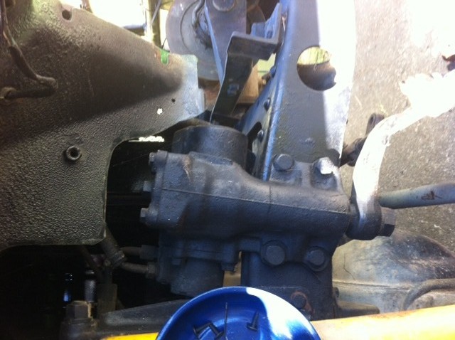

So the box sits inside the chassis at the front? A old friend of mine said that i might be able to use a chev steering box and it will mount on the outside of the chassis so i can still run a full width drum on my pto winch. Could prove to be expensive. I think i will be building a new cage before i get powersteering

Can't picture it in my head right now, but I am replacing the shackle bushes so I will take some pics tomorrow.
I have a PTO winch also - not sure of the drum width.
Had to rotate it to make it fit - either turn your head or save it and rotate it. :lol:
Hope this helps? let me know if you want more pics. Been busy trying fix up the previous owners gash suspension mods.
Re: restart in wgtn
tow99 wrote:So the box sits inside the chassis at the front? A old friend of mine said that i might be able to use a chev steering box and it will mount on the outside of the chassis so i can still run a full width drum on my pto winch. Could prove to be expensive. I think i will be building a new cage before i get powersteering
the cruiser boxes mount on the outside of the chassis not the inside, 60 or 70 series boxes are easy conversions onto 40 series cruisers. I've got a chev saginaw box here that I pulled off my cruiser but it didnt make a very good conversion the way it was setup

Thanks for the info guys helping heaps just trying to get a list of parts together while im cutting and welding the body.what shaft is the best to use? Same one as the box and get the 40 coloum shaft splined to match?
Re: restart in wgtn
I've only ever done a 70 series box conversion. Splined the steering collum (left it as long as possible) and joined onto the 70 series collapsable shaft with a toyota starlet 14mm to 14mm steering UJ, 60 series stuff would probably work out pretty simular and be the right length collapsable shaft?
