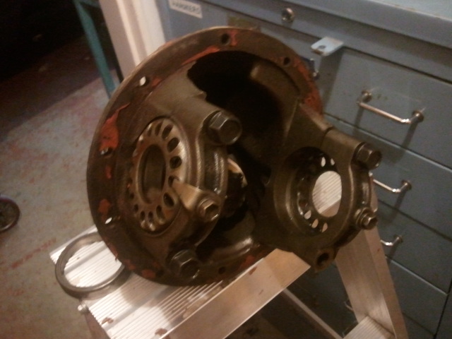

nstacey
Posts: 542
Location: Tawa, Wellington
Re: Toyota Hilux 8" broken diff heads wanted.
Post by nstacey »
churchill wrote:
nstacey wrote:I've got a dismantled diff head that the crown wheel buggered out on. It was a 4.5 open diff in a 85 hilux can measure the bearing size if need be. If it will suit what you're after, I can bring it up next weekend. Price would be a dozen Macs gold
Nick
Sweet, pm sent.
Pic attached as dug out of my spare parts box. I couldn't find the 4th bolt that holds the carrier in place. Pm reply sent
85 Hilux single cab
02 Grand Vitara
