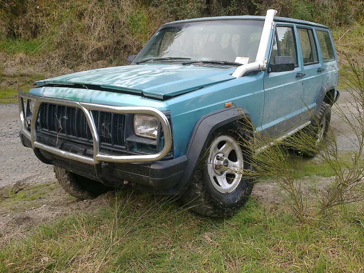

after a long run with my vitara and a swb bighorn ive seen the light and got a jeep, picked it up today, is a 96 cherokee sport.standard apart from extractors and exhaust, put some 1/3 worn 31s on and took the sway bar off, will try it like that this weekend and go from there.

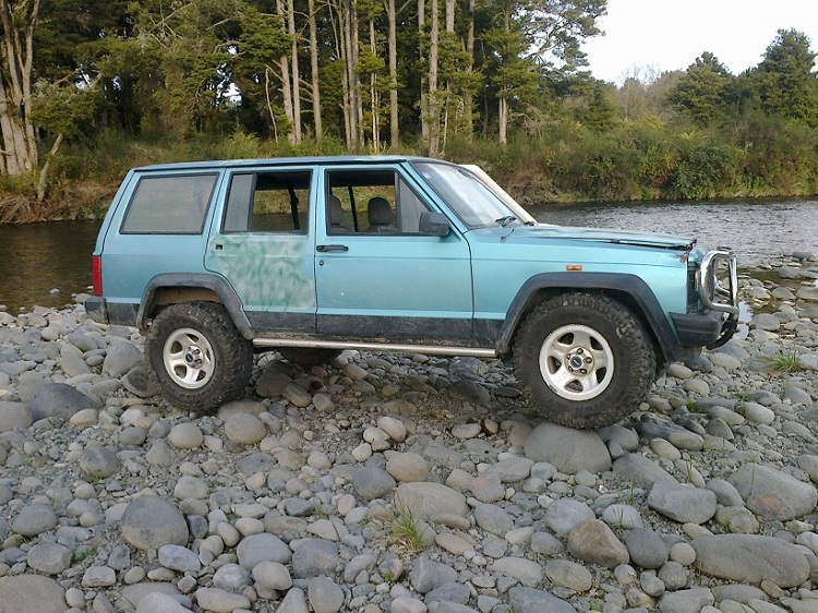

mine is not road legal so its mods will be purely to get abit better off road,cracked screen and a missing door handle and the last owners let it die in the rego,only had it for a day and already like its low down grunt and instant throttle response,all my 4wding is within 1-10ks from home so fuel use shouldnt be too bad, seems to idle around pretty good,first thing to do will be trim the guaurds and probaly lock the rear diff, already has onboard air,bars on the sills and a extra skid plate under the trans, so far a good jeep for under a grand and now i have 2 mopars.now that we are getting the first bit of rain for a month i will have some mud to go play in and next weekend take some marshalls into the 42 traverse for the t42 endurance race( mountain bikes and runners ).hopefully some pics and video after the weekend, mrspankynz1 on you tube,

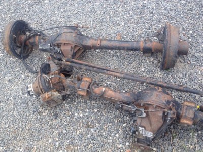

Now had the jeep for some time and now my next step is change the axles, still havnt broken a diff but only running 31s or 33s. Got a pair of 60series landcruiser axles both with factory diff locks,4.1 ratio,will need to swap diff head across on the front axle but then I have decent axles that should last and let me go to 35s,apart from the cps shitting out it has been sweet. Put a bigger trans cooler on and a bonnet vent with a fan and it doesn't get hot .cut the tailgate so only the window lifts .

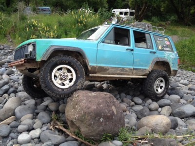

Down the river

1996 was the year they switched over to the much better 5-297 U-joints and one piece axleshaft.
Direct swap into previous years Cherokee and would make a good strength upgrade for someone when you do the Toyota axle swap.
