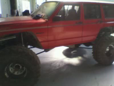

yeti wrote:can always throw some darkside shit under it...![]()
that looks like the hit
