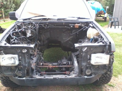

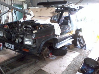

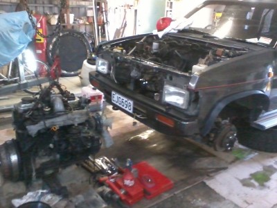

Hey guys,
I am currently in the process of fitting a rb25det into a nissan terrano using the standard automatic transmission from the Td27 engine.
I will update this is a log for anyone that may be interested, will list problems/findings as i go.

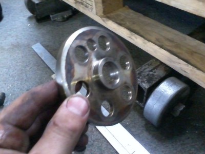

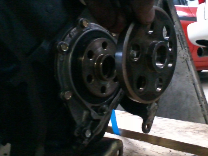

First problem i have found is the crank end on the RB is different from my Td27, the flexiplate will need to be drilled to suit my Td27 torque converter (TC) . A spacing collor needs to be machined to space TC and since this Rb engine was a manual, i need to remove the manual spigot bush and machine a longer bush that will center TC.

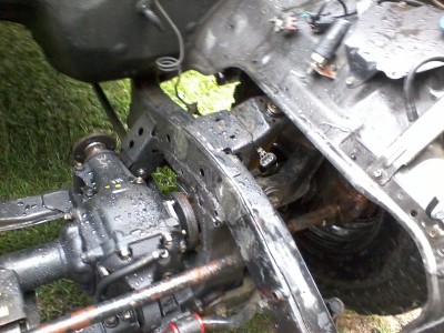

Crash bandicoot, thank you for that information i had thought about that, turns out i only got a hour to spend on the truck tonight and here is todays findings.
After research on the guy that installed a rb20 in a D21 he had mentioned that the gearbox was lifter 1 inch, i did not understand why until now.
The center of the crank and the main flat part of sump is much longer on the RB compared to the TD, therefore the truck needs to have a bodylift (not suspension lift) installed to allow the gearbox to be rised 1 inch. This will allow the main flat part of the RB sump to stay the same (only need to modify the belly), and in relation to your comment Crash bandicoot, this also allow me to mount the radiator higher, hopefully eliminating that problem.

chop the tunnel and raise it where it needs to be raised...any questions you tell the wof guy you had rust issues.
also you will need to bolt a plate or stay to the crossmember under the engine as a fale safe to stop the sump jamming up your steering if an engine mount fails.(i had to do this) so the engine drops on the stay first and not your steering system.
If i can get an Rb30de and a 1993 nissan skyline 5 spped box into a poxy little 1985 hilux the terrano wont be an issue....just think it through first.
I did mine when i was 18 with minimal mechanical expierence. I hadn;t even changed a cambelt let alone take on a full engine and driveline swap between two different brands.
Just remember the RB engines dont sit striaght up and down, the lean over and are designed like that. the oil filler cap is a good indication, when that is screwed on and level its about right

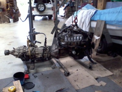

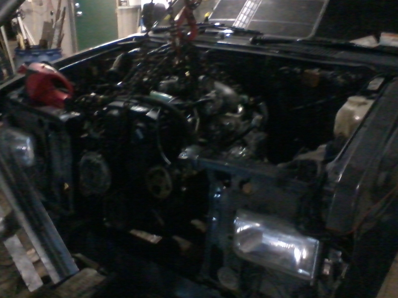

Well due to work commitments, work on the truck has been slow, i did manage to spend a few hours on it today though, i cut the old engine mounts out and test fitted the rb engine in (my old man mentioned he used to think v8's in fiats where tight).
Things i have found is the gearbox needs to be risen approx 20mm and positioned closer to level to eliminate the engine tilting back (truck body lift needed) this will allow the the engine to be positioned futher back due to it not tilting backwards. After some rough calculation it would appear the whole drive train is going to end up around 25mm back (this will give 5mm clearance firewall and engine). That will allow enough room up front to mount radiator and fingers crossed some sort of fan system.
