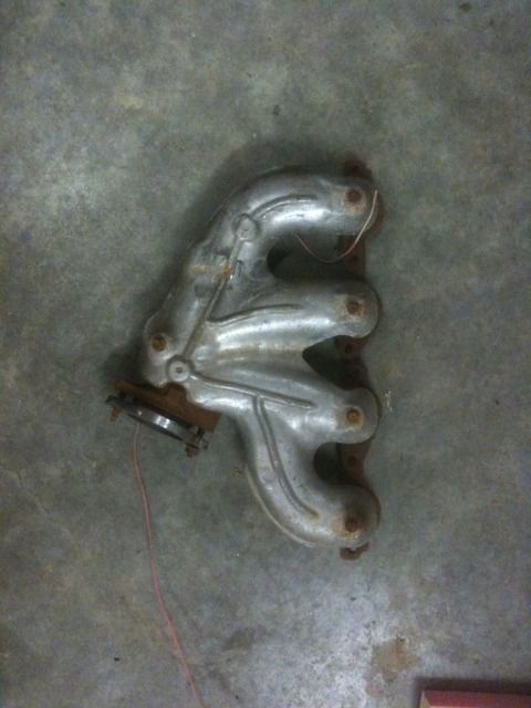

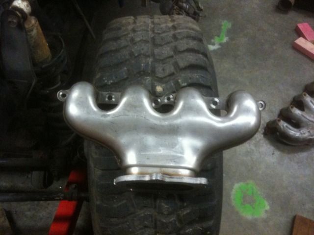

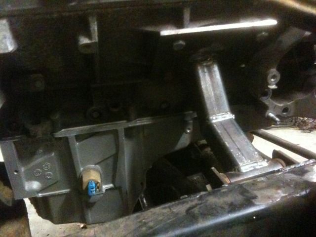

for all you picture whores here are a few quick ones from my iphone tonight after i tacked in the engine mounts Image Image Image Image Image Image
