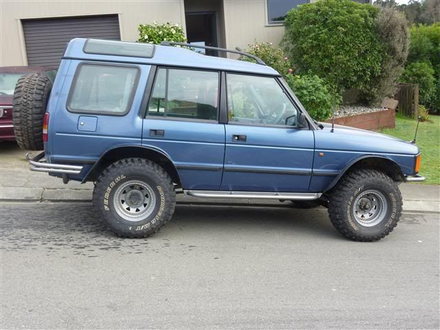

running 33" 12.5 x 15 no body lift, about a 1-2" spring lift, front guard cut, rear guard and door cut, slight rub on full artculation and some steering lock, but ok other wise. but tthen agian i do have 80 series axles under it, which are a bit wider.......

took the doors as high as possible, trimmed the inner guard so it was a minimal fold, so about 50mm, packed the doors with epoxy to hold then together. 33x12.5 x 15 federal courgias, as for actual size pass never bothered to check. where abouts are u?

nice truck too by the way
6 stud is that a dif conversion

yeah 80 series landcruiser diffs

did the bars myself, and no to air bags,its a '94 disco so pre all the electronic issues
