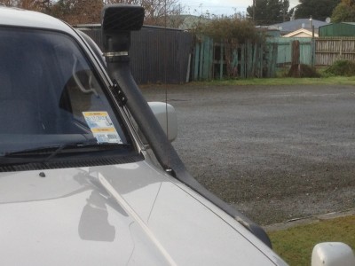

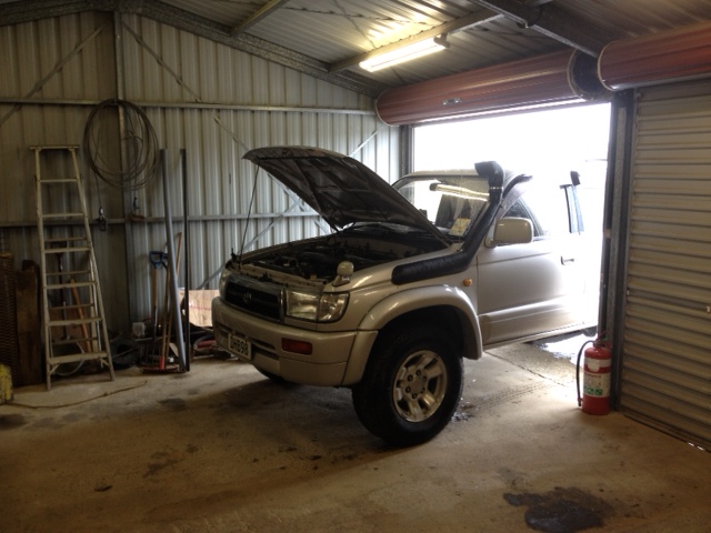

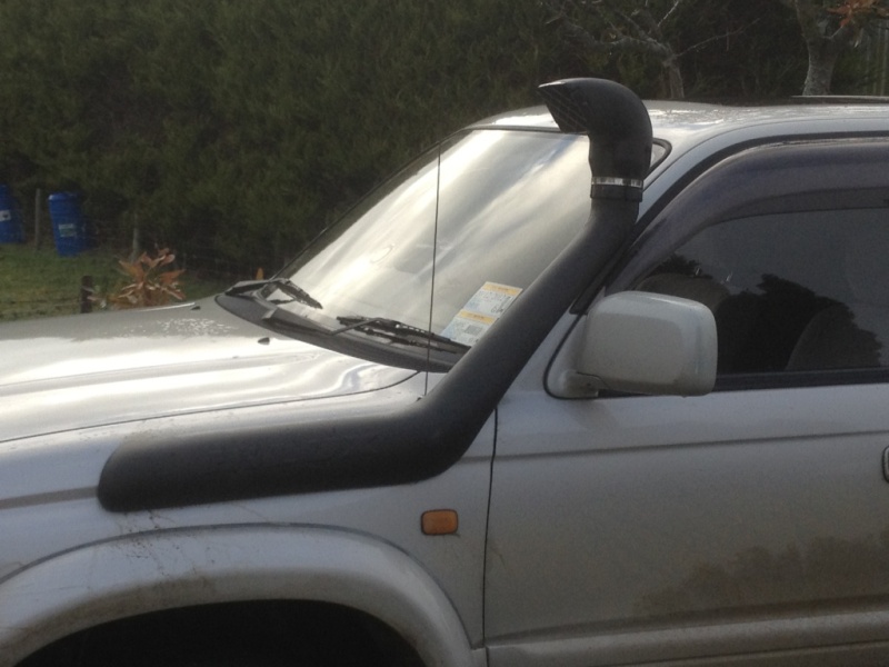

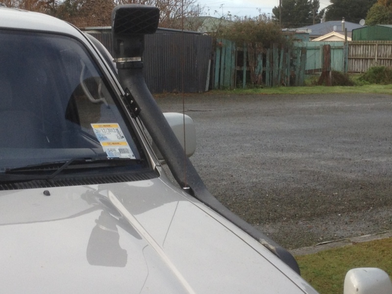

Well I got my snorkel today, not really happy with it but I guess the writing was on the wall. I got it off trade me for $190 + P&p. I didnt have an issue with buying one off trademe as the one I bought for the Prado (90 series) was a direct copy of the safari one. Anyway the one I got for my Surf was ment for a 97 Hilux, the dude said that it was the one for the 185 surf so I went and got it. Opened the box and first thing i notice is the outlet pipe that ends up in the guard is bloody small. It was moulded over and was not that cool. I cut the last 5mm off to help it out but its still not great. Anyway I thought just put it on. The template is miles away from the the snorkel so it didnt provide much help. After drilling holes bigger than need be and finally getting it close it becomes obvious that it is clearly not made to fit my truck. The angle is a mile out and there is a massive gap between the A pillar and the snorkel. Anyway thats my rant, Ill get some picks up ASAP.
Lesson here is buy the right product for the job! Sounds simple huh.
On a positive note Ill be getting stuck into the chassis with the grinder tomorrow.
P.S. Picks added
P.S. Picks added

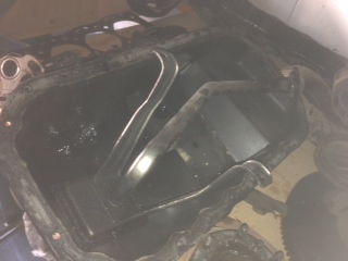

Not much progress today, went to get the sump and there was a bit of confusion about the pickup. Ill put a photo up and see if anybody recognises it as a kzn130 style pickup.
Also got onto 4wdbits and got a mean deal on some 33x10.5R15 BFG's.
Anyway see what ya think about the sump and pickup. Sorry the quality was soo sh*t as it was dark and I used my phone.

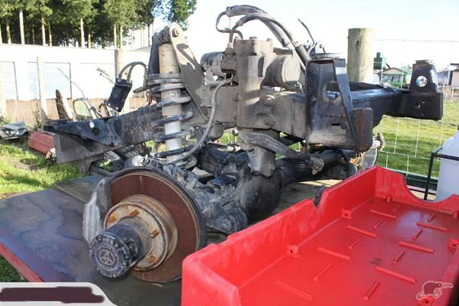

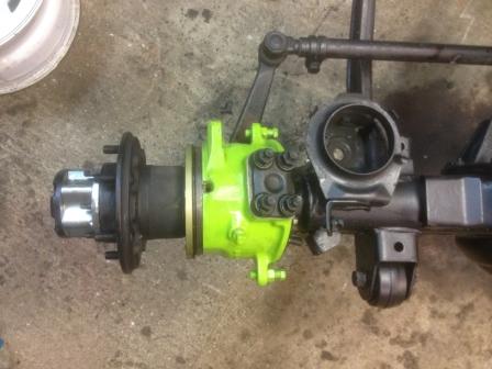

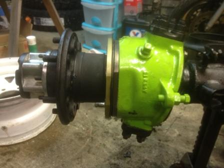

Here is a few picks of the surf hub on the Prado diff. You can see how much wider they really are. Not too sure why I picked green for the knuckles but its not hard to flick some black over it if it looks funny on the truck.
Should get the rear springs tonight and as soon as the bar turns up Ill rip into the front diff. I am able to borrow a mates wide axle spacers untill mine are made but will still need the bar to get the axle position right. I want to push it forward as much as possible.

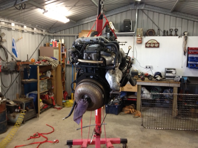

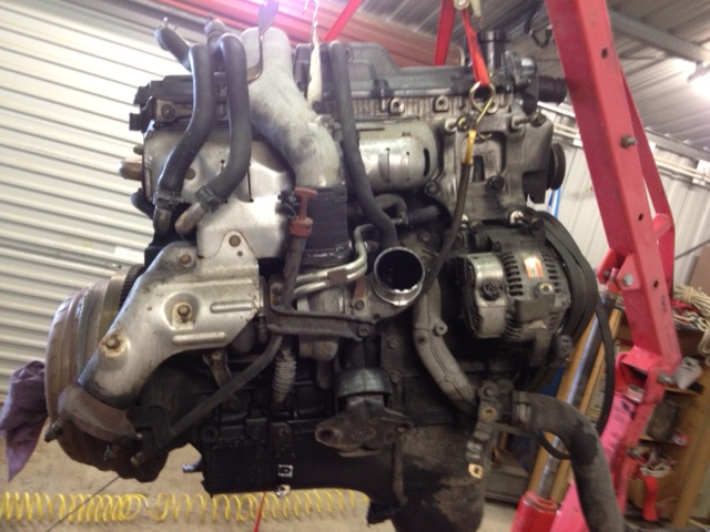

Well its finally time to say "Its all on!". Took the motor out today and will be getting the grinder out tomorrow!

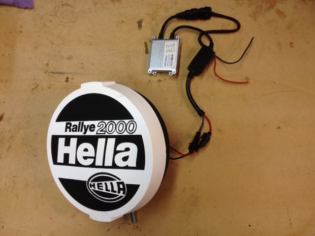

Here are some picks of the spot lights Ive set aside with the HID kit fitted and some of the motor out etc.

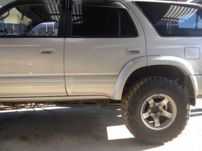

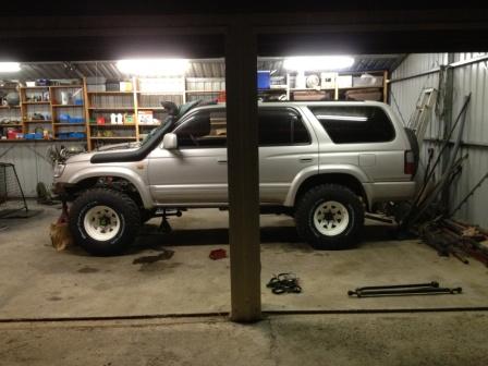

Some might say instant delivery? Took me a while to figure out who it was, got the front diff and tires there today. How ya trip go?
Re: The Surf Toyota Should Have Made
All good ah, awesome views. Tyres look good on the back, good incentive to get the front diff in to see how it will look.

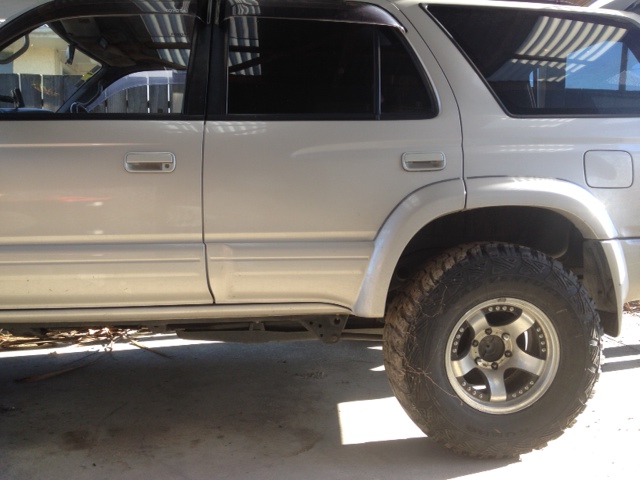

Yeah rear offset is pretty close. Lift springs tomorrow then grinder on tues maybe. Will try get some picks up soon.

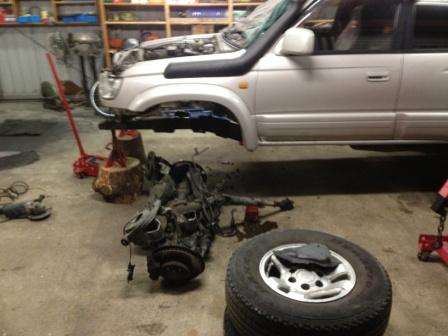

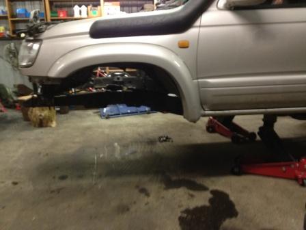

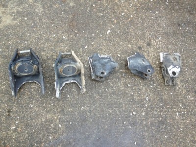

Done a little bit of work last night, got the rear springs fitted (Thanks to Jared, he got a little bored and had the job half done by the time I got there) . They only lifted the rear 35 - 40mm. Would have liked 50ish but I can live with that.

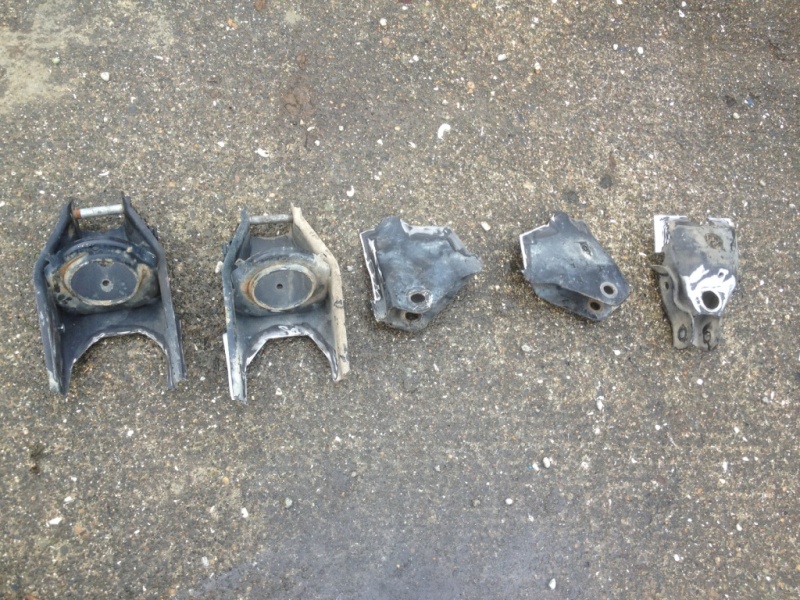

Then I started to look at how the front end was attached, there were 3 main supports each side. Little hard to get to but once the struts were out of the way its all pretty good. Anyway the front end is out and just have to clean up the rails now.
Ill let the pics tell the rest.
