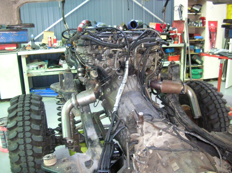

i have a Nissan Safari LWB
This has been cut down to a ute (By previous owner)
Then i shortened its chassis
Fitted triangulated 4 link in rear
Fitted 5 link in front with panhard rod
Slipped the VG30DETT motor an Safari auto.
The motor is twin turbo an twin water to air intercooled.
Have hydraulic superwinch to go in. hopping to run pump off crank pulley.
Have spent many hours on it an many more to come.
will try to keep update as i go.

Interesting choice of vg30dett. Fit in easy enough?

Nice fab work on the the chassis link mounts.

got ta love the wiring side.got to get the safari loom to talk to the 300zx motor an then to the v6 terrano auto ecu.
Re: Nissan Safari LWB shortened an VG30DETT fitted.
unsure on how much cooling will be needed so mounted 2 radiators back to back. didn't want to loose vision with taller radiators.need to look for a inline water pump now.

Haha talked to a chap the other day who's a wiz on these motors an was quietly surprised to here what power can be reliably extracted form these motors. who knows tho. i have allowed enough room for a v8.

time to remove body an bar work to run an secure the fuel lines,trans lines,and brake lines every 300mm for cert. also to get an un welded mounts an an bars from the top.
little bit of exhaust work an heat shielding. Cert mans coming today so will get him to check progress an make sure we keep them happy.
