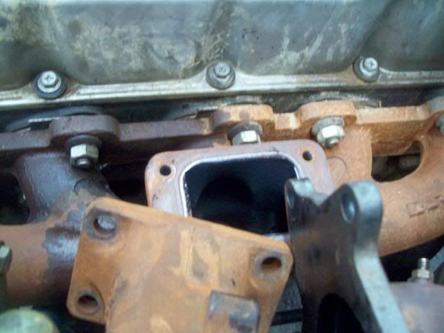

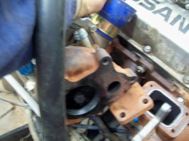

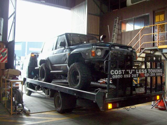

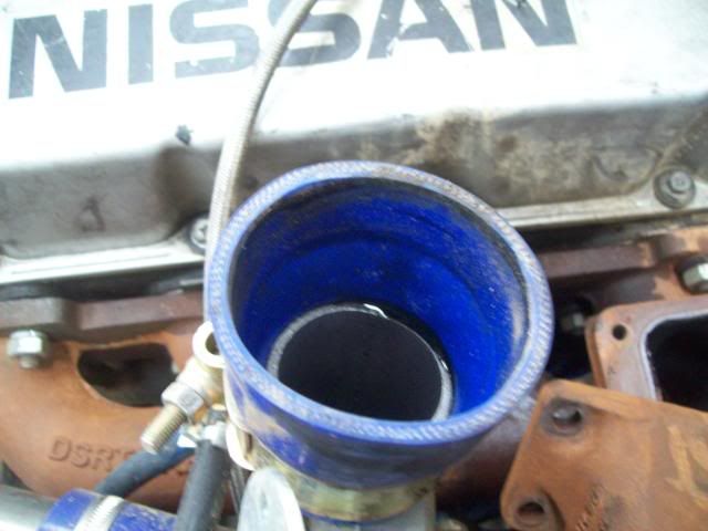

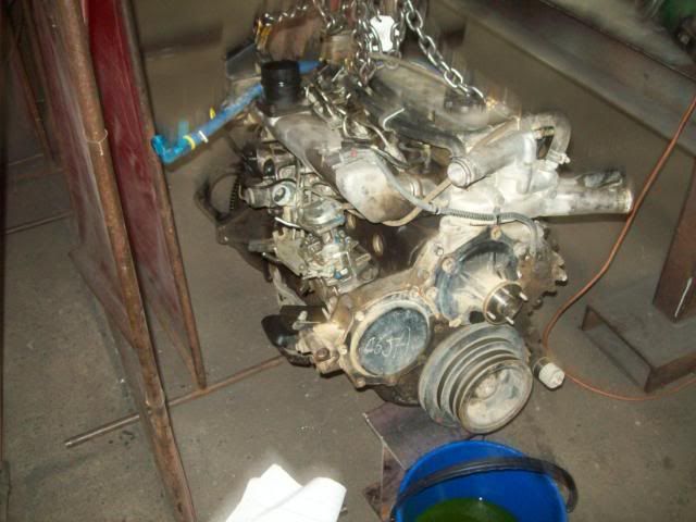

pulled engine today
dry in exhaust manifold
trace of oil in intake tube
oil in out let of turbo sent a message to dsr
stadia mud

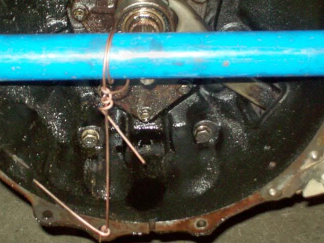

rear engine seal gone
on flatdeck to being it home
Re: engine parts for TD 4.2
DSR and i chating
23 June
Peter Cox
hi peter cox here seem that the seals in my turbo have gone, pushing oil out the exhuast
7 hours ago
DSRTurbo NZ Ltd
I see. You should use an restrictor in the turbo oil feed hole to reduce oil pressure. Rear seal may have now worn
7 minutes ago
Peter Cox
arh you got back to me, to go through this.
brought in march not started fitting till june, 3 months later all up and running,
now you tell me, i need to restrict oil,
its now with a turbo guy here in auckland
plan one rebuild it
2 fit new turbines machine housing
3 dump it bin buy new one
happy no, as telling everyone the thing was good more fool me huh

So you pulled the whole motor out just to find out it was the turbo seals? Guttered! Didnt someone mention that to you in another thread before you pulled the motor?
this thread, he can find it, if he wants
pulling engine, well lowish compression and slight big end knock ,
was going to pull it anyway,
who says machanics are right,
the guys who did my clutch didn't belive the rear seal they replaced was leaking again :shock:
as with all butt protecting self serveing people you deal with,
we will rebuild it better

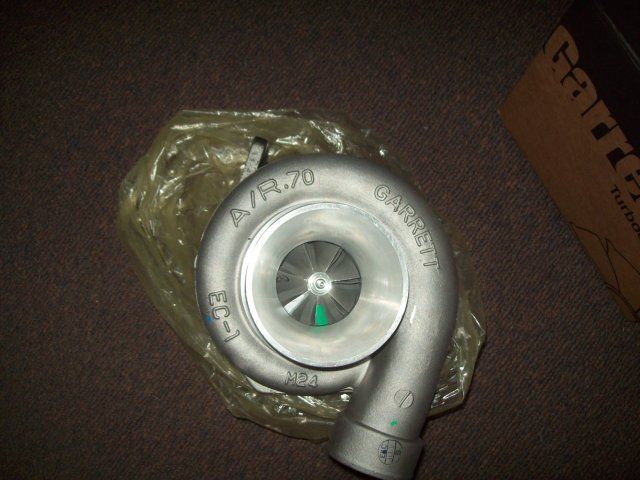

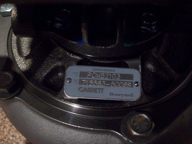

Picked up a Garret turbo tonight to replace the other :D
crazyclark31
Posts: 867
Location: invercargill.
Post by crazyclark31 »
what size?

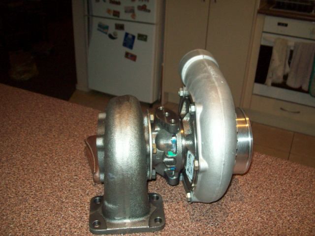

don't have a number heres what it looks like

i like how you rested it on the now empty wallet???
i will never buy a dsr again, it gave me nothing but grief after about 3 runs it had to be rebuilt using garret stuff, all they same troubles as you coxy...i just dont talk about it now.
why oh why does you only get what you pay for never sink in!!

your dining table looks the same as ours prior to a trip to the recycling bins :lol:

crazyclark31
Posts: 867
Don't want to be a killjoy but you might want to get it checked for size. Most of the guys on the aussie sites are saying even with pump mods you should only be running the gt 2864 or the gt2868 or you get to much lag.
Is a real nice looking turbo tho
I didn't go hunting for this turbo, used errols diesels and turbo's in manukau, Father and son team, south african guys know their stuff , they got it in for me, they know my truck and had that DSR peice as well, they did my pump mods and rebuilt my injectors
