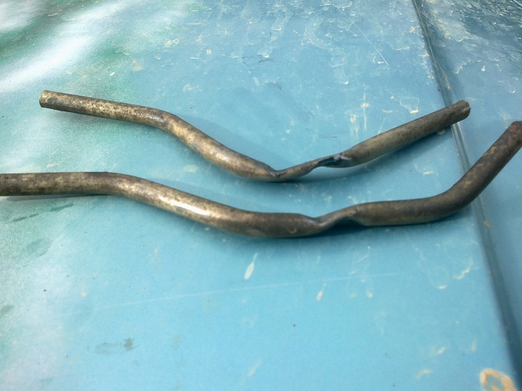

Post by spanky »
had my jeep at work making my shackles and noticed a bit of fluid on the auto pipes, when i had a look i found that the top arm on the diff had crushed the pipes.not sure if i done it or the previous owner had.i guess the auto has had no external cooling for a while ,still seems sweet though.might be worth checking if you have a xj.

lucky mate...heat kills them autos..shit so does water..been through two on the old xj...put a bigger trans cooler on the old girl.. :wink:

ive already put a bigger cooler on, probaly had no oil going to it though :lol: ,glad i didnt wreck it.
