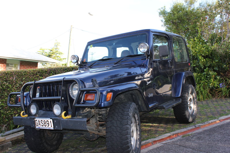

Thought i'd start a thread about the mods i'm doing to the Jeep. They aren't going to be hardcore, just minor mods when I have the money etc. Thought i'd keep it in one place. Still my daily driver into the city each day.
This is when i first got it:
5 speed manual
4" black diamond lift
33x12.5x15 Goodyear Wrangler MTRs
15" standard Cherokee mags
Front sway bar disconnects
Slip yoke eliminator
Front bull bars
Front spot lights
GME UHF radio
Half doors (matching colour)
Front tow hooks
Modified front and rear bumpers (stripped back of all plastics)
Removable tow-bar/tow-hook
Carbon fibre air intake
I didn't do much once i got it as it had lots of goodies on it but i took off the light bar on the roof as i couldn't get in to my work carpark. I will keep this thread updated on the mods that i have done, and try and photograph it as I go

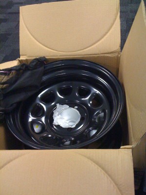

Yes, new mags arrived today (well 2 of them, other 2 coming separately).
can't wait to get them on! Cheers Greg @ Off Road Specialties

Got my new tyres put on my new rims today. Pretty stoked at how well it looks :)
