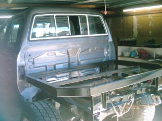

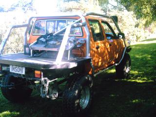

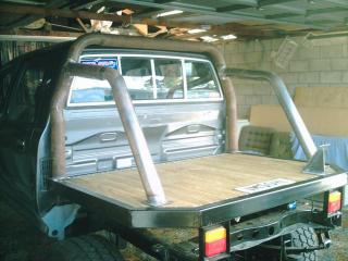

Hi all just got some pics togeather of my build its been in the process for about 3 years and been rebuild 3 times in this time done one unsucessful compitetion so now im doing it properly.

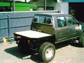

Pulling her down and Making template for rear deck

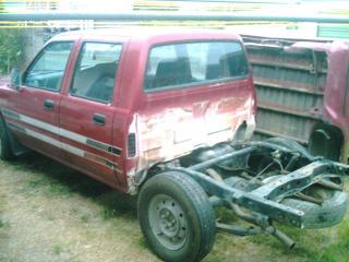

Picking up the truck from Whataroa $1600 steal

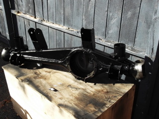

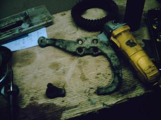

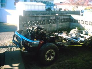

Rebuild of the rear end

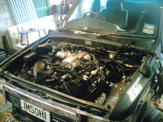

Lexus V8
Lexus V8

Deck construction pics from 2009 has full coils now
Radiatior on the back only way to go

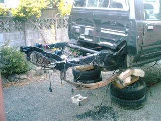

Putting the truck back togeather

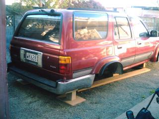

Truck Almost ready for first cert Check

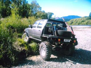

Paint job and external cage mid 2010

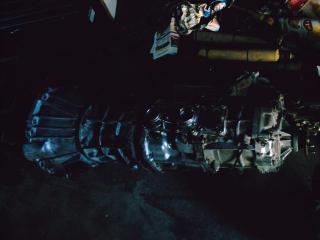

Also had setup a pto winch from the manual box for the 2010 thermal thunder in hamner, which when now i look back on it was a bit micky mouse :oops: the rear drive shaft from the r150 transferbox ran into another transfer box from a r150 that was flipped backwards the flange that would have gone to the front now went to the rear diff and the input shaft was the pto output which went to the winch. See what i mean :lol: it worked well but was slow unless dead winching.

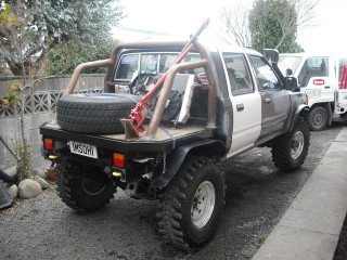

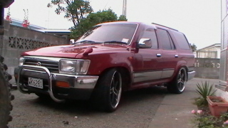

After the thermal thunder the truck was looking a bit sad so thought i would take it off the road and give it a spruce up. then the misses kicked up a stink and wanted her vehicle finished was a year and a half in to the build. Needless to say hilux was on the back burner.

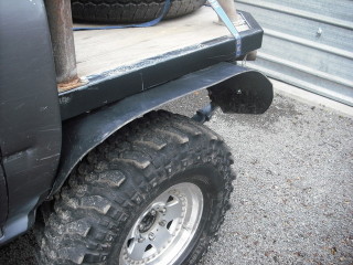

087-randoms 035.JPG (27.46 KiB) Viewed 12967 times

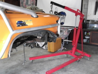

Tow Vehicle
Tow Vehicle

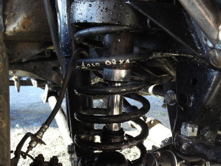

In the time i was building the surf i thought about what i wanted from my hilux it was the same time we were orginasing the top of the south winch challenge. I wanted a winch comp truck with coil springs so i whacked some radius arms on the rear diff and some std 80 series cruiser springs. this turned out to be an idea that would get changed once again.

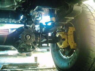

After having a catch up with Jim (DA RAM) and numerous talks with Craig Craigs 4WD about suspension setups i decided that a 4link with panhard for the front was the best option. After laying under the truck imagining, planing and a little measuring i drew some plans of where my arms should go, then i checked and changed things so they wouldnt hit. finally i got out with the grinder and plasmer.
imsohi
Posts: 727
Re: V8 blowen coiled LN106
Post by imsohi »

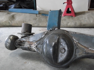

beefing up the front diff all mounts tacked then welded. design may have been copied from DA RAM!!!!!!!! Why change some thing thats looks like it will work :lol:. Springs are std 80series landcruiser.

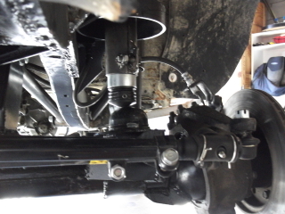

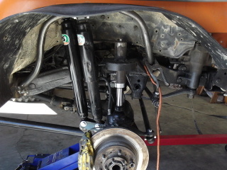

imsohi
Posts: 727
Post by imsohi »

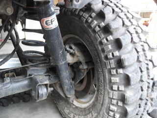

Doubble shocks and hydraulic bumpstop settup not as easy as it looks lots of ups and downs then a tack then a cut retack ect ect seems to be all good now cant wait to test it in anger.
