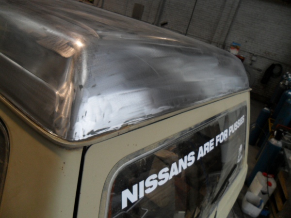

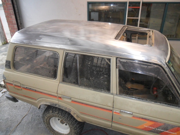

mine runs fine just that it now has a bad diff. I was in the process of getting it ready for a paint job. Have taken the roof back to bare metal no rust even around the sun roof . Its to good to wreck would be a shame to part it out

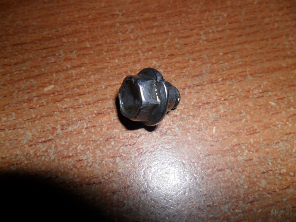

it turns out i got real lucky that the diff isnt completely stuffed. a year ago i bought the hj61 for the diffs to put into my 60 serries. Once i got them in my truck the rear diff lock didnt work. Turned out that the bolt that moves the diff lock gear into place was broken. Removed diff head to find no broken bits of bolt or not even any sign of it. So thought prevous owner had removed it.
So my diff is now in bits and i cant beleave that after a year that broken bolt head has been sitting in the front of the diff between the bearings. the bearings are buggered and the crush bearing suffered the worst. there is no damage what so ever to any of the Gears / Teeth.
Seems strange there has been no noise nothing. The funny thing is that the head of the bolt isnt munched up it still looks good as??

Here is the bolt that done the damage
