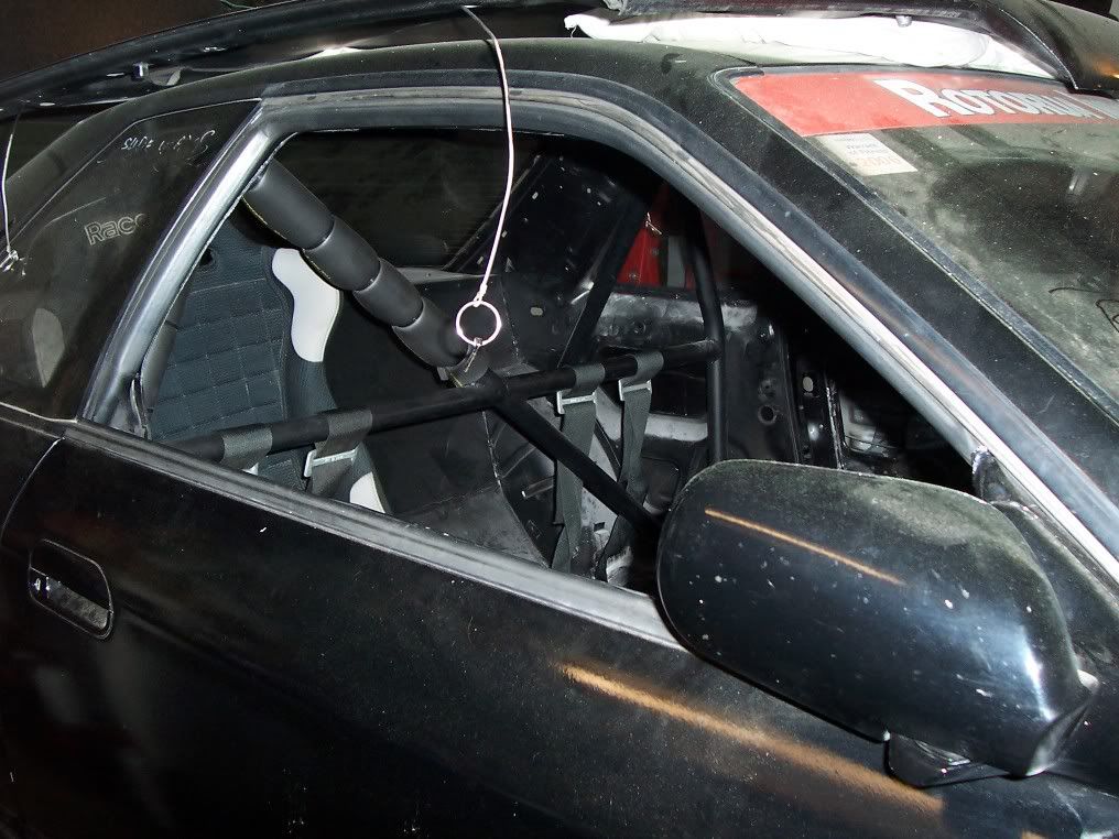

the backseat is allready way to small to fit anything on
just like my skyline backseat http://i68.photobucket.com/albums/i38/m ... llcage.jpg
