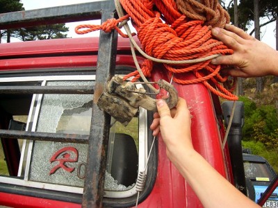

My understanding is that 10000lb rated hook will straighten and let the strop come free when overloaded not rip of or break free becoming a projectile.
Re: Recovery points.
klompy wrote:My understanding is that 10000lb rated hook will straighten and let the strop come free when overloaded not rip of or break free becoming a projectile.
Yip, my understanding too (providing they are mounting correctly). This is the reason I use them
- Moriarty

Is it, Mike, when we talk of "Rated recovery Points" that we are referring. not to the mounting of a hook, but the hook, itself?
Hence, you MUST have a rated HOOK as your recovery point, NOT a factory fitted towing eye, tiedown point?
This is how it was pointed out to me by the guys up in the Waikato, who had me in their care during mu initial training as a new 4WDriver.
That is my understanding too. I gess a rated hook is only as strong as it is mounted.
On that point here is ccvc minimum mounting requirements, if anybody doesn't know how to mount there hooks.
http://www.ccvc.org.nz/index.php/ccvc/c ... 050803.pdf
yeah dosent really matter how rated a hook is if the mount comes off with it
been seeing a few problems on forums with lighter 4x4's ie 3mm chassis.
captive nuts being ripped out, nuts being pulled through the chassis. lack of load spreaders or backing plates.
also D's are favored (and they are "rated") which means a shackle is required, which adds to the missiles weight.
