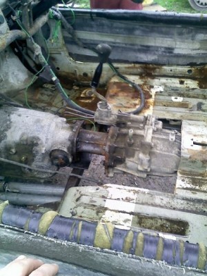

tuk
Posts: 203
Joined: Fri Jul 23, 2010 8:38 am
Location: Ypawa
Re: 1982 hilux 2.2 diesel to V6 commodore engine conversion.
Post by tuk »
a pic of the adaptor plate
tomsoffroad
Flopsie
Posts: 2445
Location: North Canterbury
Post by tomsoffroad »
Thats mint 8) .
Think I might do this to the Narvara and ditch the devorced transfer which is in it.
Sooooo, what do I need to find? :roll: The Narvara has a VN auto. Is the output shaft on the auto the same as the manual?
Cheers Tom
tuk
Posts: 203
Location: Ypawa
Post by tuk »
gotta be an auto i think, iv seen a transfer case from a manual isuzu and it wont work as its part of the gearbox, but the auto runs independent from the gearbox so no probs. So the setup that weve used is, holden v6 3.8 auto with isuzu bighorn auto transfer case.
