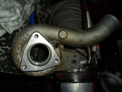

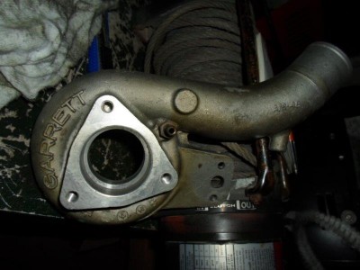

Posted: Thu Apr 11, 2013 8:16 pm
by Cambo
Got a interim replacement turbo, was planning on rekitting the turbo thats currently on the truck. The one that turned up is a Garrett A/R .48, JW1 M4 .49
Compressor housing
Compressor housing
The unit on the truck currently has another 3 bolt flange on the compressor outlet
Question:
Does anybody else have this type of turbo/housing on their truck and are the housings interchangeable?
Have done a few searches but cant seem to find any hard/fast answer
Re: What flavour TD27T does your Terrano have?
Posted: Fri Apr 12, 2013 9:05 pm
by slide
Could be wrong, but that appears to be either mistral td27t or r50 td27eti turbo
Posted: Sat Apr 13, 2013 7:22 am
by Cambo
After pulling the other unit off my truck the garrett appears to be slightly bigger, but have alot better exhaust flow. I got the die grinder out just to match it all up nicely. Will chuck some picks up later
