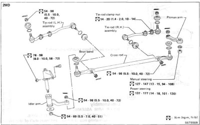

Just been trying to install the 2WD cross-rod and tie-rods. I must have it around the wrong way or something but the angle of the tie-rod doesn't look any better than before.
Anyone got photos of their install?
Because of the taper in the idler and pitman arm holes for the threaded ball joint, to me it looks like you need to flip the idler and pitman arms upside down and then install the cross-rod up from the bottom instead of the top.
This would then put the cross-rod more level with the wheels knuckle-arm. Then the outer tie-rod would still be inserted from the top.
