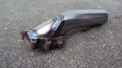

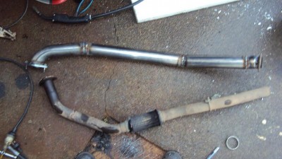

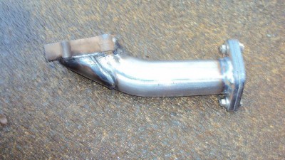

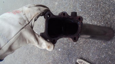

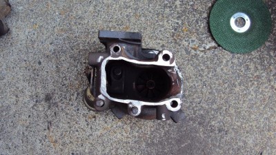

RB_FIEND wrote:used the standard dump pipe flange lol i couldn't be arsed sussing out getting one cut . shes a little rough but made a huge difference !!!!!
be interesting to see how that welding onto the cast iron lasts.

iv welded externals onto many cast manifolds in the past and never had any problems . the trick is to preheat the cast so that when you weld to it it doesn't super heat a concentrated area causing it to form hair line cracks as it rapidly cools down.
excellent. good to know :)

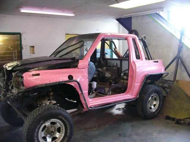

WARNING IMAGES MAY HURT YA EYES
watched/helped stinky apply some paint to his zuk................
was busted dipping my balls in the same paint.......end result ok.....

Yup preheats the key and either use "super cast" sticks all round or lay down beads on both parent matierals and finish with 316 s/s sitcks. One aera I will reccomend busting out the stick welder for better results
