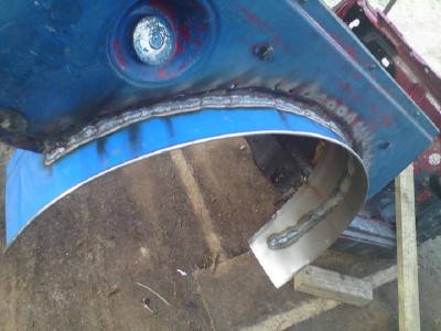

Re: Suzuki+4age+Hilux Axels+coils+Exo Cage

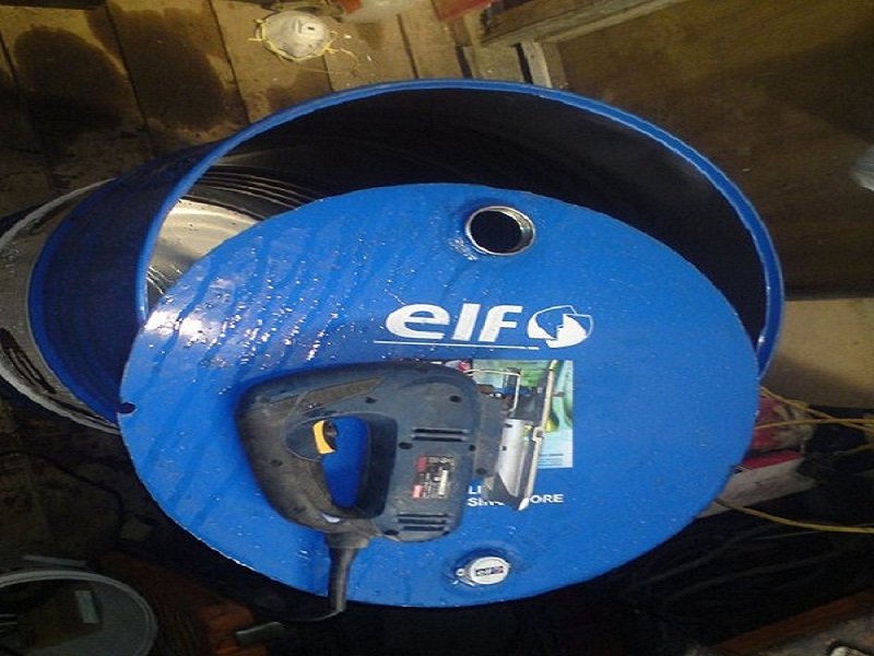

Post by Mattrade »

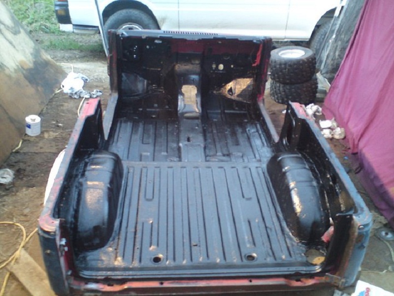

Wheel Arches out oil barrels
Mattrade
Posts: 386
Post by Mattrade »
Welded up

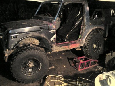

Post by Mattrade »

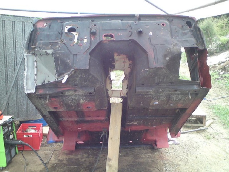

Cut out front tub to make room for some 33"
Post by Mattrade »

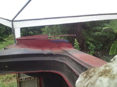

rounding gards

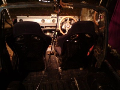

Mattrade
Posts: 386
Post by Mattrade »
New race seats on ally blocks
Post by Mattrade »

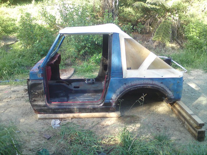

Body on

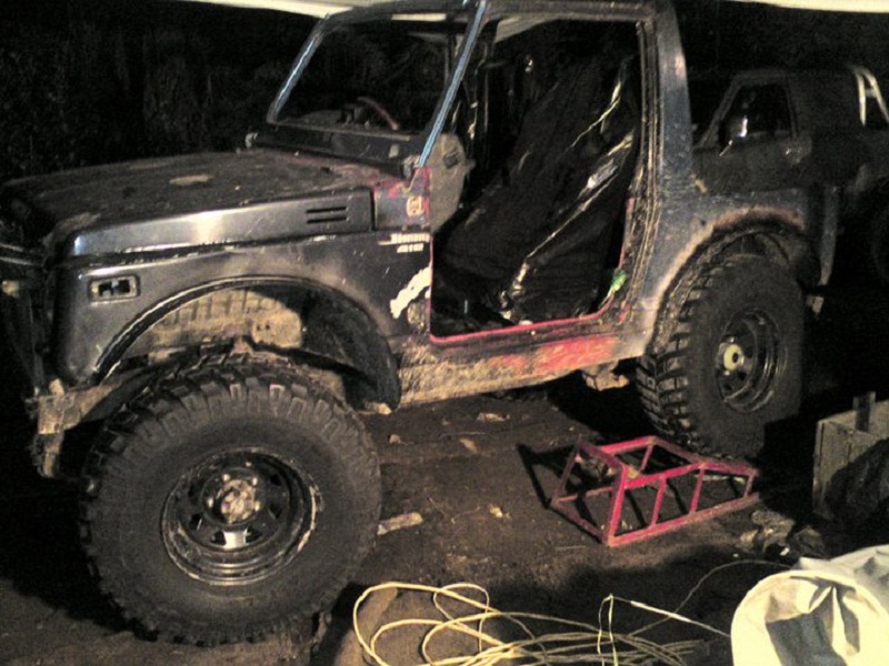

New Micky Baja Claws 33" 12.5. No eating for a month

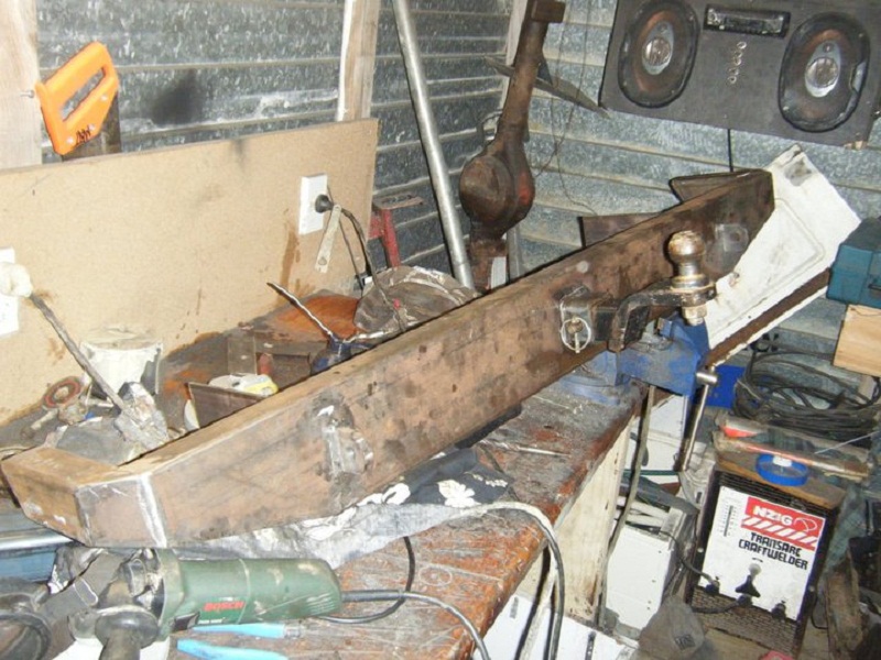

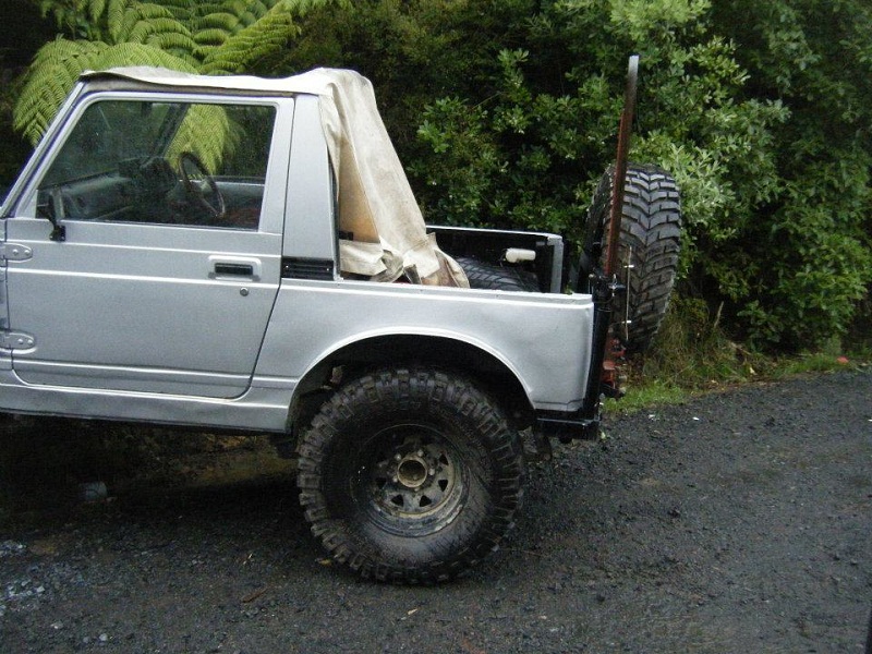

Back bull bar

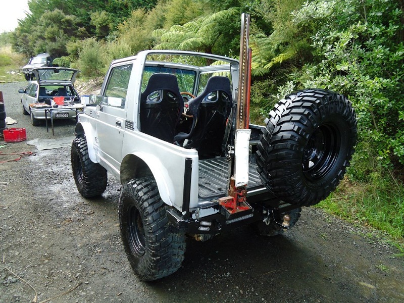

Post by Mattrade »
Hi lift jack holder on swing away

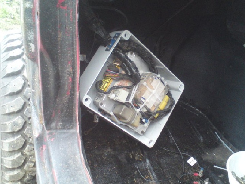

Water proofing ecu

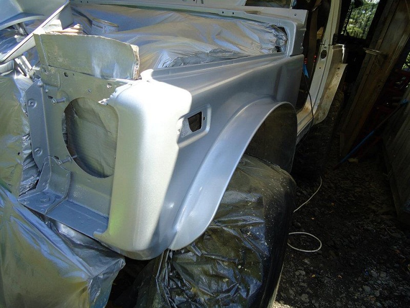

Weeks of sanding later, paint :D

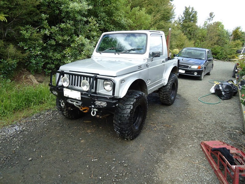

year one finished all certed and wofed

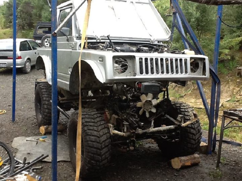

Post by Mattrade »

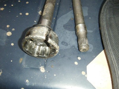

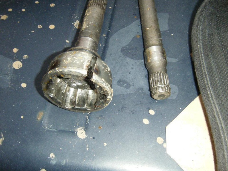

Been out a few times and it always ends the same way. stage 2. axels :)

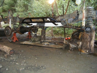

Mattrade
Posts: 386
Post by Mattrade »

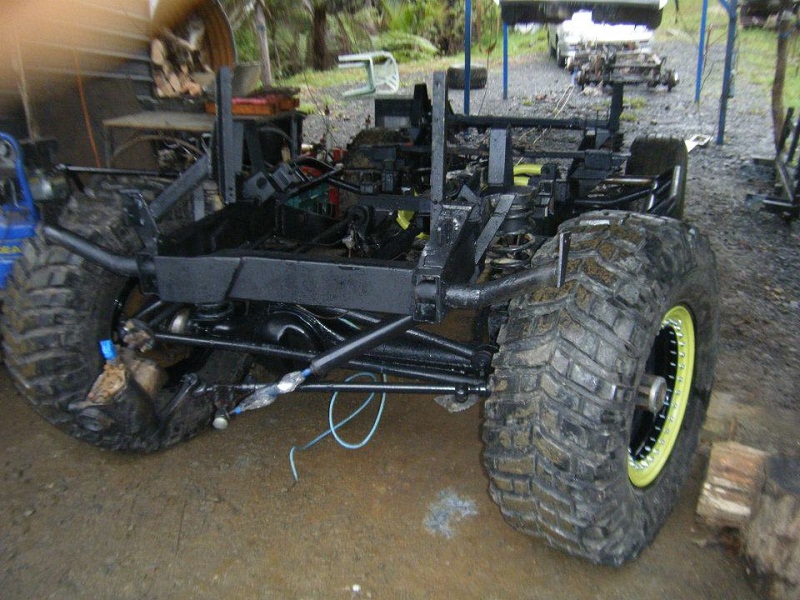

Hilux axels with coil springs from a volvo. 3 link front and back. 10" travel front and 8" at the back

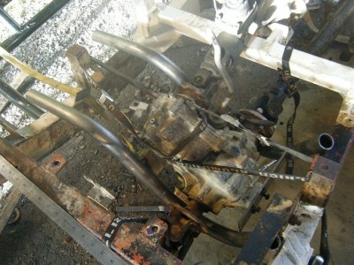

Mattrade
Posts: 386

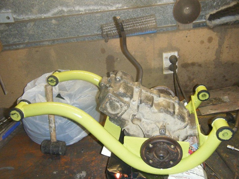

Post by Mattrade »
Mocking up 410 transfer case

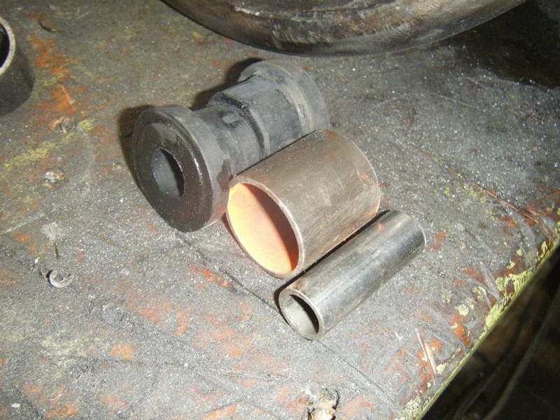

shackel rubber mounts

Mattrade
Posts: 386
Post by Mattrade »

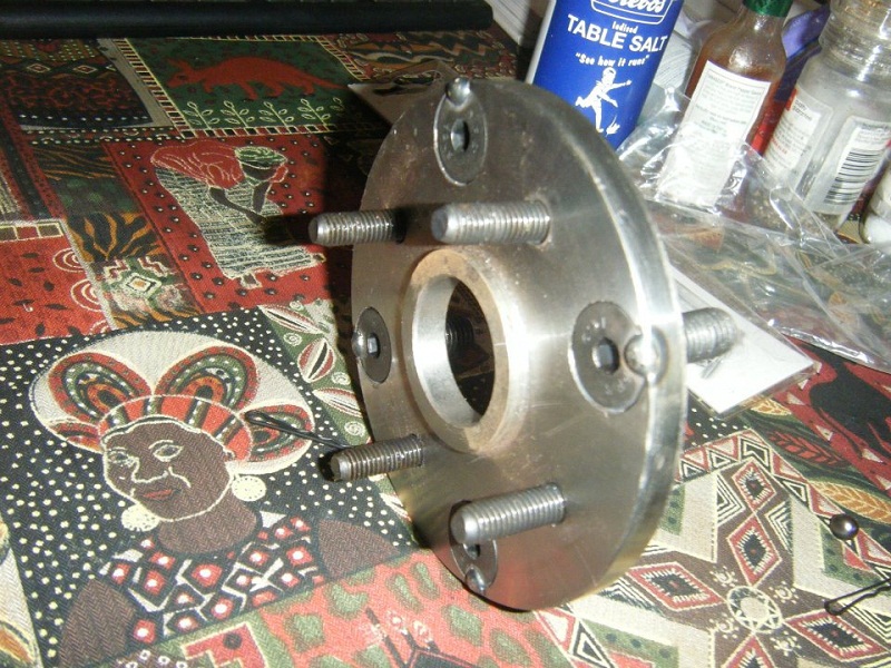

Suzuki to hilux adaptor

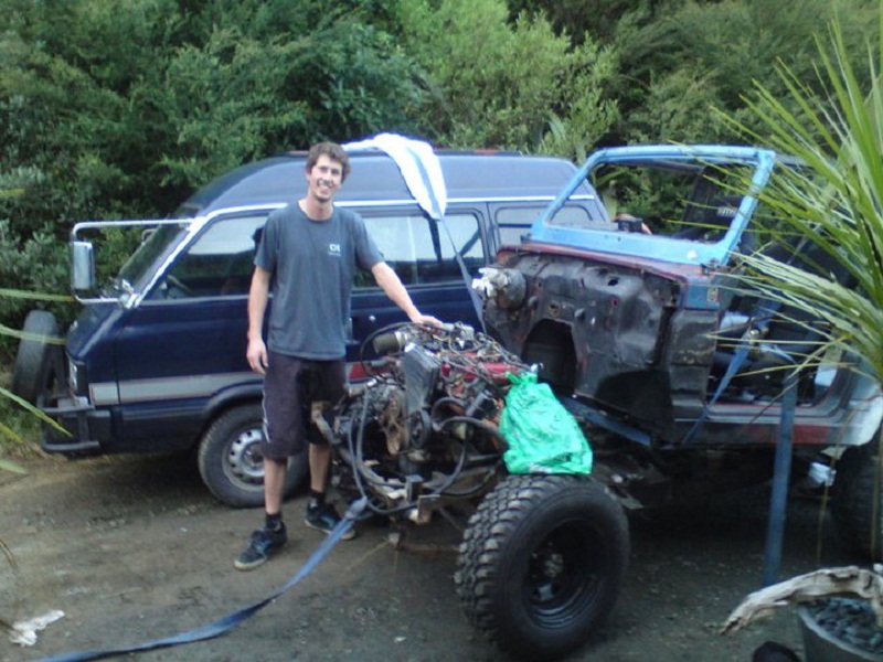

New fwd fxgt motor with 126k on it. rebuilt with rwd parts, new seals and gaskets.

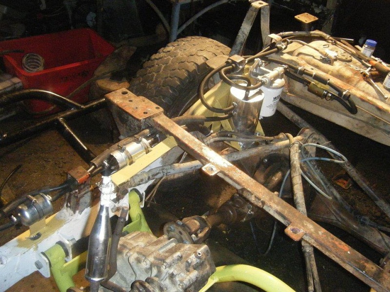

Post by Mattrade »
fuel system. 2 fuel pumps and water fuel seperater.

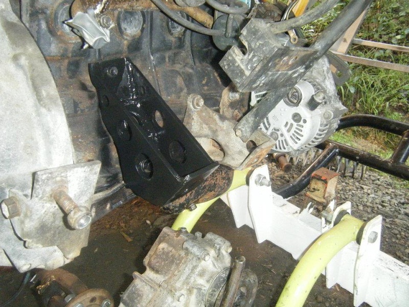

Post by Mattrade »
new engine mount to miss steering

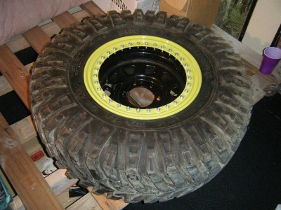

Mattrade
Posts: 386
Post by Mattrade »
chinese bead lock rims, painter bead ring.
