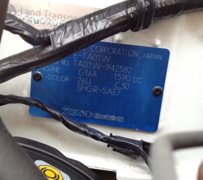

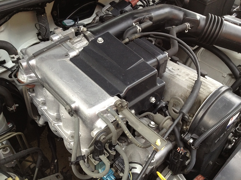

Do I have EPI?
For all Suzuki related topics
Rotazuk
Posts: 937
Re: Do I have EPI?
Post by Rotazuk »
Yes . its a 16valve single overhead cam multipoint injected engine . I would say that is the later version of the engine .
strx7
Posts: 159
Re: Do I have EPI?
Post by strx7 »
its a mid/late 90s g16a mpi. its got the hotwire type air flow meter (13800-58B00), cream coloured injectors, coloured inserts in the door cards, half moon shaped dash cluster and thumb groove type bumpers, and most likely the inbuilt coil dizzy with the 7 pin plug.
