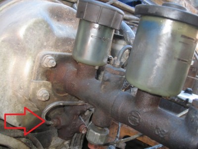

Hi all,
Im having trouble with my brakes... i found that two pots on my front calerper where sized so i free them up, after bleeding brakes all round the pedal still goes to the floor but after one pump it holds pressure and does not lose it i found this thing under the i would like to know if anyone knows what is master cylinder and i would like to know if anyone knows what is.
also what could be the problem iv adjusted the back brakes and all but still goes to the floor it has disk brakes in front and drums at rear any help will be appreciated.

im starting to think it may be the master cylinder or that thing if its some sort off valve?

ClassicCruiserSpares

Re: Bj40 Brake problems..
That thing your pointing to is a proportioning valve splits braking between front and rear so fronts work more than the rears. Sounds like you need to bleed all the brakes better, front and rears.

Post by Scobby12 »
ClassicCruiserSpares wrote:That thing your pointing to is a proportioning valve splits braking between front and rear so fronts work more than the rears. Sounds like you need to bleed all the brakes better, front and rears.
Thats what i thought it was but it looks like only the one pipe for the rear brakes go into it.. that lead me to think its not..iv bleed the brakes quite a lot and no air coming out, should i just keep trying?

Post by churchill »
That thing your pointing too could be the residual pressure valve. What it does is hold a little pressure in the rear drum cylinders so that the shoes don't have to travel all the way each time you press the brake pedal. This failing might cause the symptoms you are talking about.

churchill wrote:That thing your pointing too could be the residual pressure valve. What it does is hold a little pressure in the rear drum cylinders so that the shoes don't have to travel all the way each time you press the brake pedal. This failing might cause the symptoms you are talking about.
Interesting... is there anyway i could pull it apart?

Post by niblik »
As jason aka classiccruiserspares has said, pretty sure it's a proportioning valve.
churchill wrote:There must be a way to get it apart, never pulled one apart myself but will have to soon as I'm doing a disc conversion and they need to come out for that.
I've done a rear disc conversion. mine is running the stock proportioning valve and it all works a treat.

Post by Scobby12 »
niblik wrote:As jason aka classiccruiserspares has said, pretty sure it's a proportioning valve.
But the reason i think its not is because only the back brakes are hooked up to this valve, if it is a proportioning valveshouldnt the front brakes be hooked up as well??

Post by niblik »
couldnt see much detail in pic sorry chap..
could it act as a restrictor similar to the willwood adjustable style valves, so it is effectively letting through less fluid to the rears so thus sends more fluid forward.. hence portioning the fluid?
Scobby12 wrote:If it is a proportioning valveshouldnt the front brakes be hooked up as well??
Nope! all the proportioning valve does is reduce the braking on the rear so the rear dont lock up before the fronts, This will allow the front to dive under brakes.
Your wasting your time with the proportioning valve thats not your problem, Could be a few things, rears not adjusted properly (most people dont know how to adjust shoes properly), not bleed properly, maybe a master cylinder or booster problem or all of the above :lol:
