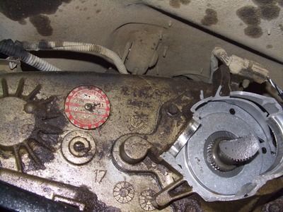

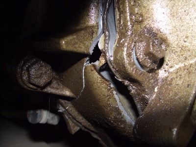

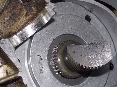

Be aware that the slip yoke may bind at any time when off road and this can happen
a slip yoke eliminator would have prevented this but didn't put it in when I had the chance, so I learn't the expensive way

Well, mine didn't explode so violently but I did bend the output shaft. I was running an engine motor mount lift to compensate but did the damage regardless.
Now I have JB Conversion super shorty SYE for the last 4 or 5 years.

you were lucky then, I was going up a hill got a bit of a bounce while still on the gas and bang, sounded like a shotgun going off.
Now has mega short SYE and modified non double cardan drive shaft, standard control arms which all seems to work well together, I don't do hard core stuff in it though, club champs courses would be the worst it gets I guess

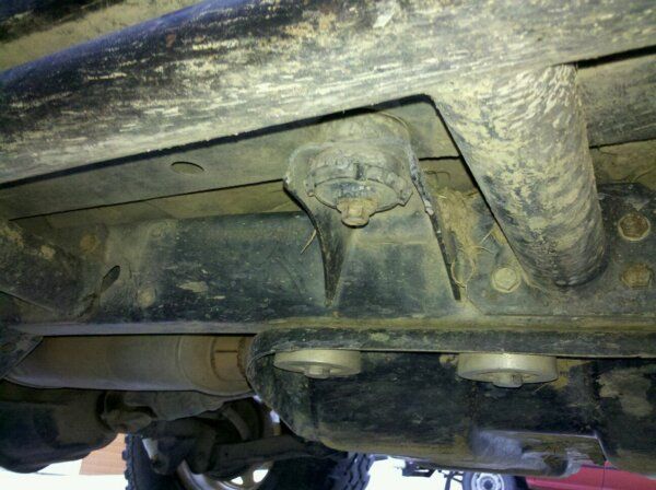

Re: "To lift or not to lift". how high is the question

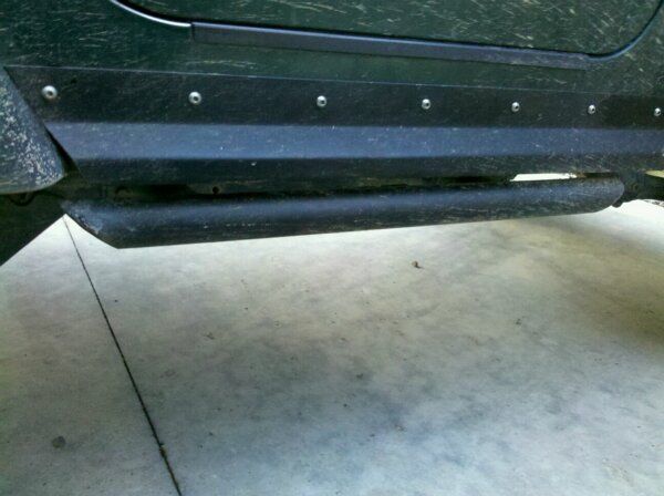

I'll take some pics of mine and post here if ya like, sliders and how they attached, sill/tub protector, PRS radio, aerial etc , give you some ideas, can do it tomorrow, am at work today
russty wrote:Hi Greg. Thanks for that and I look foward to the photos. Always good to get ideas.
I would love to go and get it dirty ,but alas I must work aswell
Russty
pics as promised
hope this helps some
Greg
