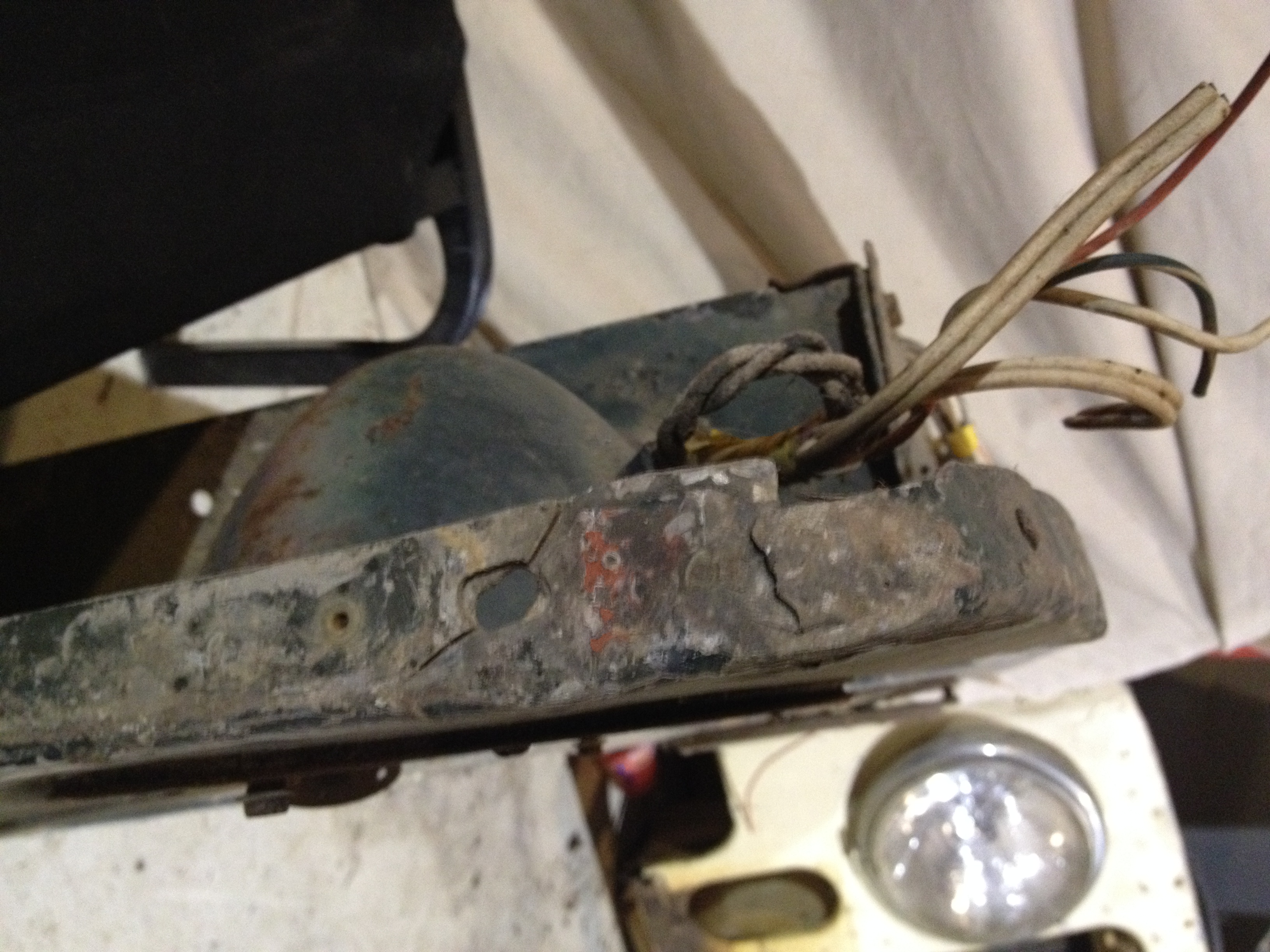

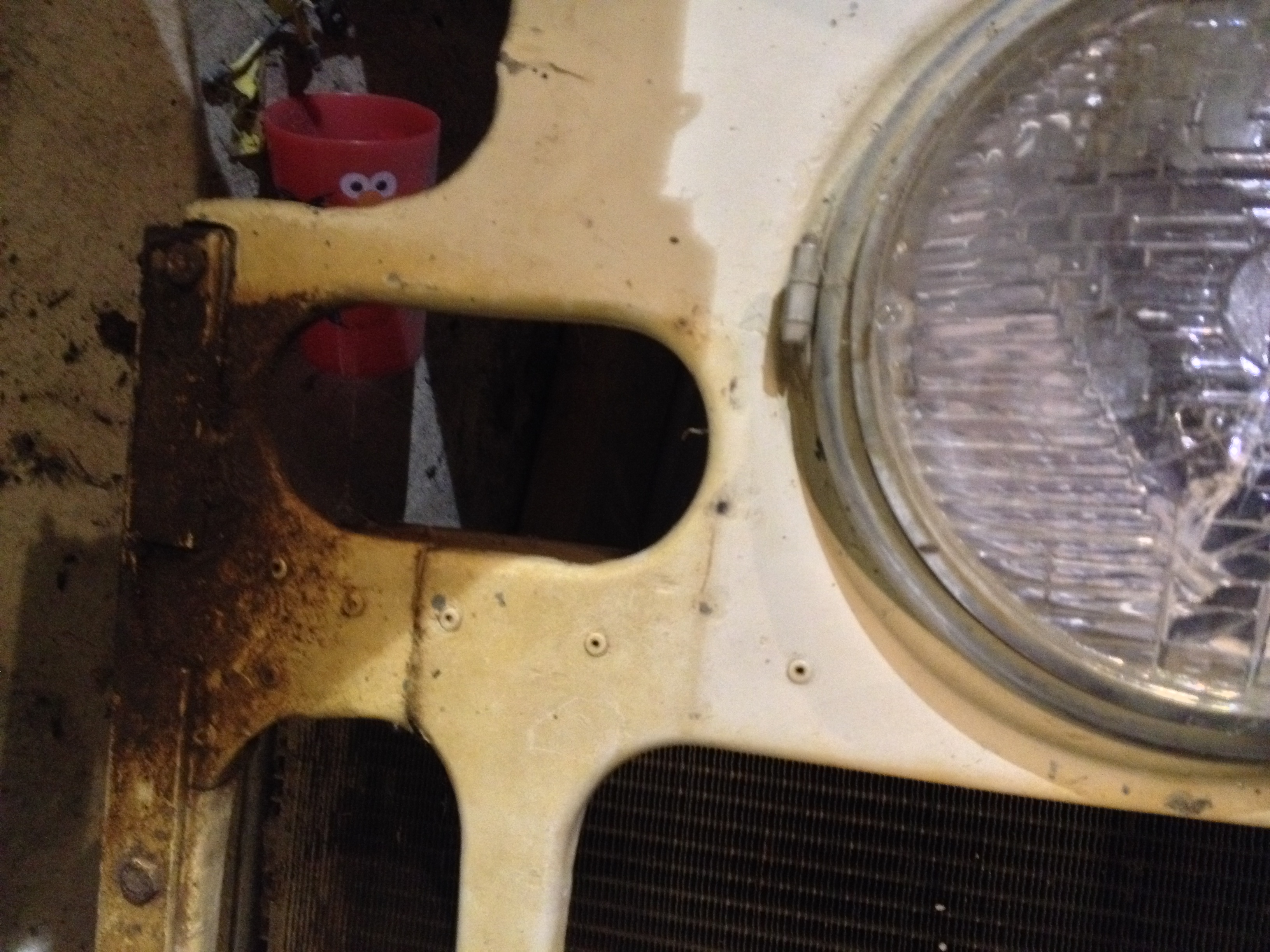

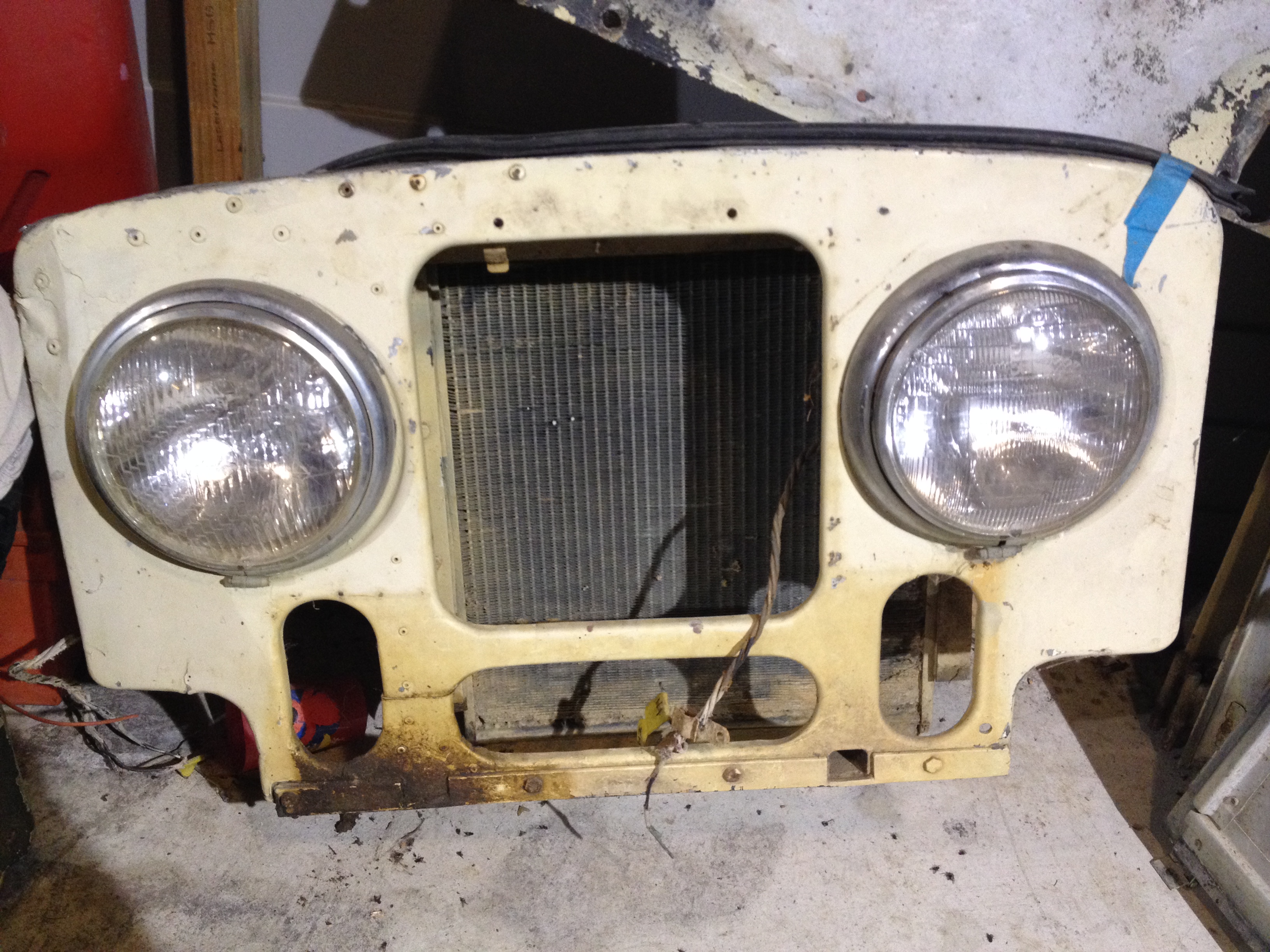

Now that's out of the way, the fire wall can come off, and the front panel with radiator can come off.
The fire wall looks good from a distance:

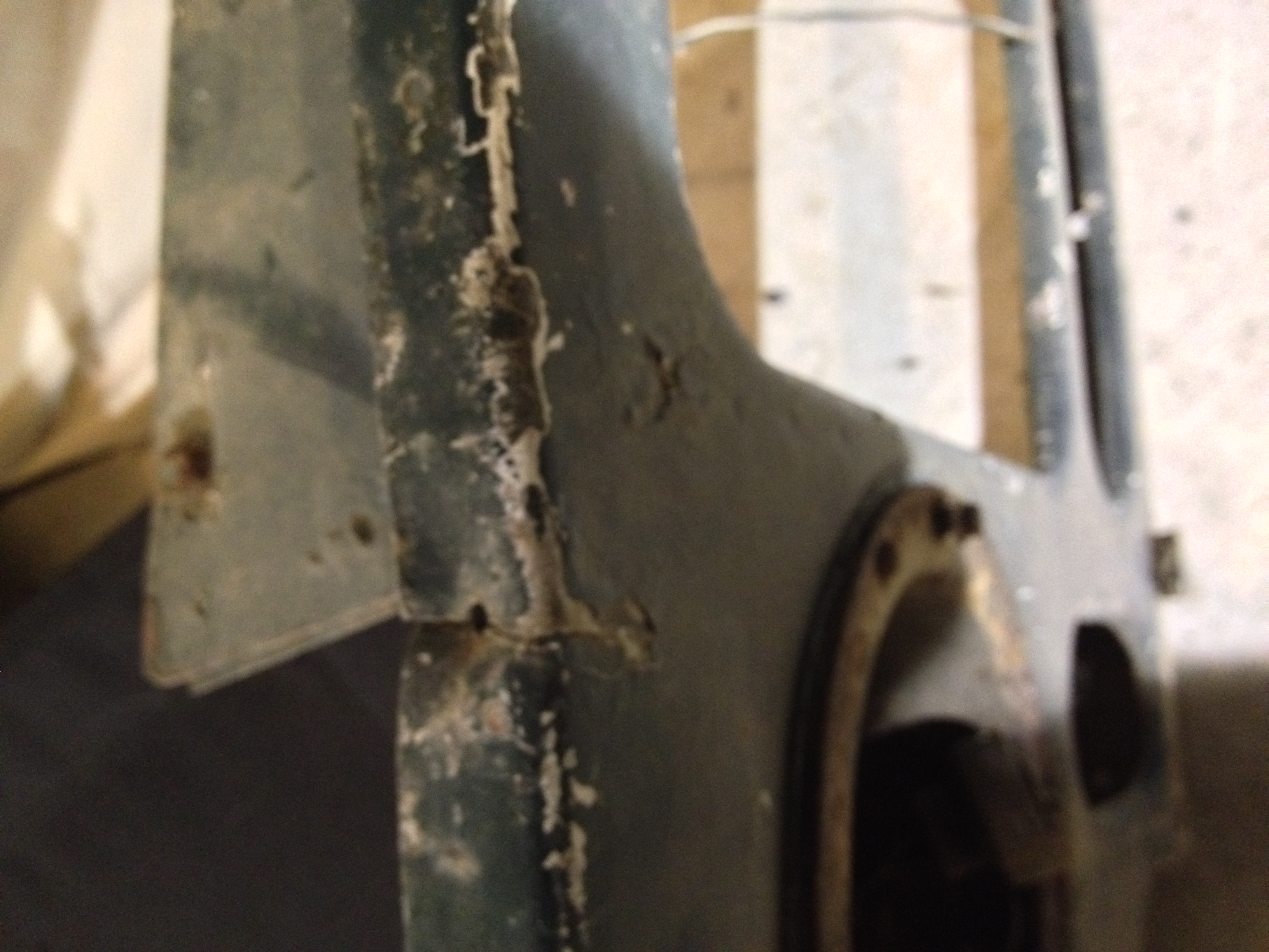

but is not......

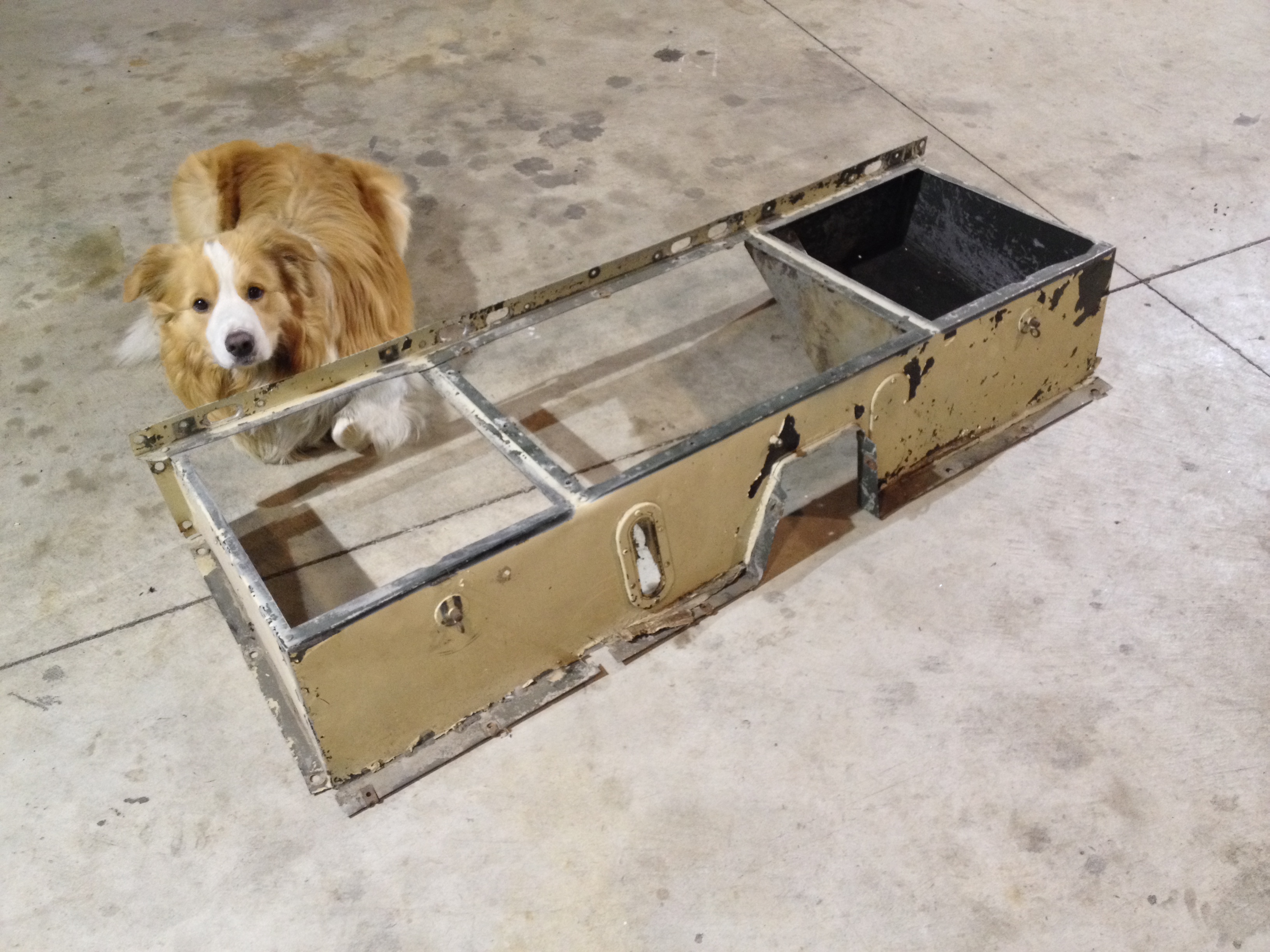

neither is the fuel tank support:
Nothing a grinder, some plate and a welder can't fix :D :D :D

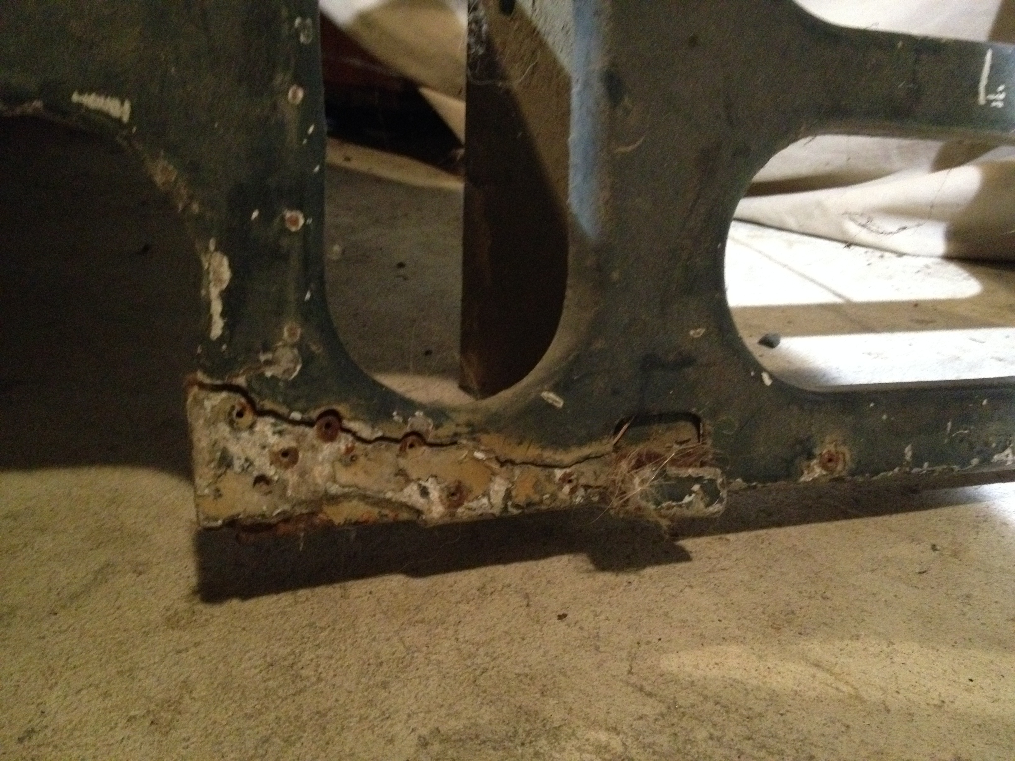

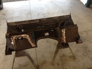

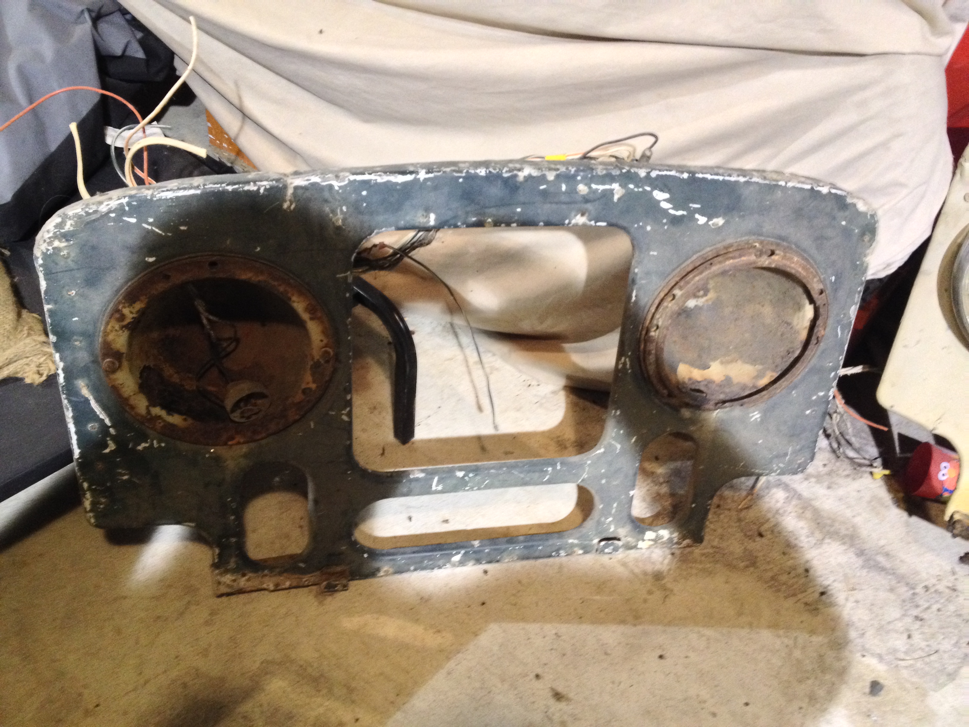

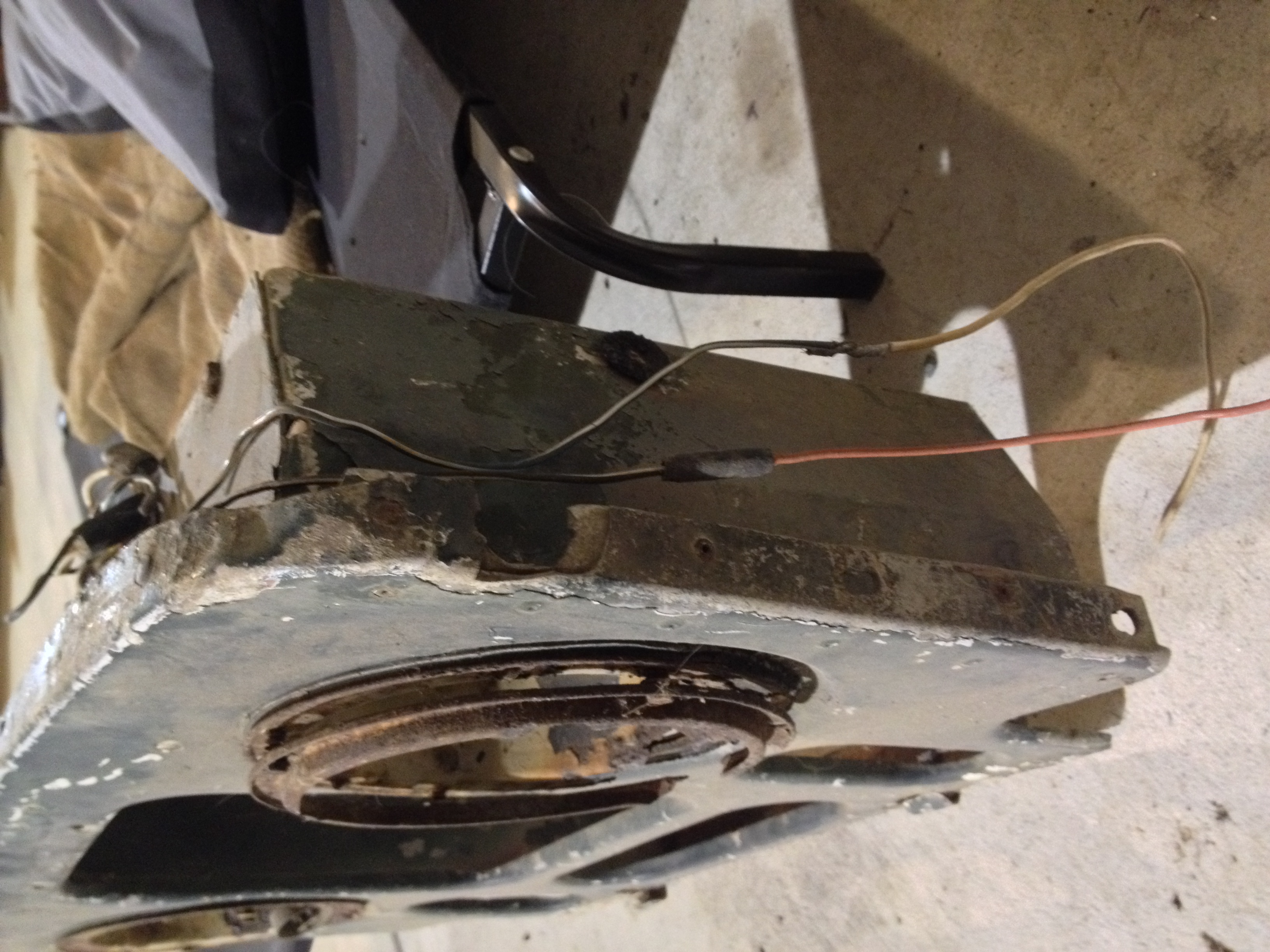

To fill in the gap in the thread, the fire wall was worse than we thought, so that came off too, then the engine and gearbox came out, and basically its sat as a semi rolling chassis for quite a while.
The old engine and gear box, fire wall and other parts are lurking in various corners of the work shop :lol: :lol:

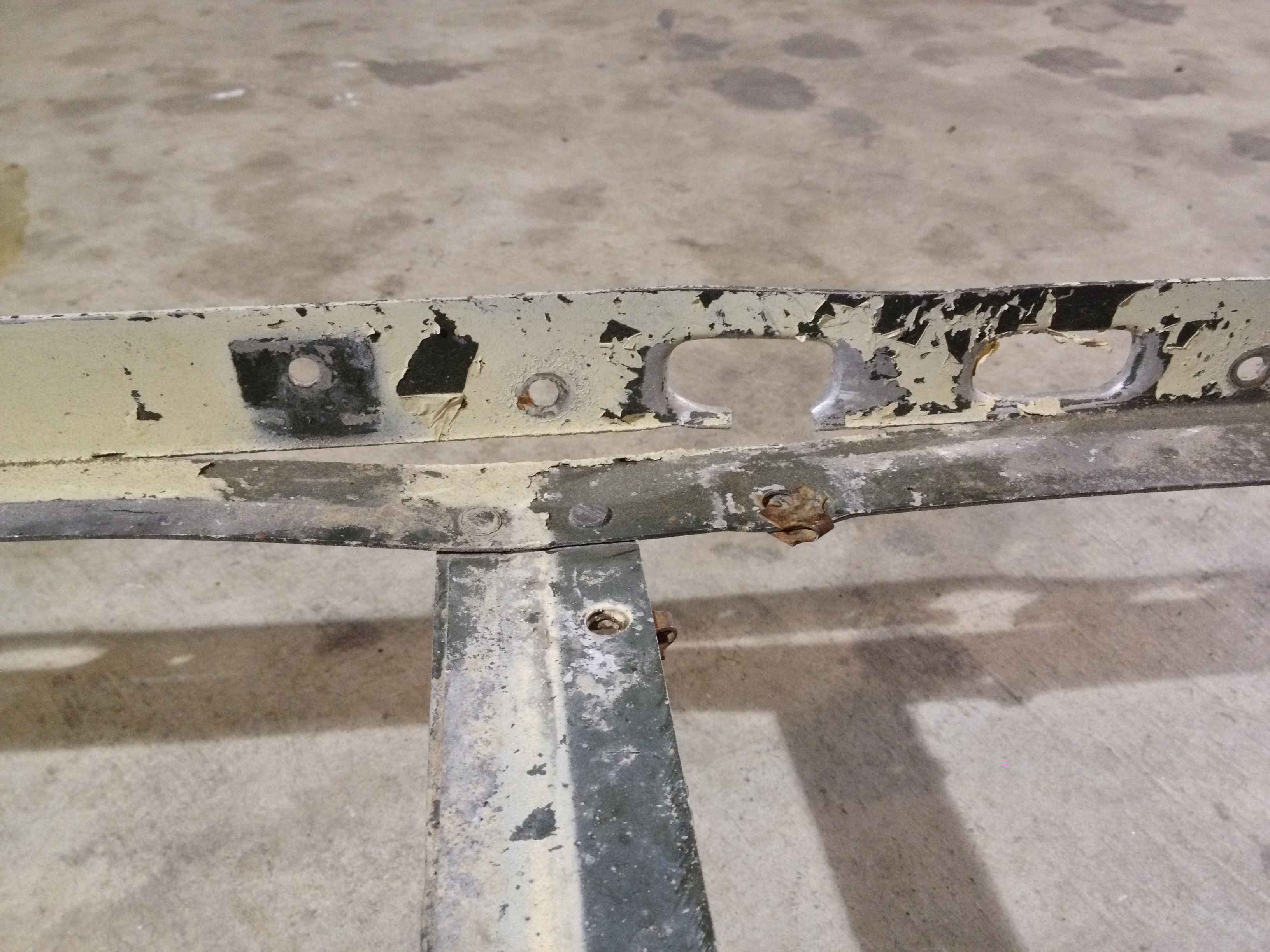

Over the years Dad had collected bits and pieces to do the chassis repairs.Trouble was the replacement bits were pretty tired them selves. Especially the replacement rear cross member. Luckily Rex at www.landroverspares.co.nz had a Series 2 Rear Cross member sitting on the shelf ready to go, so grabbed that and came up with a plan to make it work.
This is the result, one farked rusty patched up cross member mercilessly hacked off and discarded :twisted: :twisted:
Then it was time to clean up the chassis and make it suitable to receive the new cross member:
In order to get it to this stage, this the rusty rotten crap that had to be removed. A lot of it was old patches that had been welded on, hiding a lot of good chassis underneath them. Spring perches also got cut off and chucked in the scrap:
It was a mission as I was trying to preserve as much of the original chassis as possible so I had something to weld the new cross member to. This is the pile of grinding and cuttings discs at the end :lol: :lol:

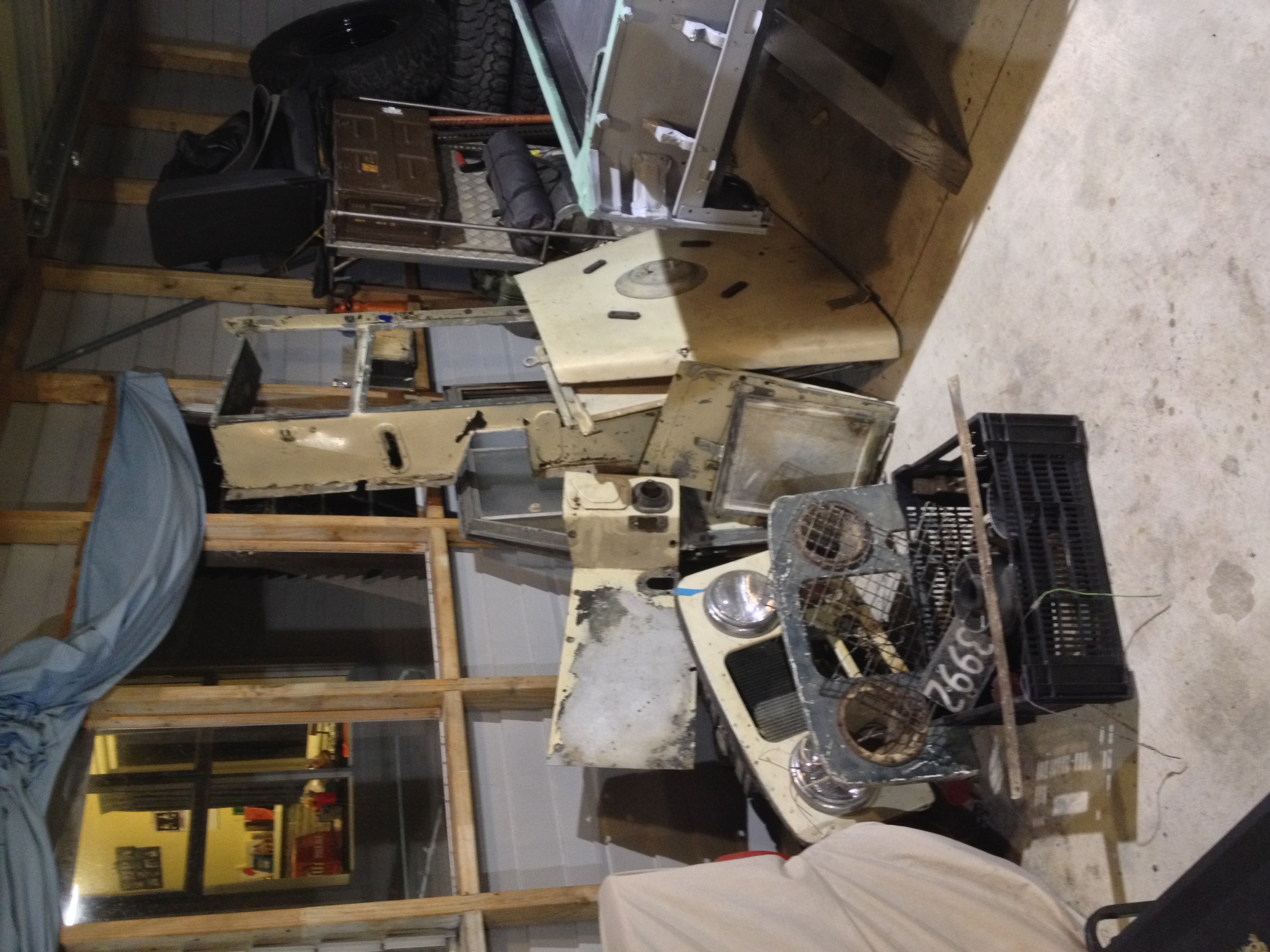

I'm missing having a cool toy to cruise round in, so obvious solution is to get this finished :D :D :D :D
I went to the storage shed and collected some parts :lol: :lol:
Parts
Parts

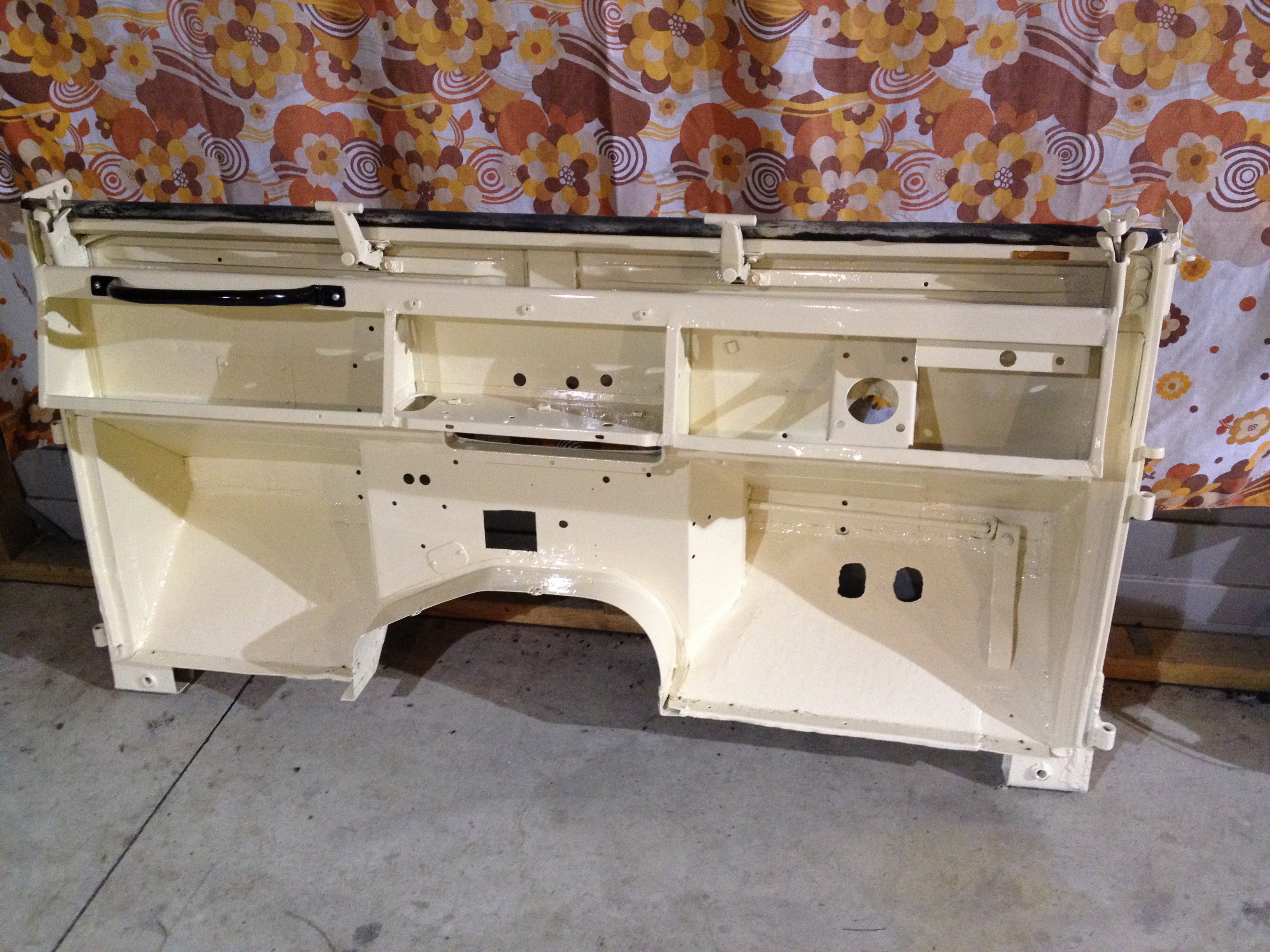

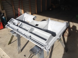

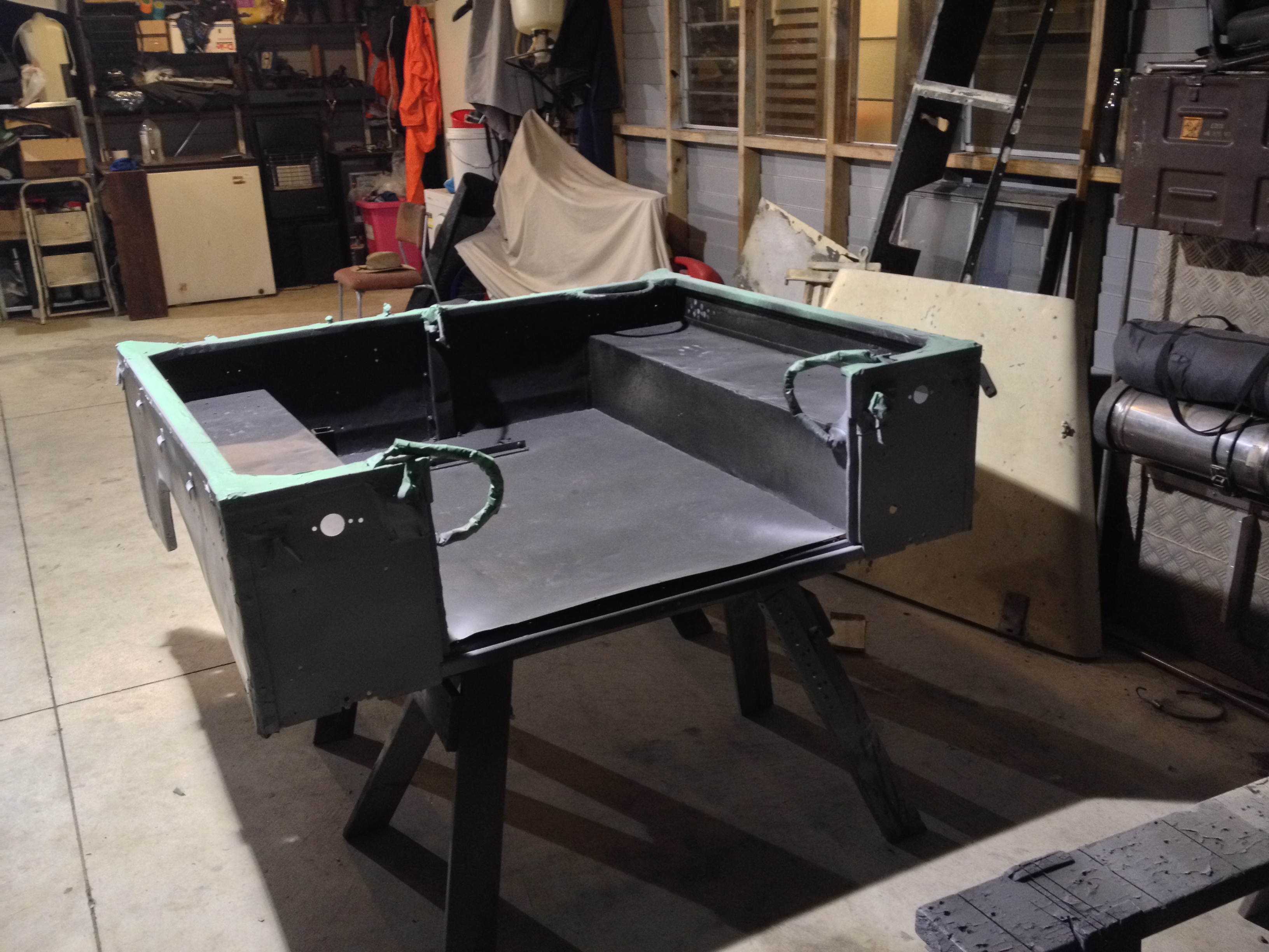

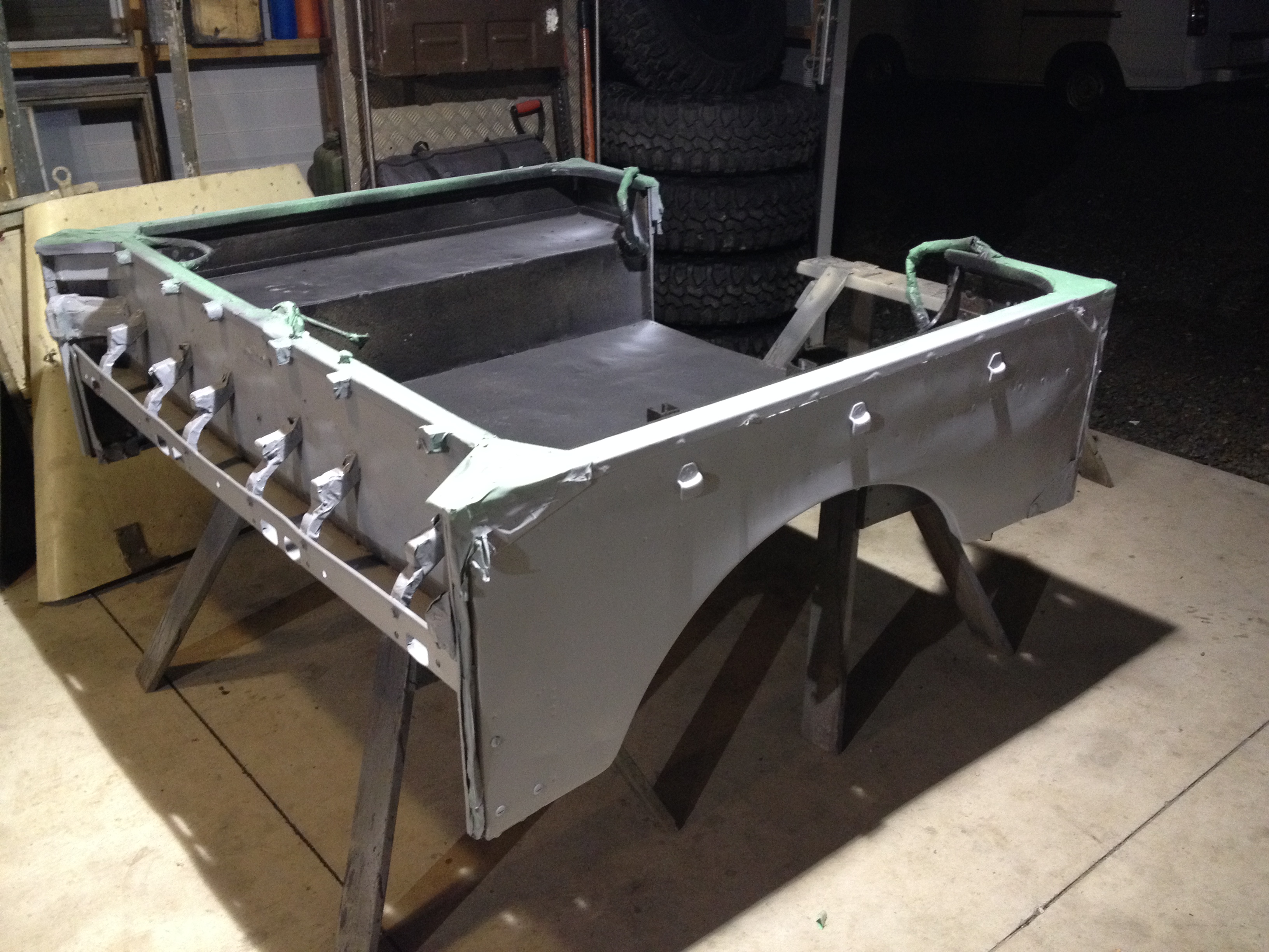

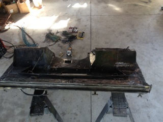

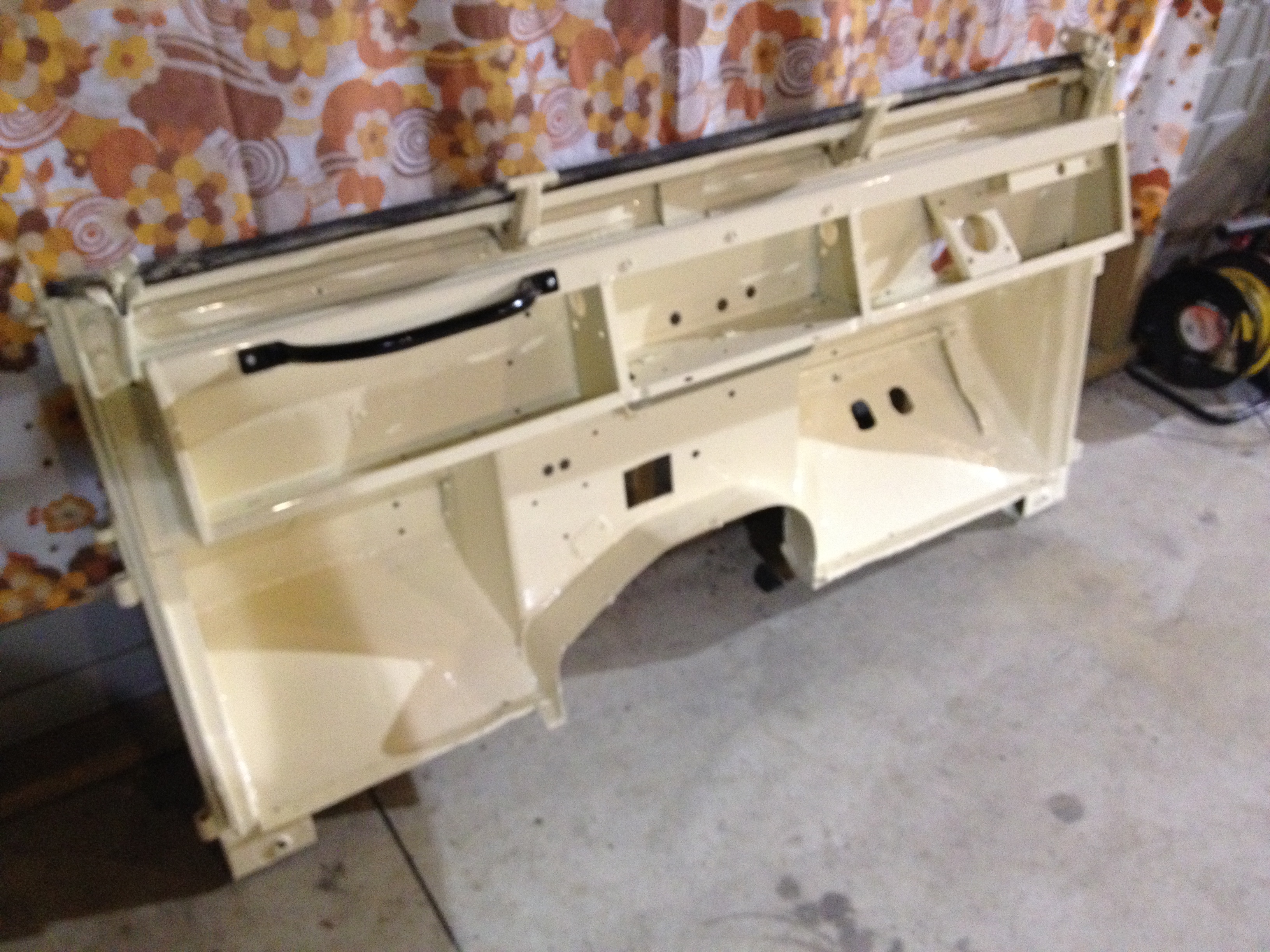

Mission number 1, finish repairing the fire wall. All patched, rust treated and ready for primer.
Firewall 1
Firewall 1
Firewall 2
Firewall 2

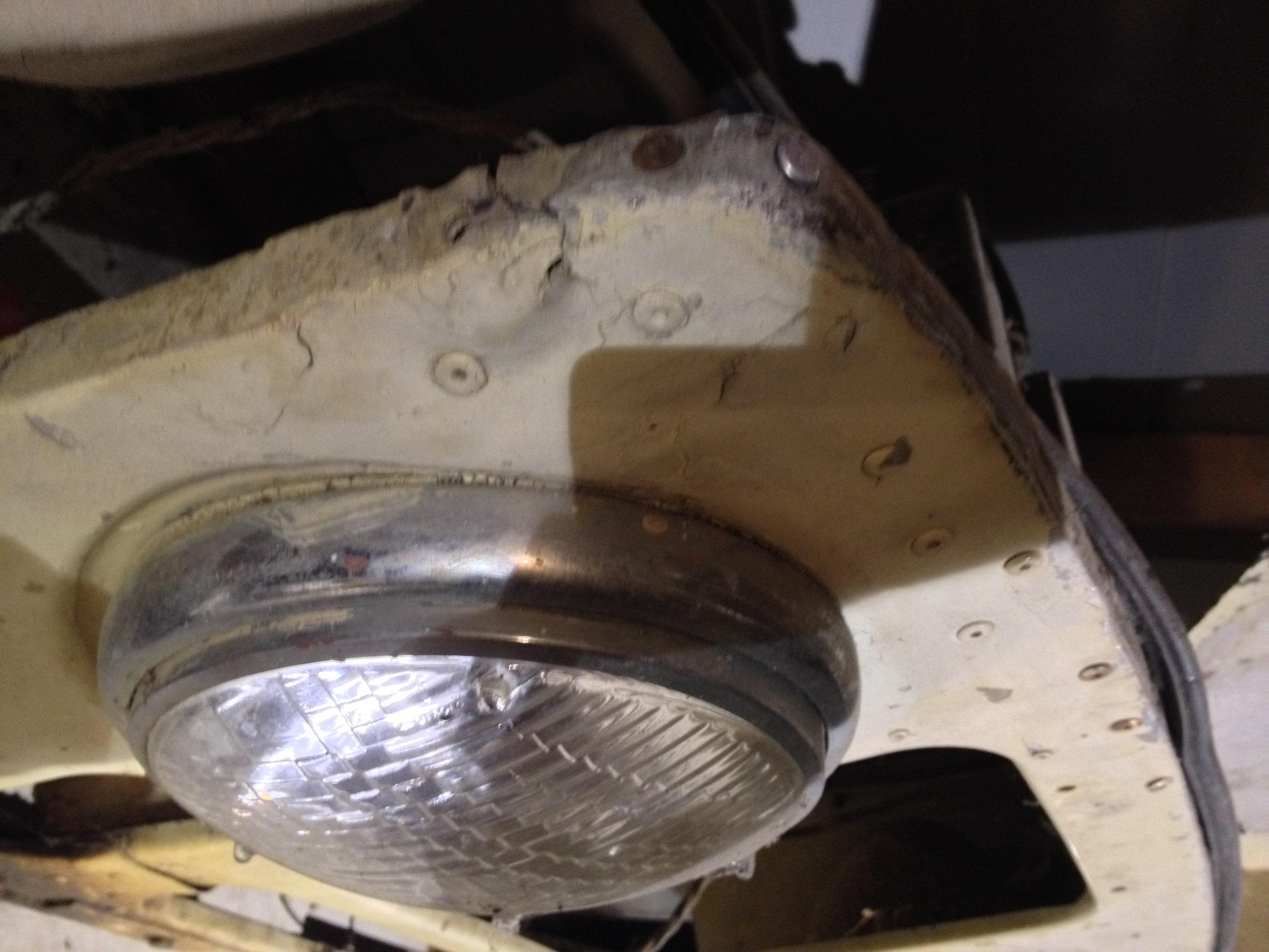

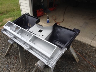

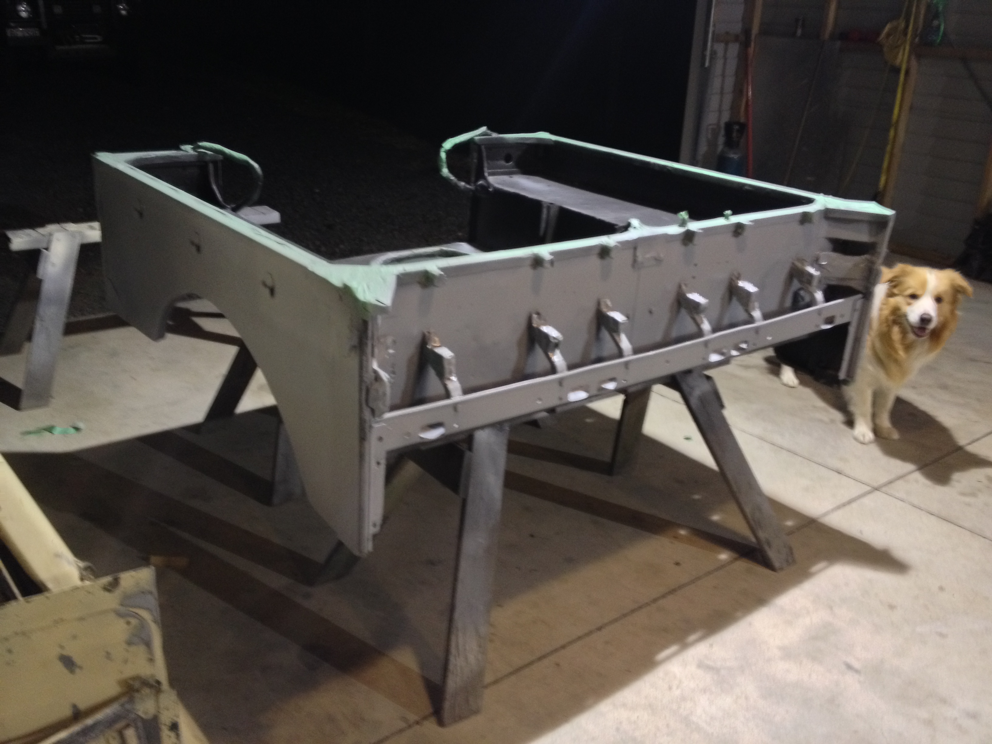

A good dose of 2K Epoxy primer to seal it up for a few more years:
Primer 1
Primer 1

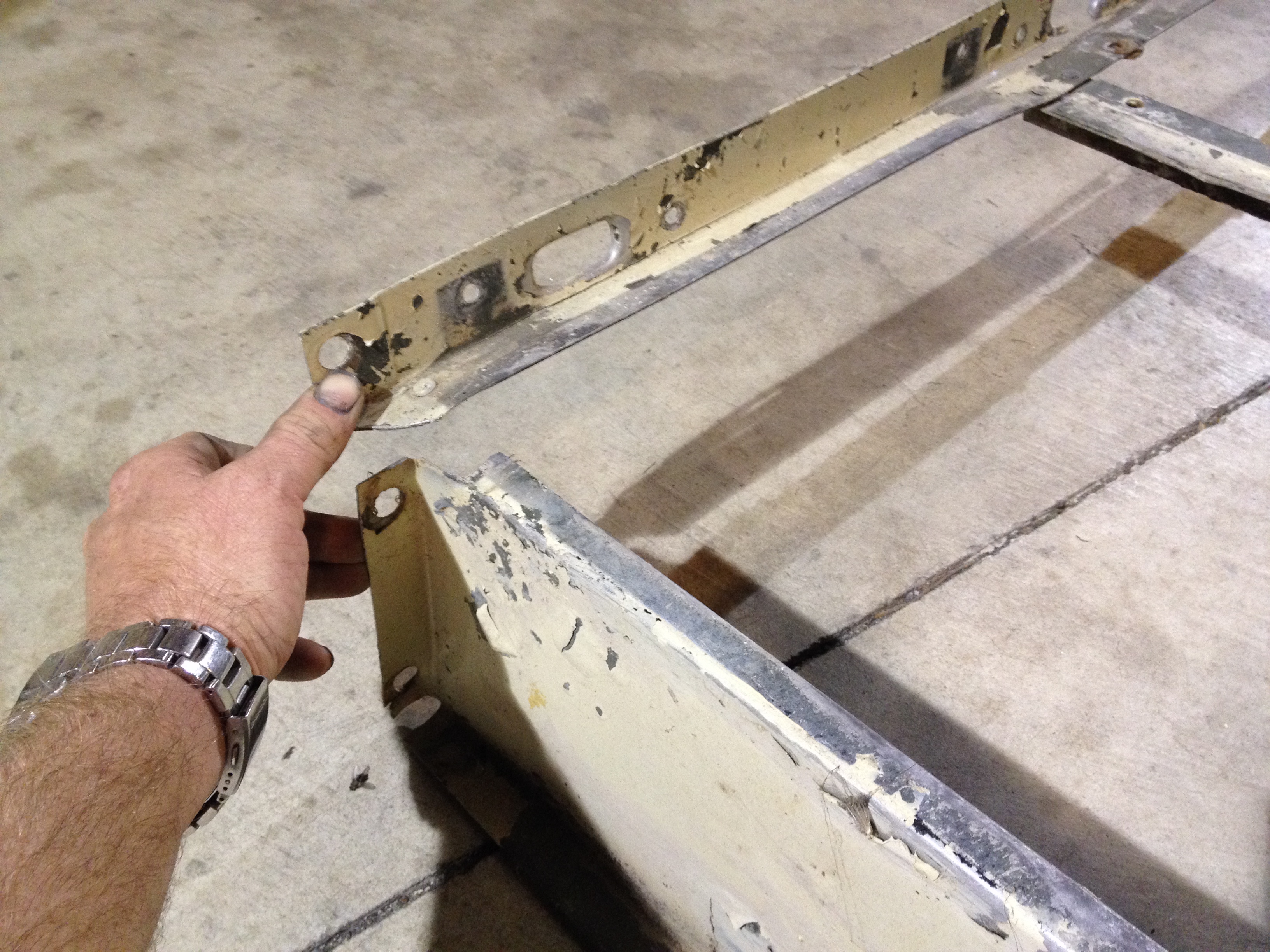

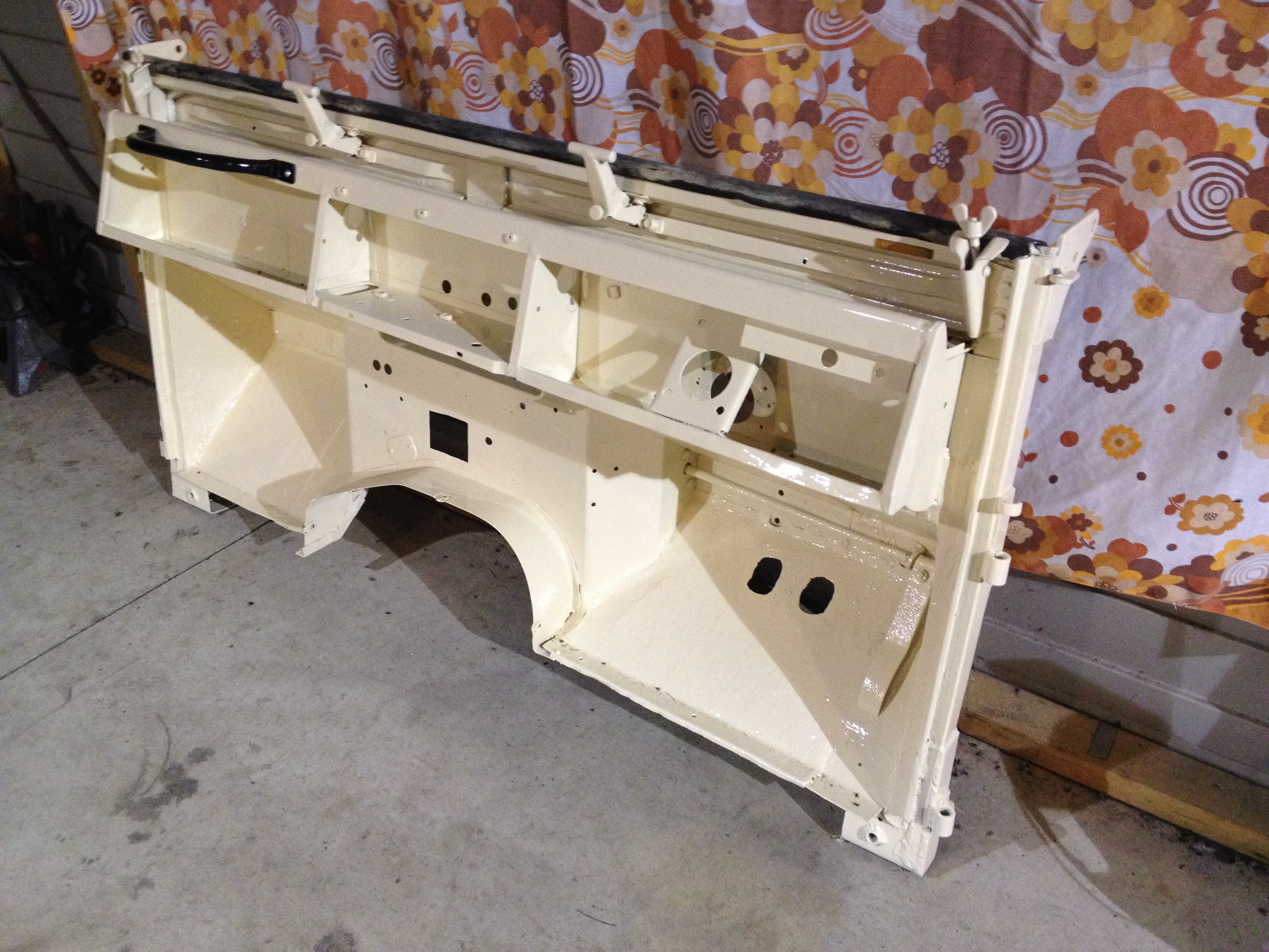

On hard wearing areas where mud and dirt is going to accumulate and be hard to clean, and in the foot wells that get hammered I have sprayed on some underbody sealer. The whole thing will get sprayed over with the top coat colour.
Ready to paint 1
Ready to paint 1

This is the orginal front panel:
This is one potential substitute, but its probably just as bad, if not worse :lol: :lol: :lol:
DieselBoy
Posts: 4568
Re: Rocky Rover 1955 Series 1
Post by DieselBoy »
Its pretty bad :lol: :lol:
Gotta be a good one out there lurking under a tree or in a barn that hasn't been to hell and back beating around the bush on Club Trips for the majority of its life!!!!

A seat box of the same wreck if it exists would also be handy :lol: :lol: :lol:

On a more positive note, made good progress with the Tub.
Lots of hammer and dolly work, blocks of wood and leavers, a small amount of filler and heaps of high build primer and its starting to look less like a crumpled aluminium can. Slightly less at least :lol: :lol:
Hopefully this is the last coat of primer, and it just needs one last sand to be "good enough" for a 1955 L.R with a rough history :mrgreen: :mrgreen:
Still a bit wavy, but its so stretched and bent that its as good as I'm going to get it with out professional help :lol: :lol: :lol:

After the above ripply mess, just incase your now doubting how its all gonna look once its done, heres the first part finished and top coated 8) 8) 8)
The Colour is "Ivory". It's spent the majority of its life a similar colour, so its only fitting.
Sanding through the paint on the tub, it left the factory as they all did, in WWII left over green. Then its been a bright orange colour, then to grey, and then to its current colour in 1983.
I can picture the finished result with black flares and black wheels. I wonder if we can get the new soft top in black :lol: :lol: :lol: :lol:
