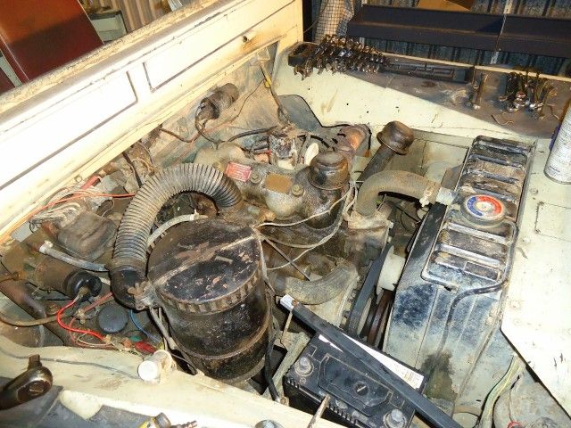

So the strip down has begun. Took all of an hour to strip doors, roof etc off:
The monster power plant. Love the oil bath aircleaner!

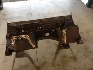

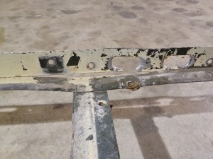

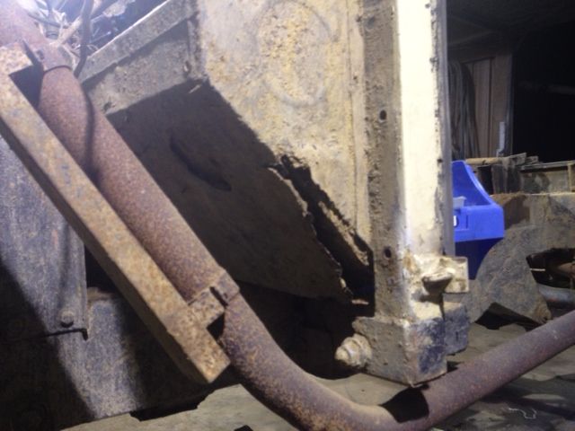

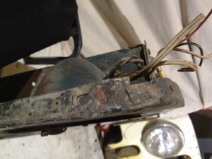

Now that's out of the way, the fire wall can come off, and the front panel with radiator can come off.
The fire wall looks good from a distance:
but is not......
neither is the fuel tank support:
Nothing a grinder, some plate and a welder can't fix :D :D :D

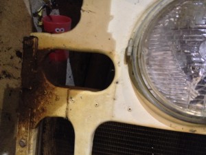

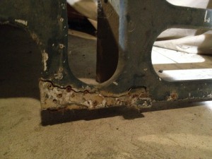

To fill in the gap in the thread, the fire wall was worse than we thought, so that came off too, then the engine and gearbox came out, and basically its sat as a semi rolling chassis for quite a while.
The old engine and gear box, fire wall and other parts are lurking in various corners of the work shop :lol: :lol:
We sent the front guards to a retired panel beater who tinkers with stuff from home for fun, and he fixed those up for us. They are perfectly straight. In fact he's set the bar pretty bloody high for the rest of the body work :oops: :oops: :oops:

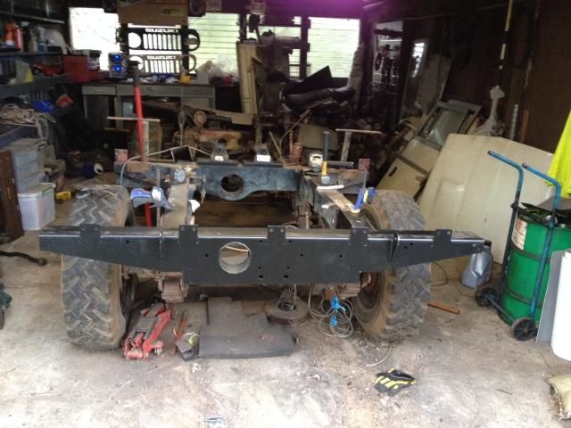

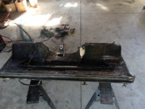

Over the years Dad had collected bits and pieces to do the chassis repairs.Trouble was the replacement bits were pretty tired them selves. Especially the replacement rear cross member. Luckily Rex at www.landroverspares.co.nz had a Series 2 Rear Cross member sitting on the shelf ready to go, so grabbed that and came up with a plan to make it work.
This is the result, one farked rusty patched up cross member mercilessly hacked off and discarded :twisted: :twisted:
Then it was time to clean up the chassis and make it suitable to receive the new cross member:
In order to get it to this stage, this the rusty rotten crap that had to be removed. A lot of it was old patches that had been welded on, hiding a lot of good chassis underneath them. Spring perches also got cut off and chucked in the scrap:
It was a mission as I was trying to preserve as much of the original chassis as possible so I had something to weld the new cross member to. This is the pile of grinding and cuttings discs at the end :lol: :lol:
The first test fit:
The new spring perches:
A fair bit of welding later and its on. That puppy ain't going nowhere, which is especially important as the spring perches are hanging purely off the welded on cross member :D :D :D

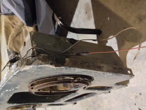

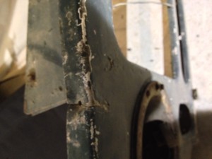

Next up was this disaster. Meet one messed up gearbox crossmember. Apparently it happened coming down a hill in Maramarua forest. Judging by the damage, i would say it's the kinda hit you would remember :shock: :shock:
I made myself some space to work on it because i suck at welding upside down:
Dad had salvaged this piece of cross member from one of his mates that was doing an engine conversion way back in the day, so at least I had some thing to work with. Problem was it had been cut between the chassis rails so was way to short to be used as a direct replacement.
So i hacked the damaged piece of the chassis:
Cut a replacement piece out of the otger cross member:
A quick test fit:
Should do the trick, so blazed it in:
Following that, i hit the chassis with the wire brush and sprayed on a coat of Brunox Epoxy Rust Converter. Operation bling has begun 8) 8)

The Chassis rebuild is done. Finished. Completed. Happy :D :D
As I mentioned in a previous post, following the repairs, i wire brushed the entire chassis and sprayed on a coat of Brunox Epoxy Rust Convertor.
On Monday night, once the rust convertor had hardened, it got two coats of gloss black Acrathane, which is an industrial/marine grade two pack paint.
Tonight, once the Acrathane had set, I sprayed underbody sealer on all of the rust prone places, on the underside of all of entire chassis and on all those places dirt and crud collects and causes rot.
The end result: (the under body sealer is freshly applied, it changes colour to black as it sets :wink: :wink: )
All the rust prone places on the new cross member sealed up :D
The repaired fuel tank mount and repaired out rigger:
You wouldn't even know that the gearbox cross member had been touched!!!
So there you have it, ready to be relocated, and probably receive the engine and gearbox sometime soon :D :D

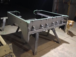

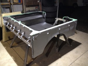

I'm missing having a cool toy to cruise round in, so obvious solution is to get this finished :D :D :D :D

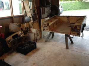

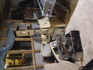

I went to the storage shed and collected some parts :lol: :lol:
Parts
Parts

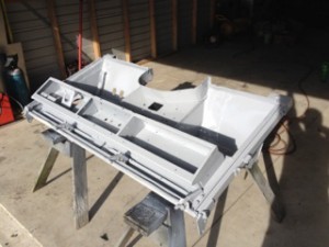

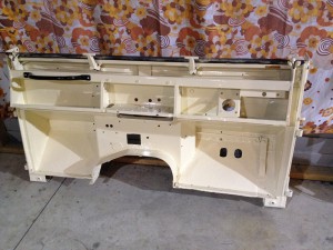

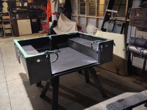

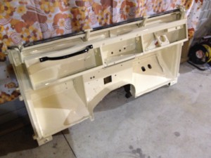

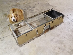

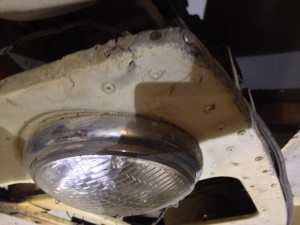

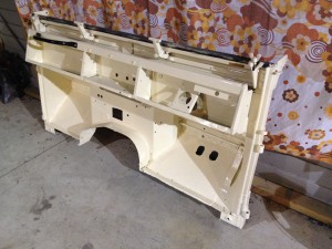

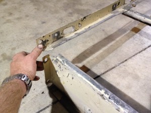

Mission number 1, finish repairing the fire wall. All patched, rust treated and ready for primer.
Firewall 1
Firewall 1
Firewall 2
Firewall 2

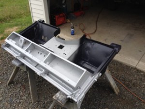

A good dose of 2K Epoxy primer to seal it up for a few more years:
Primer 1
Primer 1
On hard wearing areas where mud and dirt is going to accumulate and be hard to clean, and in the foot wells that get hammered I have sprayed on some underbody sealer. The whole thing will get sprayed over with the top coat colour.
Ready to paint 1
Ready to paint 1

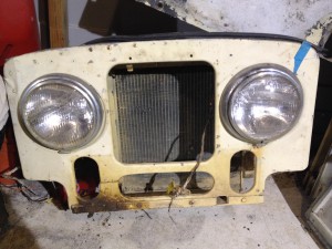

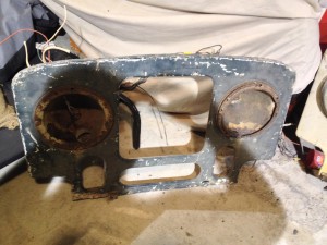

And as a real long shot, anyone come across a Series 1 wreck that has a good front panel?? The panel goes between the front guards, and the grill, head lights and radiator mount into it.
I have two, but both are damaged :lol:

This is the orginal front panel:
This is one potential substitute, but its probably just as bad, if not worse :lol: :lol: :lol:
Re: Rocky Rover 1955 Series 1
Posted: Sun Mar 22, 2015 9:02 pm
by DieselBoy
Its pretty bad :lol: :lol:
Gotta be a good one out there lurking under a tree or in a barn that hasn't been to hell and back beating around the bush on Club Trips for the majority of its life!!!!

by DieselBoy
A seat box of the same wreck if it exists would also be handy :lol: :lol: :lol:

by DieselBoy
On a more positive note, made good progress with the Tub.
Lots of hammer and dolly work, blocks of wood and leavers, a small amount of filler and heaps of high build primer and its starting to look less like a crumpled aluminium can. Slightly less at least :lol: :lol:
Hopefully this is the last coat of primer, and it just needs one last sand to be "good enough" for a 1955 L.R with a rough history :mrgreen: :mrgreen:
Still a bit wavy, but its so stretched and bent that its as good as I'm going to get it with out professional help :lol: :lol: :lol:
Posted: Sun Mar 22, 2015 9:30 pm
by DieselBoy
After the above ripply mess, just incase your now doubting how its all gonna look once its done, heres the first part finished and top coated 8) 8) 8)
The Colour is "Ivory". It's spent the majority of its life a similar colour, so its only fitting.
Sanding through the paint on the tub, it left the factory as they all did, in WWII left over green. Then its been a bright orange colour, then to grey, and then to its current colour in 1983.
I can picture the finished result with black flares and black wheels. I wonder if we can get the new soft top in black :lol: :lol: :lol: :lol:
Still, theres plenty to do before that happens :lol: :lol:
