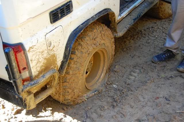

I remember this truck popping 10" beads all day, he even managed to pop both back ones at the same time on one track :x :lol:

sadam, similarly i was out with a chap that popped two of his 37 creepys off ten inch rims, both at the same time on the same side, under his shorty nissan.
