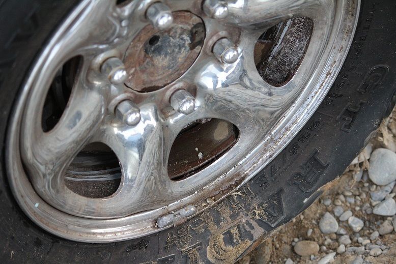

Turned around and came back out on to the gravel road, Heard a clunk then hiss hiss hiss hiss.
Great!! Another puncher! two in 4 days!!
Stopped and this is what I saw......
Turns out when the disk broke apart it sliced the tire valve clean off

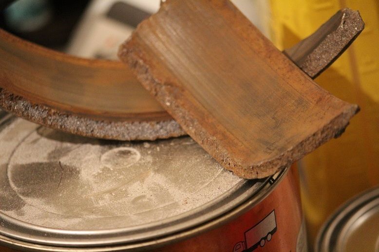

I took a closer look at the broken bits of disk...
I noticed that were it had broken it was nice clean shiny metal
Then I saw most of the break was rusted from being cracked for ages...

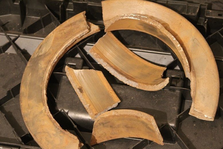

This is a comparison pic
Same disk two different breaks
Checked my left hand side and found cracks all the way though it.
