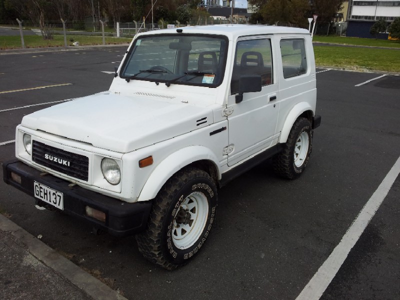

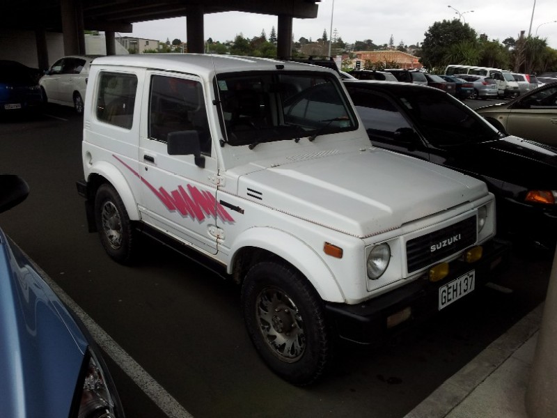

Hey guys, just wanted to show you all my new SJ70 and my thoughts so far..
So I picked it up from Tirau on the weekend for $2500 without a warrant, towed it back to Auckland on a transporter and drove it down to the local VTNZ - failed on a couple of exhaust leaks and a dodgy stop/tail light. Fixed the tail light with a bit of CRC and some scotchbrite and plugged the exhaust leaks on the roadside with a smear of exhaust putty and when that didn’t work hose clamps a strip of tin and car bog + an explanation to the testing guy that it was just a quick fix to get me back to Whangarei. PASS!!
It’s a 1990 SJ70 Samurai with the factory G13BA engine and absolutely no mods of any kind other than the fog lights and a kill switch. Pulled up all the carpets and found a small rust hole in the drivers foot well and some bubbled paint in the front corner of the bonnet, other than that it seems to be fairly rust free.
I do have a few questions for the Zuk experts out there and I realise that some of them are likely answered in previous posts - So I will continue to trawl through history, but I also realise that new members come along with new thoughts and expertise and it would be great to get your thoughts on certain issues as well. (wanted to get in before I got :twisted: as seems to be a regular response whenever someone new asks a question that sounds like it would have been answered before…??)
In return for your help, I would like to think that in time I may be of assistance - my background is in mechanical engineering, I am a certified fitter and turner, and currently work for New Zealand's only Oil Refinery looking after their rotating equipment - Pumps, compressors, blowers, fans and steam turbines of various sizes and makes - diagnosing faults and making repairs. Hence it is in my nature to want pull things apart and make improvements.

Starting to look a bit more useful thanks to the wifes hair dryer/pink sticker remover and a set of Cooper SST's (235/75/15) ex. Zukmeister.
Tyres are the perfect size for the standard suspension - haven't been able to find any rubs yet.
Picking up a new timing belt/water pump etc from partmaster tomorrow and then I just need to get my gearbox sorted and it sould be good to go for a run somewhere.

Looks much better 8) Especially without those gay pink stickers :lol:

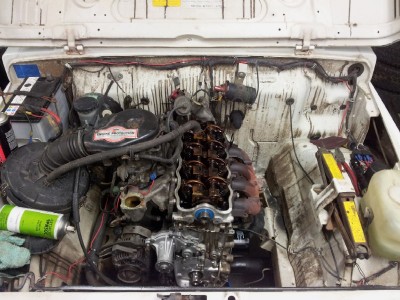

The Samurai/G13 just became my favorite vehicle/engine to work on! Last night I replaced the cam-belt, water-pump, tensioner, oil filter, front crank seal, cam seal and thermostat + gaskets etc. First surprise was getting the whole lot for $137incl from the local. Second surprise was how accessible everything is! Whoever came up with the idea to glue a rubber bung to the roof and have the bonnet fold right back was brilliant!!
Couple areas of concern though: I don’t have a manual yet and couldn't find any useful information on tappet clearance so set them cold at 0.13 for intake and 0.16 for exhaust. Seems to be going ok. They were all sitting up around 0.3-0.4 before I started so that explains the racket it was making.
Secondly - I pulled the hose off the carby that goes to the vacuum advance diaphragm on the distributor, If I can suck on that hose and the diaphragm doesn't do anything and I can actually draw air through it quite easily I’m guessing the diaphragm is stuffed and probably the reason for the momentary flat spot under acceleration?

pruggerdore
Posts: 610
Location: hawkes bay
Re: check out my new Samurai Project
Post by pruggerdore »
yep thats the test and what I meant. find out wat those tappets should be. too tight could make a catastrophe .

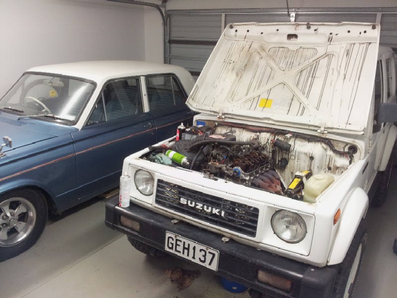

BlakeJ
Posts: 431
Location: CHCH / Wanganui
Post by BlakeJ »
your garage looks way to clean
Swamped
Posts: 1264
Location: North Island
Post by Swamped »
You don't want em too tight or it could drop a valve.

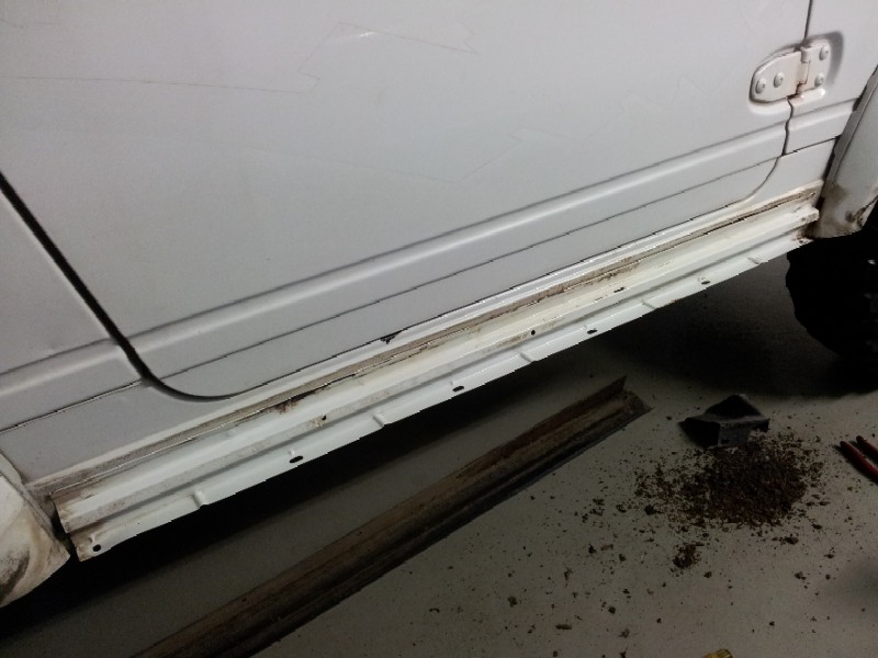

Well I pulled off those plactic rust trap things Suzuki attached to the side of the Samurai the other night expecting the worst...As you can see by the pic, initially I was pleasently suprised! After I dug a mountain of dirt out from all the way up in the flares it all looked pretty good. Then I noticed a small rust bubble half way along the ribbed bit and poked it with my screwdriver...which went straight through... :?
Seems like the body underneath is still solid. I haven't had a good search on the forums yet for what you guys do about getting rid of the plastic trim but guessing it is a good idea to get the cut off disk out and remove that ribbed section of panel steel? looks like the perfect spot for hidden rust.
Thinking at the moment I'll get rid of the ribbed bit and get some heavier steel bent up and attach that - might offer some protection against rogue rocks and logs.
