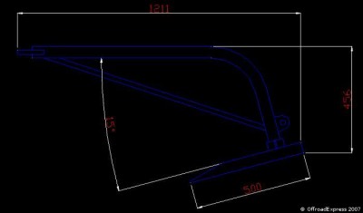

Been thinking about making one of these,anyone able to tell me what the best angle is for the spade?
Big
Posts: 2134
Location: central Otago
Re: Land Anchors? Ground Anchors?
Post by Big »
There is a lot of thought to put into making one.. the angles are very critical + the length's from spade to hook.. Even the size of spade has a huge impact on how it works.. bigger in this case is not always best.. I've got a hughes copy when I repair it I can measure it so you can get it right..? mine is twisted from the antics of not having a rear rope to pull it out.. :lol: and I just keep re setting the bloody thing in the end had to dig it out.. :shock: but by then it was bent and didnt set right after that.. :lol:

This came from some one on here hope they don't mind :roll:

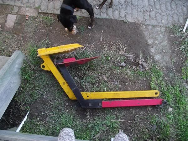

both of mine are down at towbars workshop and I wont get them back till after Taz has done Manakau at the end of the month then I can give them a measure up to compare lengths and angles with others, both of mine were built by different people but the angle between the spade and the main arm seems to be identical between them. I used the red one at the costa teams event in 2010 with beercruiser and the yellow one at this years event and they both seemed to bite into the ground no probs :D , the guys that borrowed the red one last month broke the spade off but thats a we mod that was done to it thats gone back to be fixed under waranty.... aye Taz Image

Ha took a while but I got there ion the end.. :lol:
Here is my anchor.. had to repair it today so took some measurements .. Not sure if its totally accurate as it was bent in a lot of places..
If you need anything more just hola :wink: :mrgreen:
L-andy
Posts: 104
Joined: Wed Dec 23, 2009 9:13 pm
Location: Jiggelton near Shake-lurch
Post by L-andy »
Using Saddam's pic
The angles between components are slightly different but the angle between blade and main "spine" are 8 degrees on both.
