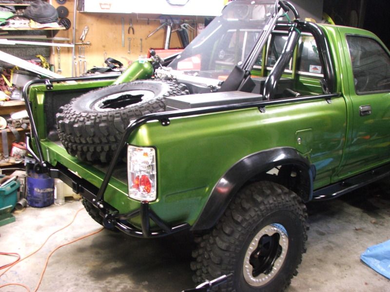

I use a polycarbonate panel over the roof with my rear mount and it runs fine on the road.
I've never tried it on road without it but i do sometimes remove it for offroading as it tends to get covered in mud and restricts rearward vision ( allways nice to know if you're about to back into a tree :D )

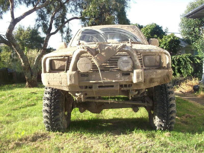

Nice truck, got some pics of the front end.
LOLYF
Posts: 712
Location: west auckland
Re: Rear radiator mouting
Post by LOLYF »
pruggerdore wrote:Nice truck, got some pics of the front end.
The front end :oops:

Just build a shroud for the fans so they are sucking all the air they can through the core, rather than just moving it around willy nilly, mine had no issues getting warm at all, whether it was banging on the limiter all day or cruising. The lack of airflow from the movement of the vehicle makes no difference whatsoever, the fans do the job no worries. You cant see it in this shot, but the front of my radiator is about 50mm from the back of the cab...
oh here ya go
