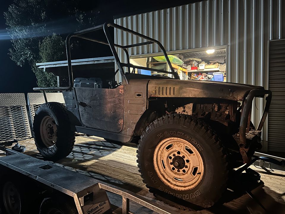

So project "Rangi" was born
So word went out on the Local LJ network and a suitable LJ50 was acquired .

The Plan as it stands .
LJ50 Chassis / Tub (whats left of it) / Roll cage
LJ80 Diffs (spring perches moved to LJ50 Spacing)
SJ410 Transfer Case ( with aftermarket reduction gear set)
Suzuki F10a 970cc Engine and LJ80 4 speed gearbox.
Rear Mounted Radiator
Front and Rear disc breaks
Rear Lockright auto locker
9000lb winch (rear mounted)
7.50x16 SAT (32x7.5x16) mud tyres on modified factory 16" rims
I all ready have most of the parts , so hopefully this will progress quickly
the Bottom of the tub has the standard dipped in acid dissolving coke can action going on , has been "Rangi" repaired by pop rivitting some sheet metal in where the floors were and the rear has been chopped off .

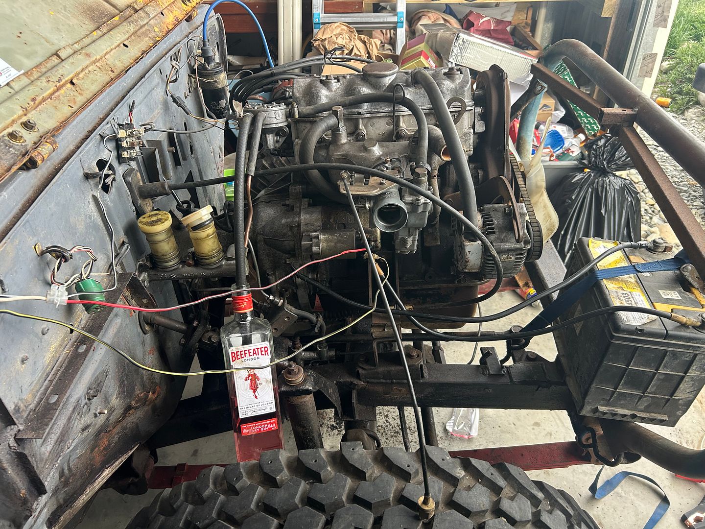

Some of the more interesting features
The Origional LJ50 3cyl 2 stroke and gearbox, that is going to DB as spares .
Awesome super advanced ultra air cooled , fiddle break plumbing - these will be removed
The Plumber Snorkel
Rear Tray Removed
Engine Stripped out

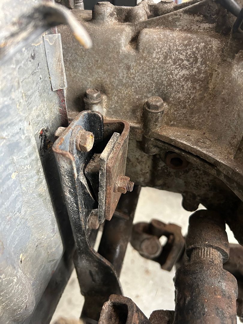

LJ80 Axle and engine mount Donner. - Chassis has major rust issues
