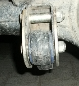

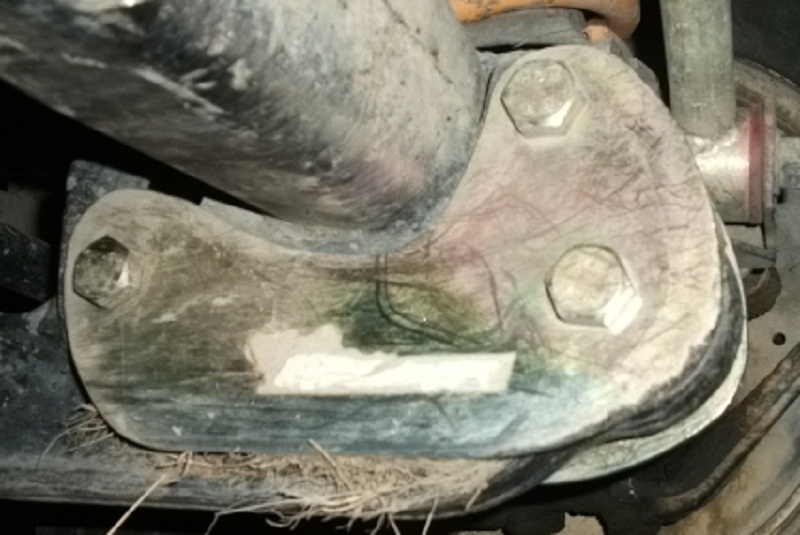

not sure of the disco set up? but my vx i got ironman caster correction plates easy to fit too... 8) 8)for a 100mm lift

disco one some i tink most have have cast front arms and steal tube rear
castor correction plates look simple enough
and ya wouldnt loose any articulation like castor correction bushes
i might have to look that up

had a look and the two castor points are a fair way apart but im gonna have a pay and might try knock some up at home and see what they do
