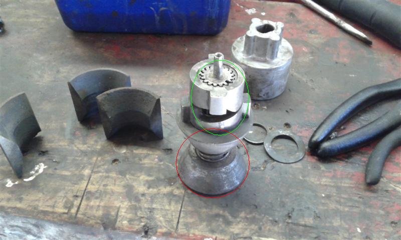

Need some advice...
Below is a picture of the brake mechanism in my winch. When I pulled it out, it was all coated in old grease. Around the brake shoes it had burnt the grease so would probably explain the binding on free-spool.
Anyway, I would like to keep the brake shoe area (circled in red) dry, but apply some sort of lube to the brake mechanism (circled in green) to stop rust and keep it sliding smoothly.
After a bit of research, I think I have found the product:
Bendix Ceramic High Performance Synthetic Lubricant
http://www.bendix.com.au/content/high_p ... _lubricant
Insoluble, waterproof and chemical resistant
lubricant that will remain in place and protect braking system parts at extreme temperature from -50ºC to more than +1650ºC

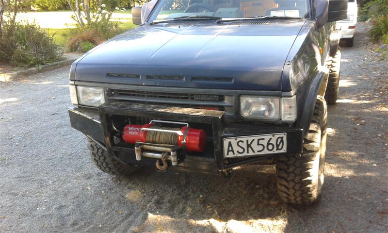

Well new bars in and winch mounted now...... Thanks Taz
Have just been testing out the winch, but something is not right. She might be able to pull about a quarter of its capacity, but certainly not my light truck up an incline. The winch stalls and then when winding it in under no load, the motor is smoking.
It must be shorting out around the brushes or internal wires somewhere. It did have a good look at it when I stripped it down and used a meter to measure any shorts. Would have been good to have used a megohm on it.
Ahhhh, bloody thing...
At least something is filling that hole now. And it free spools so nice an easy now.
