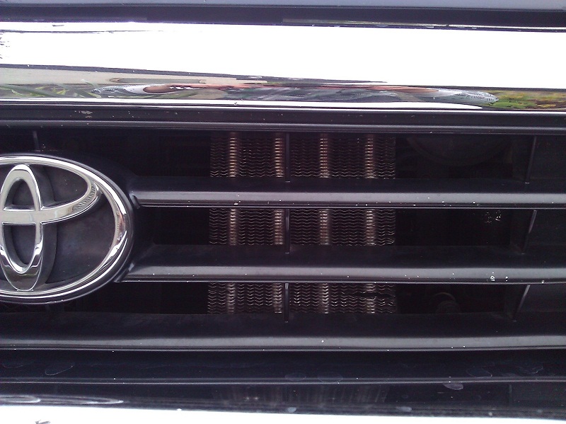

Got my 12" oil cooler in today, in series before standard cooler, and the bloody a/t oil temp light still coming on just with normal road and motorway driving. Will sometimes go out for a bit then come back on, seems semi random. Engine temp has def dropped about 5'C since cooler install today. I am unsure if the a/t oil temp light is coming on because the oil is overheating.. Are there any other reasons this light may come on? Trans oil is still nice and red, smells good, and has been topped up to full. I don't understand how it'd still be running hot. It also never used to come on, only started happening a little while ago.. Any ideas?

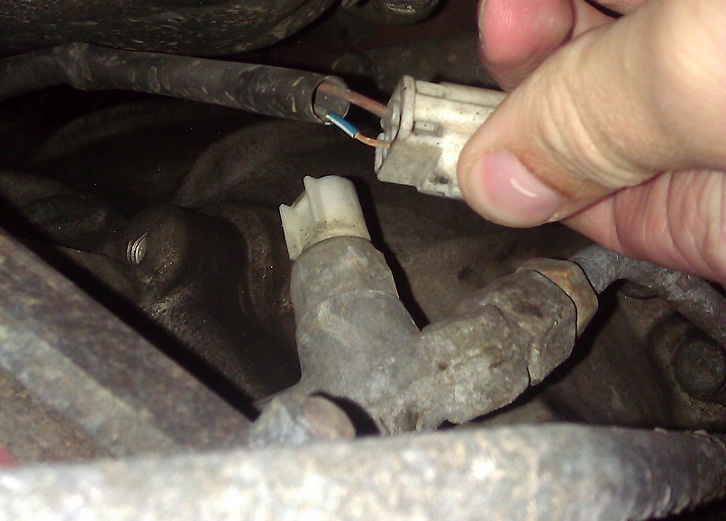

Yea I was thinking the same about the sensor, so, where abouts is the sensor for the trans oil temp? And is the chaffing (if that is what it is) likely to be around the box or could it be anywhere even up in behind the dash (please tell me no lol). Also, how do I test the sensor? If it is cheap enough I will just buy a new one and replace it to tick that off the list of possible faults/reasons.
Re: Hilux Surf 1KZ-TE Auto Trans Oil Cooler
Sensor is here...
As for the wiring, follow it back. Chaff more likely to be under the truck.
P/N is 89429‑34010 and used in many different vehicles.
http://www.toyodiy.com/parts/xref?s=894 ... J=on&mG=on

Could this be the issue? This is the correct plug, right? I tugged quite hard on the exposed wire and it didn't budge so it's not like it's falling out - **** knows how it got like that still being in there damn tight. Also tried pushing it back in but it won't budge. Where it's positioned it's not like that exposed wire can touch anything to arch out so could it be that the wire has come out just enough to sometimes have contact and sometimes not? If it didn't (i.e. like the plug being un-plugged) does/would that cause the A/T OIL TEMP light to come ON?
Next step, how do I test the actual temp sensor? And is removing it just a case of just undoing the nut below the plug and taking it out?
EDIT: Just left it un-plugged, started it up for a little bit and no A/T OIL TEMP light, so now I'm thinking that (if this plug is the cause) it actually is overheating and then the wire loses contact which cuts the light out? I also have no idea how to fix that plug from under the truck, anyone have any ideas?
You dont need to swap the radiator.
Ive fitted plenty of coolers to all sorts of vehicle from Jappas to hot rods.
Fit the cooler SEPARATE from the radiator or nothing is really gained.
Two hot things dont make a cool thing.
Clean out the rad cooler (brakeclean blasted through, then water if you want) then simply fit a hose from one end to the other- 'bridge it out'.
If the in rad cooler cracks the coolant flows in the hose round and round, no worries.
The other reason for bypassing the rad is that if the in rad cooler cracks you get ATF in the engine when running (ATF pressure higher than coolant pressure) then they happliy swap over when you turn her off - nil trans pressure but residual coolant pressure.
I have seen some sad faces explaining this to customers with cooked motor/trans.
If you want pull the rad to make sure all the oil is drained.
While you are there, getting it checked and rodded out is a good idea too.
New thermostats are cheap insurance.
Thats my opinion anyway, all this new rad talk seemed odd unless Im missing some fundamental 4WD thing?

To bypass the in-radiator cooler altogether how big does the external cooler have to be? Mine was supposed to be 12" x 6" by 3/4" (the actual cooler, I thought), but it turns out that is the overall size, so cooler is 9.5" x 6" x 3/4", too small? And do you need a fan on them too?
ive got a 41mm thick manual alloy radiator and the truck still went up in temp going up the porters pass so wouldnt bother with a new radiator unless water temp goes up under just normal driving, i think its more to do with high egts for long periods going up the hill
i brought a trans coller from b n t thats only about 10 mil thick and about that size and at light hasnt come on so mite be alright, i out put mine behind the grill so wil get plenty of air
i went into a radiator shop and they showd me one off a 20 tonne truck and is only about 12 ' by 6' by 1 1/4'
That size while not massive will still shed a fair bit of heat.
My old boss had room issues on a 32 Ford coupe so just made a loop of tubing under the chassis with no cooler. Seemed to work ok!
Never used a fan. The rad fan draws air through the area anyway. Just make sure you use some sort of soft spacer between the rad and cooler to prevent rubbing and eventual tears at the roadside. Some kits come with foam spacers and a mounting kit. Mount the cooler in front of the rad.
I like them up high too, our of the way but having said that they are usually tough enough. Off roading obviously is another danger but I figure people here think about damage when they fit stuff.
Try the current one and if you trust the gauge then keep an eye out, should be ok.
By the by, if a trans poos itself get a new cooler as the cooler is usually now a swarf container. Seen that happen too, people spend $$$$ on a reco trans, fit it at home only to have it quickly die due to not cleaning or replacing a cooler. I go with new as they are fiddly bugger to clean and how can you be sure they are clean?
I helped a mate fit a new diff head to a Cortina once. It had some oil left in the housing and as a check I put my hand in it. Came out with enough teeth to make half a crown wheel, that would have been good in the new diff eh?
CHECK CLEAN CHECK CLEAN.....

Yea mine is mounted in front of radiator and air-con, on the right hand side (looking from the front) up the top, as the whole left side is taken up by another fan - I'm guessing the air-con one?
So you really think my cooler will be ok to run on its own? Not just for on-road driving but off-road too? I assume my truck trans would get a lot more of a thrashing off-road than a hotrod trans on the road?

Will hopefully be getting the SPD terminal tested on ECU today. But also wanting to suss out whether or not I can run this (to me) small trans cooler I have on its own without the stupid in-rad one.

EDIT: Trans cooler is rated to 12,000lbs, just measured it and the cooler part itself measures 8 3/4" x 5" x 3/4" and is mounted as per the image below (so it gets quite a bit of air):

And so you guys reckon running my small 9" (12" overall size) external cooler will be fine on its own without using the in-rad cooler at all? For on and off-road?
Have also tested SP2 ecu terminal whilst spinning front wheel and get either a constant 0.002 or 0.003v reading, unsure if I am doing something wrong or this is where the problem lies (between the speedo cluster and ecu) - I hate this auto-elec stuff
