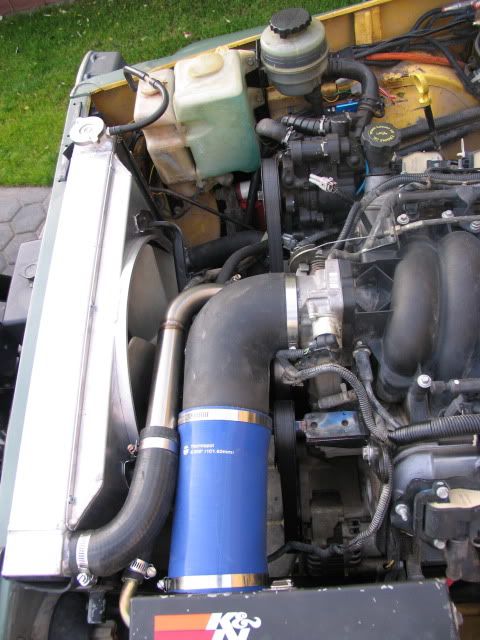

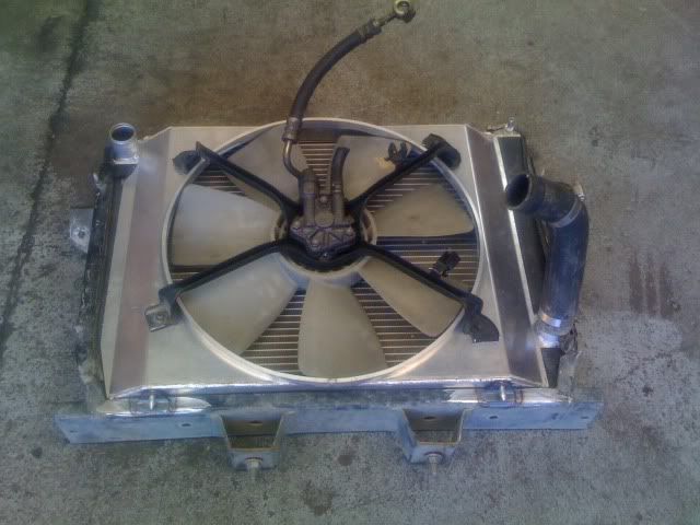

Sadam_Husain wrote:Image
Wouldn't have thought the fan would do anything that far from the radiator? :?

I suggest going as big as possible.
I used to have cooling issues with the LS1 in my old FJ40 till I had the biggest alloy tripple core installed. A good fan shroud is a must. Don't get the fan too close to the radiator either. That can cause air cavitation.
Good luck!

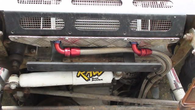

The last thing I did to get even extra cooling to the motor was installing a sandwich block between the engine and oil filter, run oil lines up the front and mount a small radiator to cool the engine oil. :wink:
A bit extreme. But it was an extreme FJ40. 8)
Sandwich block behind oil filter bash plate.
Oil radiator mount position.
Bash plate for hose fittings.
Unbolted easy for cleaning.
