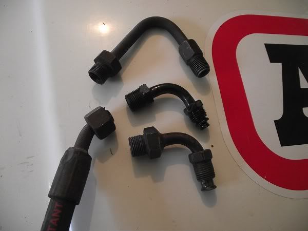

This is what the pipe looks like
Re: 03 Grand Cherokee - Power steering pressure hose leak
Posted: Sun Nov 11, 2012 1:31 am
by gimmemud
I got a mobile pirtek guy to do a couple of hoses for me, would easily make that up. He made up a hose similar to the top half of yours with four fittings a bit of flex hose and bent up a piece of solid for 100 cash. Thought it was very reasonable.
