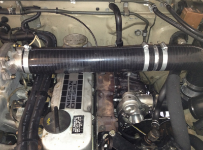

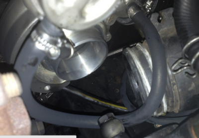

Just finished fitting up a custom TD04HL-15T to my TD27T.
I am wondering, those of you that have fitted an aftermarket turbo, what did you use for intake piping from the airbox into the turbo?
It is very tight to fit a silicone bend - I thought that you guys might have used something from another car that has a recess for the alternator banjo...?
Pics attached.

No, he's talking about the intake on the turbo...there is nearly no room forward to the alternator, that's why the stockers have that crappy little cast 90 deg fitting on them. You certainly can't use exhaust bends...
I think you'll just have to squeeze a silicon 90 in there...

you can buy 180 degree bends on ebay out of silicone. they work well.

Yeh looks that way. I will get a 2.25" to 2.5" reducer bend and trim it right back. What size is the factory piping from airbox to turbo - 2.5"? I will ebay the bends tomorrow.

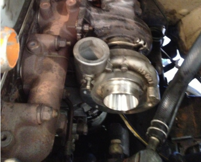

The TD04 bolts straight up to the stock manifold (T25 flange), you use the existing oil drain pipe (HT12 and TD04 are identical) and the existing water lines. You only have to modify the water line from the thermostat to use a different fitting (block side). I am going to have a 3" dump made into 2.5" with a muffler out the back.
This is how much room I have to play with for the turbo intake piping...I will be using a 2.25" 90 degree silicone bend:

Thats the bend I was talking about. you buy them off ebay. I was going to use on my setup.

Ordered one of these:
http://cgi.ebay.com.au/ws/eBayISAPI.dll ... 500wt_1156
Cross Country 4x4 so it should be a reasonable quality silicone bend.
Stoked I can retain the standard intake piping and airbox.

Used a 2" piece of 2.25" aluminium tube to to join the silicone to the factory intake piping.
