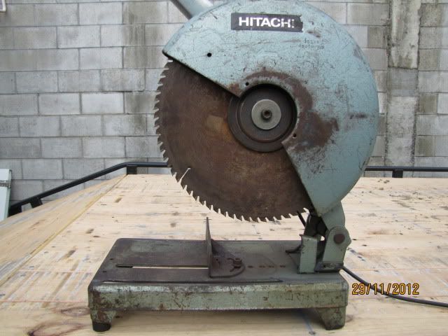

i have a hitachi dropsaw ,the blade you use is a irwin 355mm 80 teeth (correct size )
max rpm is 3200 drop saw runs at 3700
but be warned its a bit like my staffy it will take that piece of wood out of your hand :lol:
bloody dangerious really i would go only for 10" blade next time :mrgreen:

Big-AL
Posts: 549
Re: metal drop saw
Post by Big-AL »
yeah that looks the same as my drop saw.

Is the blade on this saw the right way around?
No wonder it grabs your wood :)

JeepFanatixs wrote:Is the blade on this saw the right way around?
DA RAM wrote:i have a hitachi dropsaw ,the blade you use is a irwin 355mm 80 teeth (correct size )
definatly is ! if it was the other way around it would not cut anything :lol:

JeepFanatixs
Posts: 10
Joined: Sat Dec 01, 2012 4:39 pm
Re: metal drop saw
Post by JeepFanatixs »
Thats correct!
But it will also solve the grabbing issue :) :)
