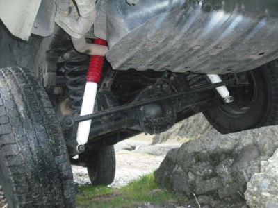

I'm looking for a a 4.88 ratio ring & pinion for the C200 differential, as fitted to the rear of 1987-1990 NON turbo diesel & 4-cyl petrol Terrano/Navara 4x4 (transaxle code CA48).
It's the Salisbury style differential, also used in the front of the MK patrol. Attached is a photo for identification.
