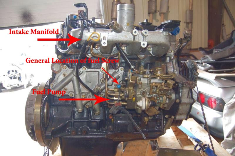

have trouble finding this fuel screw you say looking at engine from above its like a mushroom and the fuel ajustment screw is under that is this on the R OR L side of the engine

philip121 wrote:have trouble finding this fuel screw you say looking at engine from above its like a mushroom and the fuel ajustment screw is under that is this on the R OR L side of the engine
http://www.offroadexpress.co.nz/Forums/ ... 25&t=30636
There is some info there, to show which is the fuel screw
This picture should show you where the pump is
A few websites that have some info on what you can do to the fuel pump
http://306oc.co.uk/forum/thread-145.html
http://www.306oc.co.uk/forum/thread-131 ... #pid170162
http://www.fourwd.org.uk/bosch_ve.html
The two 306 pages have excellent excellent info regarding the bosch pump modification, i find it to be of superb knowledge
And lastly a link to the manual for the bosch pump itself, have a read
http://www.kiwicylinderheads.com/Portal ... -Pumps.pdf
These should put you in track i hope, and if u have more questions, fire away, i am sure there are heaps more experienced people here who can help
Peace
Arvin

I couldnt have put it better myself arvin :mrgreen:
The screw in question may have an anti-tamper cover on it, a flat head screwdriver will fix that :lol:

Ummm...that isn't a good way to tune a boost compensated pump....
The anerpid fuel pin is where you should be tuning from....

on the picture Where is it what is best done with it

Aneroid fuel pin is under the mushroom bit, if u open that bit, there will b a lil spring loaded diaphragm that i think u wind in further to get more fuel, i thnk thts wt keepwalkn is saying, though i dont know why that is the prefered method of tuning the pump
