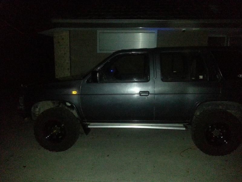

Heres my first WD21 in ChCh about 5 years ago before I knew anything about independent suspension. Factory rear springs, torsions maxed out, I didn't even realise but the bumpstops had already been spat out. See how its sitting too high.
So mechanically a complete mess, but I learnt a lot of things.
