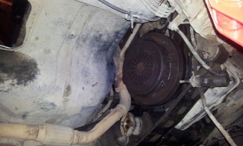

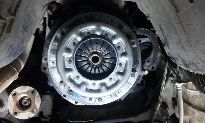

Finally got motivated enough to take the gearbox out of the terrano, was a lot easier than i thought it would be.
Will replace the clutch as well while ive got the box out, anything else i should be looking at replacing while im at it?

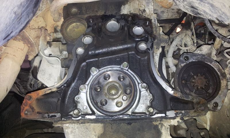

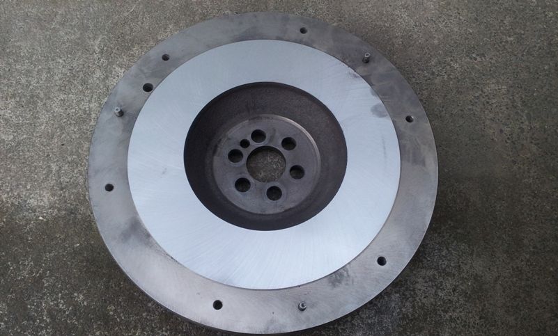

While you've got flywheel off being faced for new clutch, replace the rear main seal
Re: Newbie with a terrano
Yes good call, will do that while im there

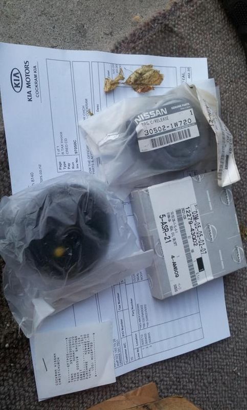

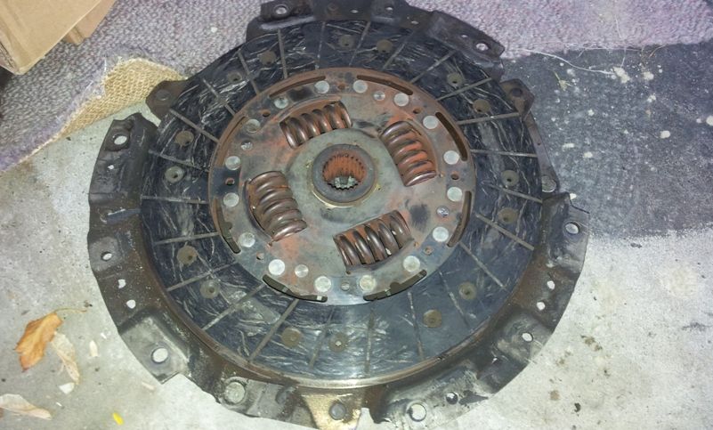

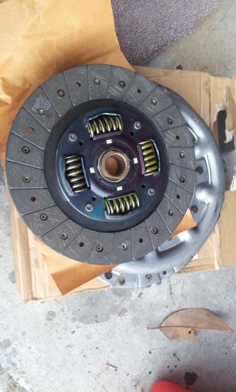

Ordered some bits for the terrano the other day, and they arrived today, new clutch, release bearing, rear main and gear lever boot.
Removed old clutch, wasnt too bad but worth doing while the box was out
Got the fly wheel machined
New clutch
ANNnnd all back togeather, now just waiting on gearbox to arrive and put
New clutch

Quick question, does it have a spigot bearing for the gearbox input shaft to locate into?
If it does, make sure its also replaced.
They have a brass bush in back of crank, rather than a bearing. Worth checking as sometimes they get flogged out. With gearbox out its the perfect time to access EGR crossover pipe to remove and blank off. Put a EGT probe in exhaust blank while you there
Yeah i had a look at the bush it seemed fine, was going to replace it but than forgot
hopefully it will be sweet, murphys law though it will shit its self if i dont replace it
