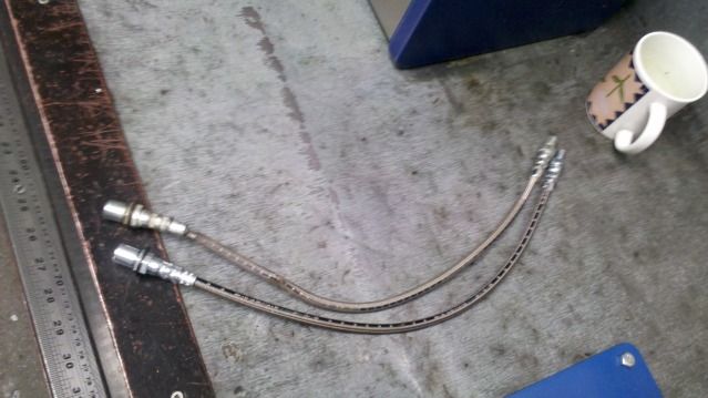

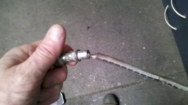

Ive got some braid lines made up to suit my body/suspension lift. Damn glad I did, as I got hooked up a month or so ago and this happen to my rear braid line.......
And it still worked!! Which kinda shocked both me and the guy who made the lines.
New vs stuffed
If it was a standard extend rubber type hose, it would have split/broke and I would have lost the rear brakes.
Yes I know they arent legal on roading going vehicles, but I'd have braid line anyday IMHO they are so much more safer than the rubber ones..... Even old Monty has braid lines!! and he still got WOF's
New vs stuffed
