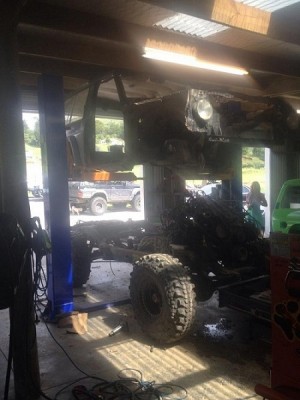

So i have had a new body that i picked up for 100 buks as my black truck is fecked even more so knowing i had another body , so went out wilsons the other week and fecked ever panel on it
Trying to drive through dense bush up rivers etc
all that fun stuff ,
I took some pics of the progress today but so far
we have spent over 50 hours insuring it is completely rust free,
Remove the body from the chassie stitched a new front end on it , remove all the body to floor/sill mounts , inner sills and all rust prone areas , repairs to near the fire walls where they all go , removed the roof (they all rust from the inside of the roof out ,

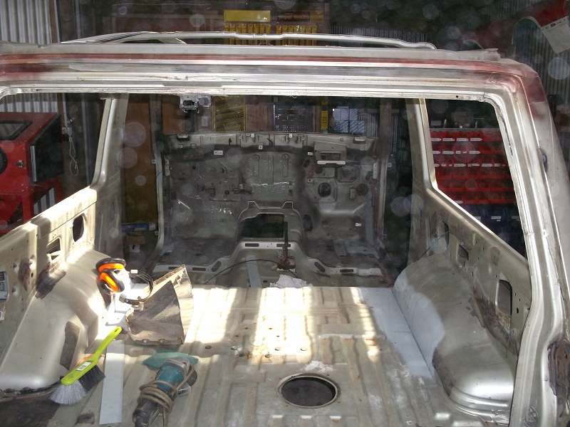

Finally this weeken i spent all day removing the sound proofing , and just started by marking and cutting the rear quarters ,
over the next few weeks i will bend up a 44mm half cage (Using my pro tools 105 bender ) , then filling any unneeded fire wall holes , then to sand blast and get my good mate steve from STEVEN SOLE CUSTOMS to paint it ,

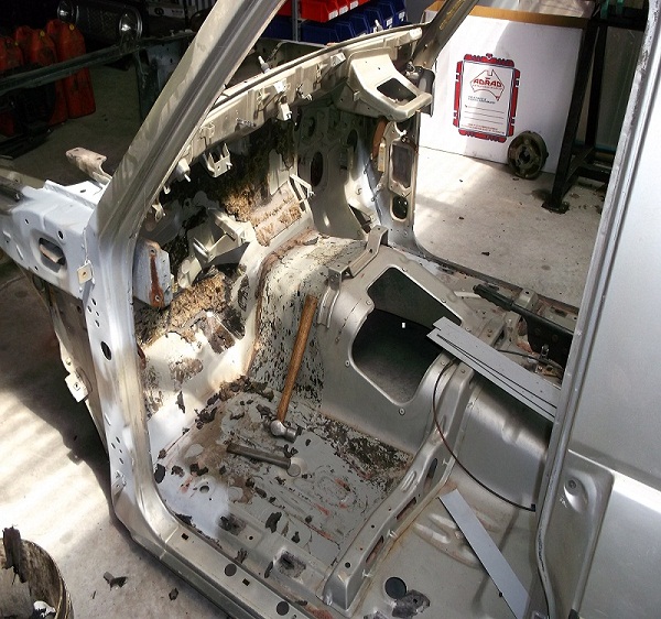

The begining of the sound chipping ,
(the driy ice shop is shut on sundays ,
Trundle
Posts: 617
Location: Taranaki
Re: Nissan safari , TRUNDLES LTD Promo truck
Post by Trundle »
Nek minit / half day

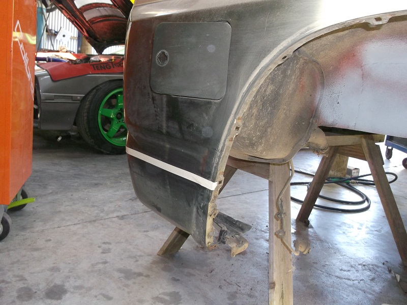

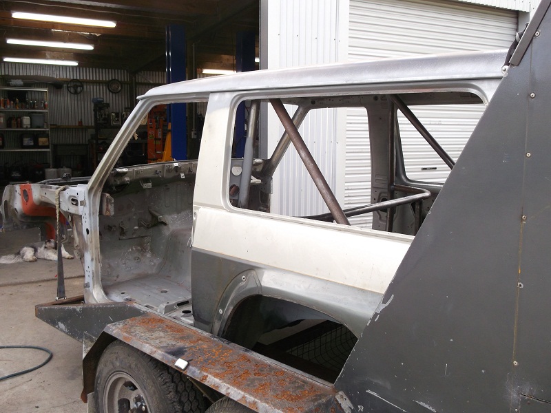

marking up the rear quarters

Post by Trundle »

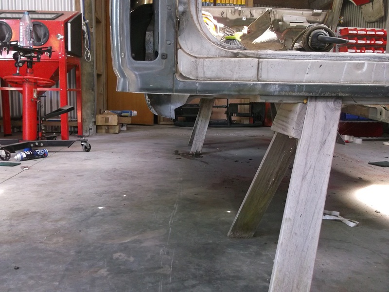

cutting off snip snip !!
I love how woth of my hoists are being used by mates and im groveling round under saw horses ,
Sigh ,

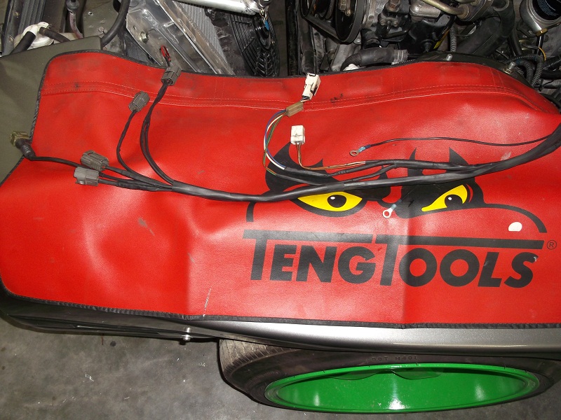

Mondays back so i had to get back to all of the customers cars , here is a microtec ecu loom i have almost completed for a 13bt rx7 race car ,
Much better than chipping on sound proofing in 34 degree heat ,

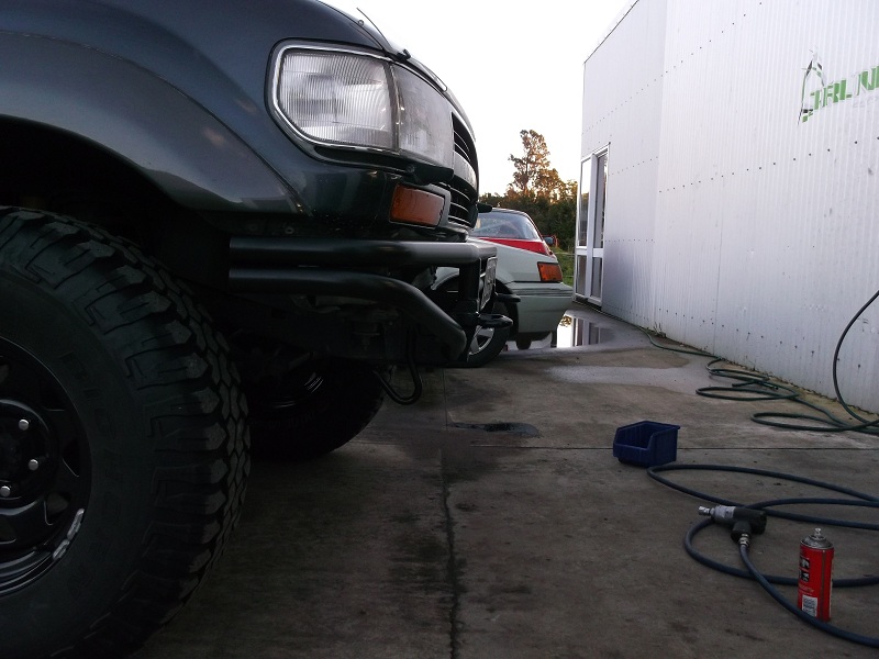

First is a 80series road truck tig welded and and powder coated ,

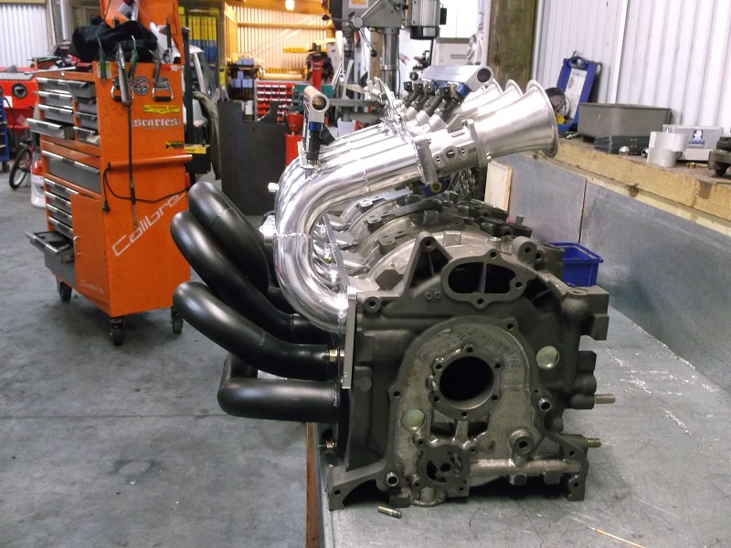

We make lots of manifolds , exhaust etc for those of you that need truck work in Taranaki we also stock a huge range of lift kits light bars winches etc , Heres some manifolds we made for my quad rotor pp engine

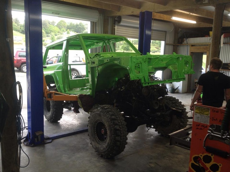

So it only took two trips and my mate rolled the number two truck so figured may as well fit the decent one !
Trundle
Posts: 617
Location: Taranaki
Post by Trundle »

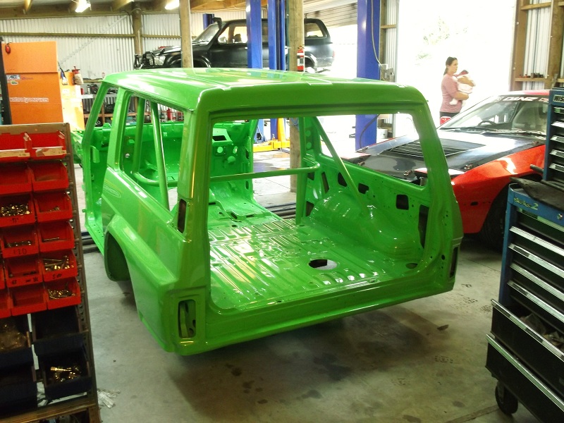

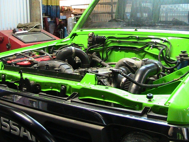

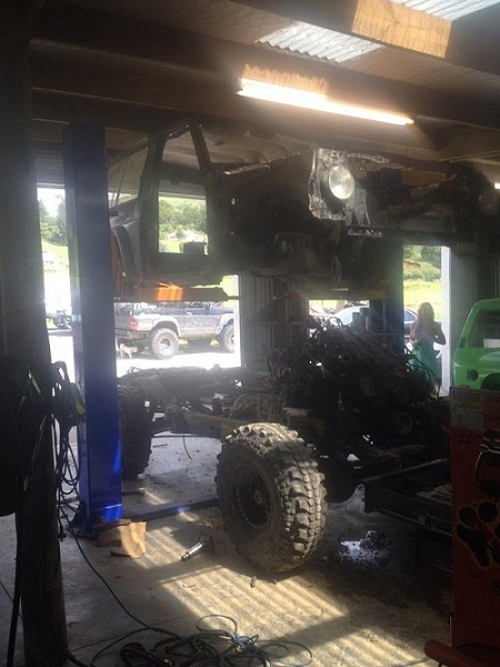

Reftting new body , Turbo is a holset rs , tial 44mm external , merge collected manifold , modded pump , 100x600x300 fmic , H/d clutch , billet hubs , 45mm big bore internal stopped tough dogs ,rs drag and tie rod links , bead locks , simexs , adjustable panhards , rtc damper ,

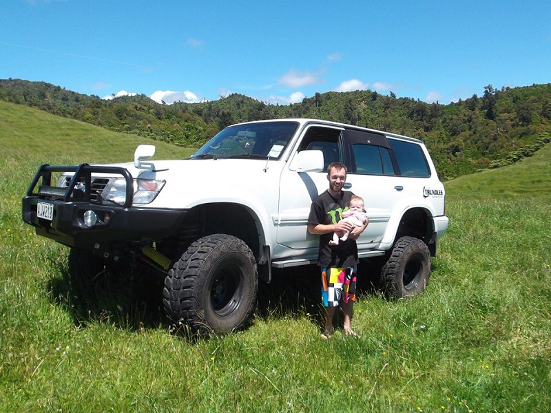

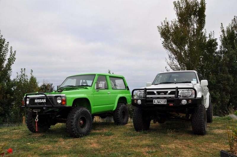

Did a few more mods on the white truck to fitting one of the bumpers and light bars that we stock and am training my daughter to offroad , (she is only 5 months not sure if she understands yet , ?)

Almost there , Just needs an exo cage , front braced diff and diff lock fitting and the rear lower extended arms and a few other minors ,
I have used parts from 15 different trucks so far to build it , Hopefully i can do more than two trips without rolling it this time , lol lol

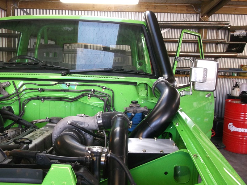

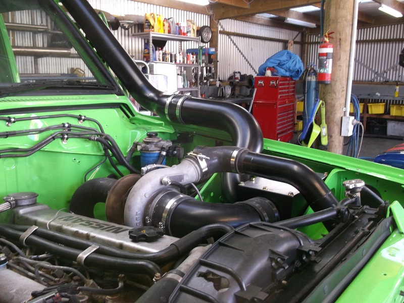

another pic bit averige quality but shows turbo , external w-gate , twin dry cells , FMIC

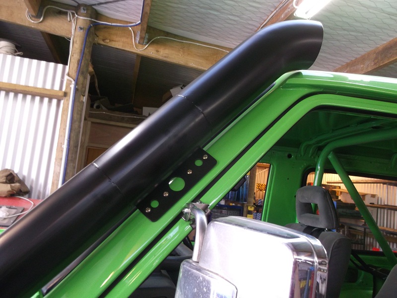

Just finished the snorkel off doom 4" i tig welded up all the box etc and ha the whole lot powdercoated ,
Truck also went through cert etc , Just need to do the inlet manifold , build a big pump and do the injectors , I also and going to fit one of our new genuine rocker shafts we stock and reface the rockers ,
Hoping to get above 200 + rwkw

Another pick of the box etc

Doesnt look that big but its 4"!!!

Trundle wrote:Just finished the snorkel off doom 4" i tig welded up all the box etc and ha the whole lot powdercoated ,
Do you have any trouble with rain water getting into the air box?
Our snorkel is similar and has a water drain part way along, but when racing in anything more than light rain we end up with a lot of water in the air box. We're still looking for a good solution.

5 psi more boost and call it water injection ???hahahah ,
I may have to get one of those rubber dongles our of factory airbox that looks like a duck beak maybe , Either that or some kind of stocking and a zip tie !!!

You can buy duckbills from any marine shop. Just fit one in the bottom of the air box. That's what I do.
